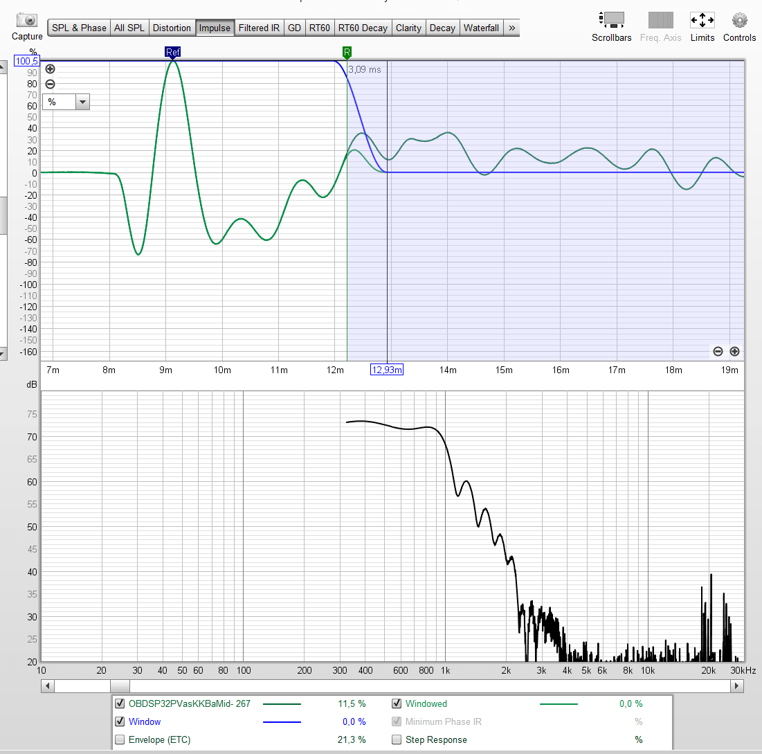

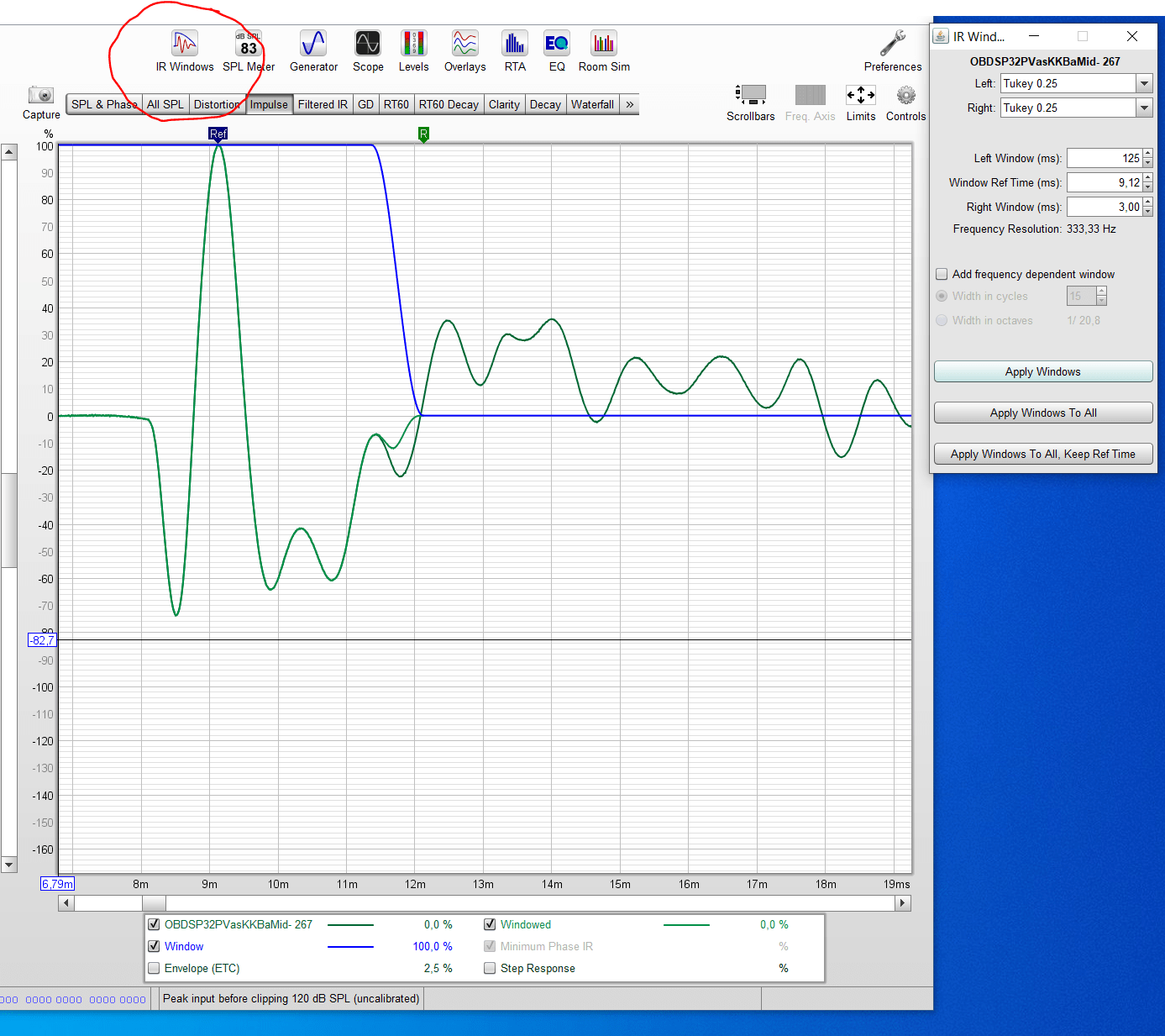

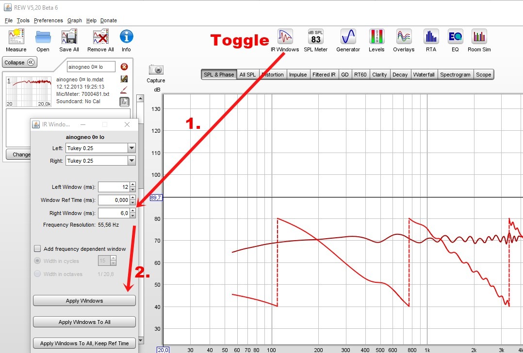

Works also for "All SPL" ie. for several measurements. This setting is not saved.I couldn’t find gating in REW. Not even in a help search. Gotta be there somewhere.

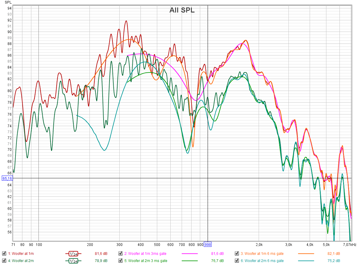

But I see the gated curve, you have 2 dips 250Hz and 750Hz, between you have stored energy (mass air resonance) which have a negative impact on the midrange, it's my observation, doing a CSD. I think you can minimize this effect with a crossover work and the help of the tweeter, low slope could help. You have the same problem on the Manzanita and the vifa mid helps a lot 🙂
Doh! I have probably used the Window adjustment, but couldn't remember where it was. Hiding in plain sight. 😀 Thank you.Works also for "All SPL" ie. for several measurements. This setting is not saved.

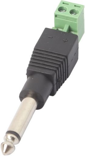

Another option of checking for panel resonances without driving your speakers from the amplifier, is to connect the terminals of the speaker to the input of the audio interface. I keep one of these around -
The 1/4” Jack goes into your audio interface, and the speaker terminals go to the screw terminals. So now your baffle mounted speaker work as a microphone; by the way of reciprocity-
it’s a microphone for your baffle- you tap/knock on your baffle at various points, and whilst watching the FFT using the RTA function in REW.

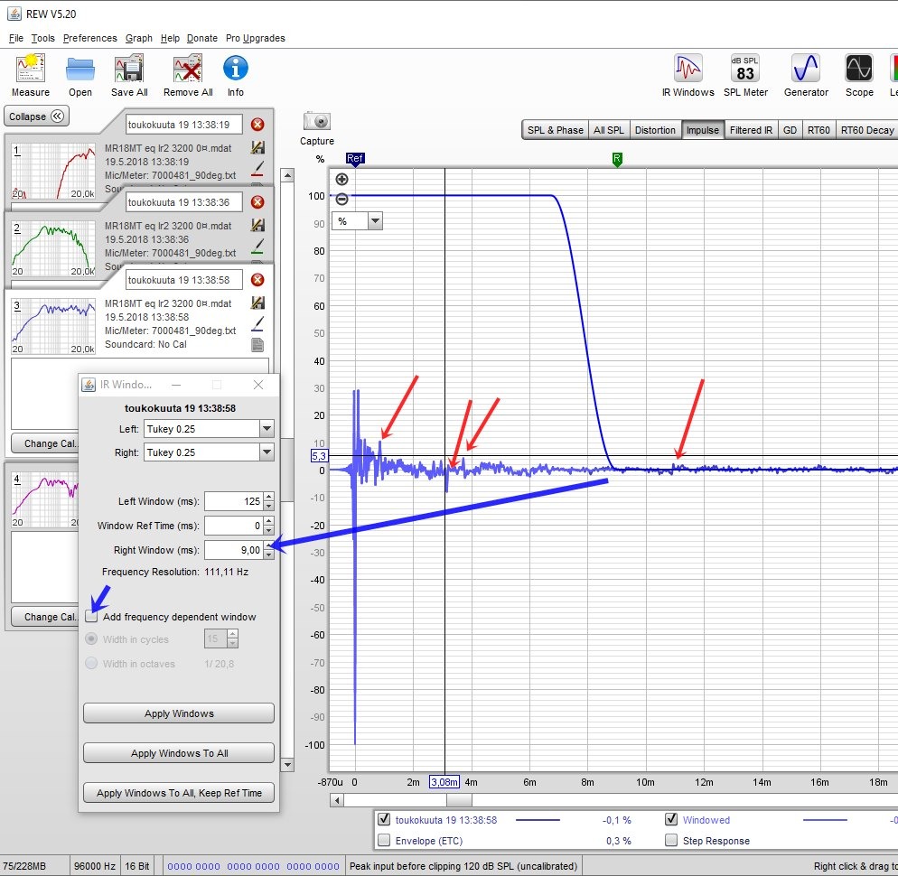

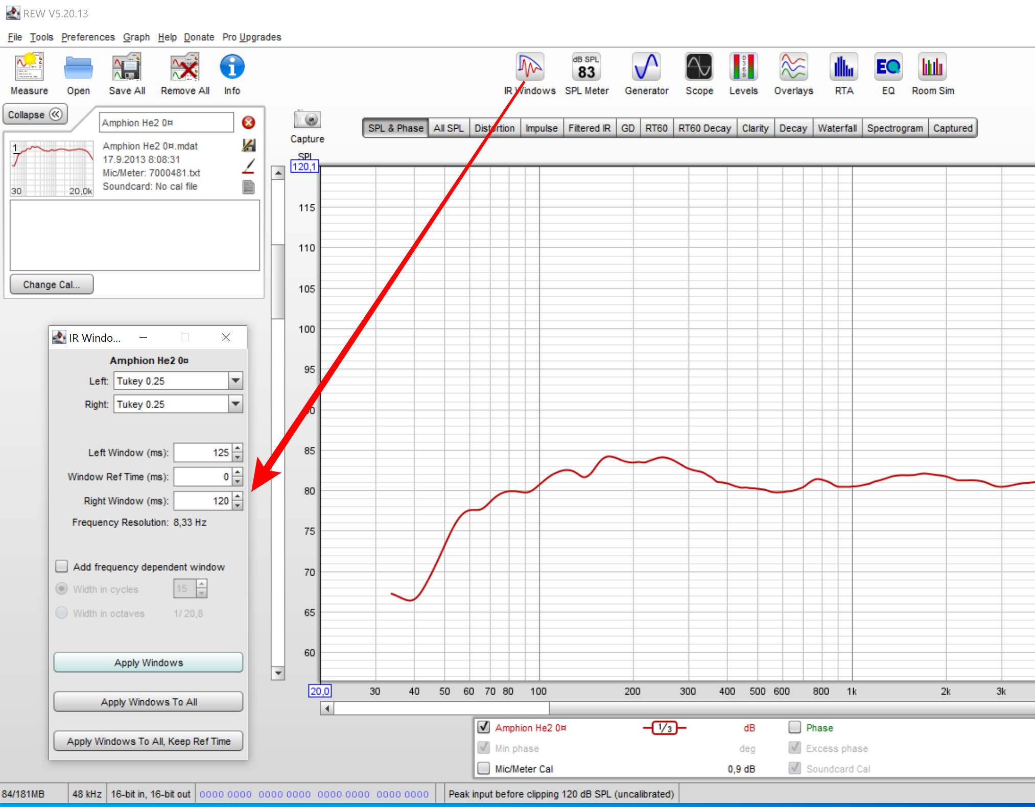

It is hidden in IR Windows settings and can be applied to measurements later, also gating can be removed if needed, just increase Right Window to big value, default in REW is 500 ms.I couldn’t find gating in REW. Not even in a help search. Gotta be there somewhere.
Right Window value define gating in ms. On Impulse response you can see defined window and also decide how many reflections can be involved in window.
If you drag green R letter on Impulse response, REW opens additional FR windows below IR what helps to define needed gate window.
I made overlay of 1 m and 2 m measurements with 3 and 6 ms gated FR-s from uploaded file.

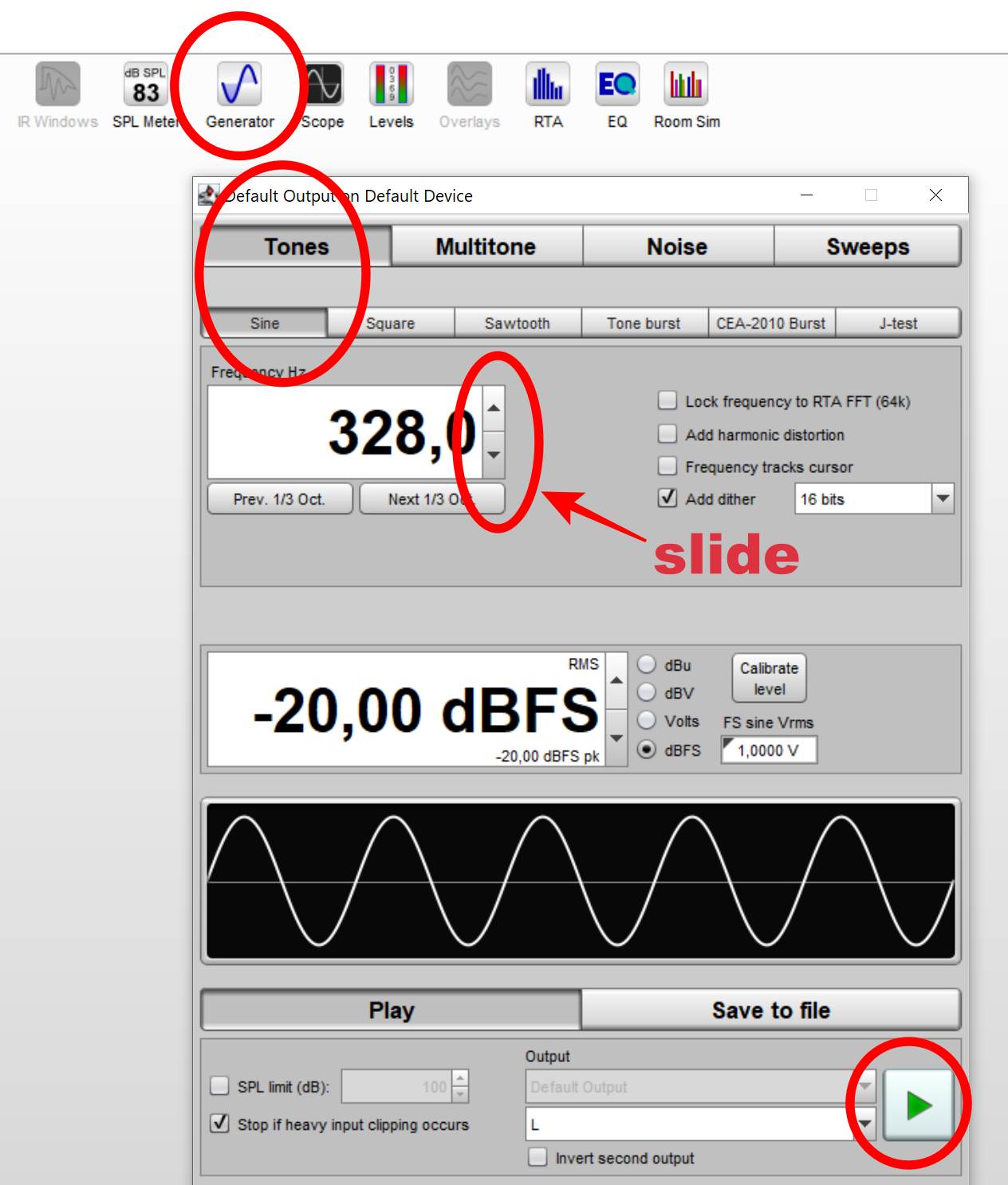

No need to generate a file. Use REW Generator "online" and slide the frequency slowly while playing. You will hear the resonance and perhaps locate it by listening very close, then let it play that F and adjust spl. Then by touching various parts of the speaker you can hear if the resonance attenuates. Keeping the hand on the baffle while sweeping propably kills the resonance, so don't touch it until you hear the buzz.
I was surprised how sensitive this method is, when I couldn't even hear the resonance in normal measurement sweep! It can be loose mounting of the driver, a wire touching the baffle, uneven stands etc. beside the baffle itself.

It is not very clear from measurements where is first dipole peak as gated measurement lowest frequency level is not very definite, level of one octave higher is reliable. But clear is that first dipole minimum is at 750-800 Hz.There is a big peak at 420 right where the prediction says it will be.

Wings will move peak and minimum to lower frequency, not remove them or decrease peak as it is dipole peak and minimum.
Baffle damping also nearly will not help.
Only way I see, is to make smaller baffle what turns first dipole peak and first minimum up and make possible to use LP filter what fits with tweeter HP filter. But there is draw back, smaller baffle means less bass.

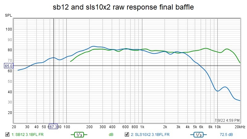

Raw response of 2x10" mtm with 4" fullrange after adding a 10.5" wing to one side angled out 12degrees off of right angle. 1.5" wing on the inside edge. Asymmetry is effective. These speakers hang from the ceiling in the spin studio of a local gym. Took quite a few baffles to get it this smooth with no filter. I prefer symmetry for home listening, and as you say one must be strategic with driver size and crossover points in that case.

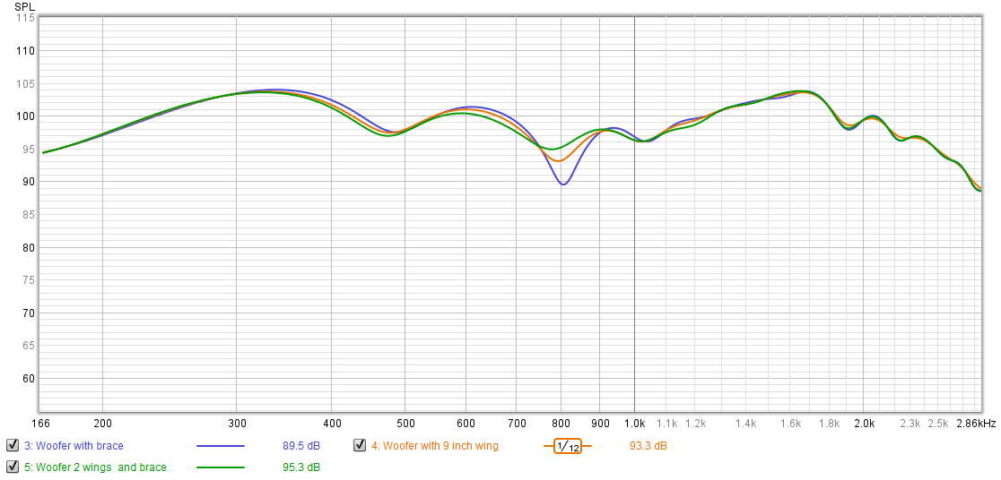

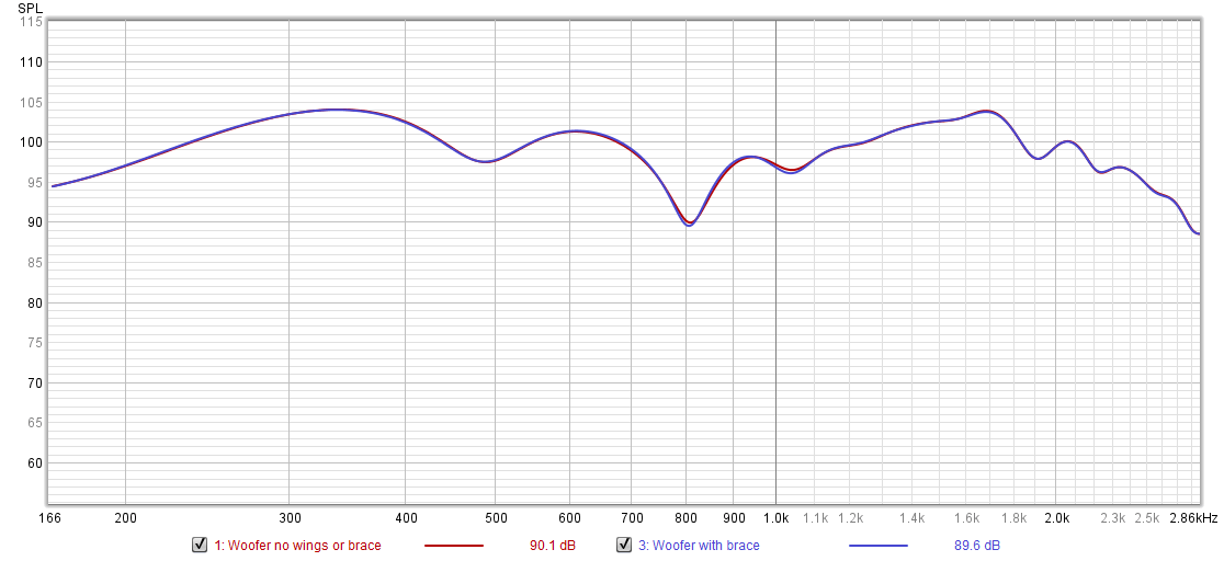

Here are a couple of quick measurements made today. I added a cross brace below the woofer, then one wing, then another wing. Wings are ~22cm deep.
The brace didn't do much, but the wings did. Notice how they killed the dip 806 Hz. These measurements are all at 1 meter from the baffle, speaker in the middle of the room. Wing measurements are gated @6ms
No cross brace, then brace added.
