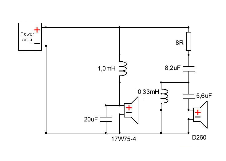

there is so much, what a crossover, simulated or look-measured, not performs,-)
And: good sources, good amps, good "rooms" are necessary,-)
Try to do something along these lines.

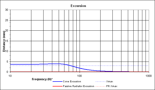

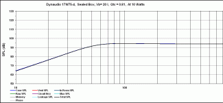

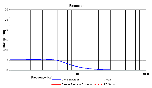

Most designs I have seen for this bass driver are limited to a pretty small box.... 10L. But, on the spec sheet, it says "up to 15L".
I was hoping to go for a larger box for a little more low bass. Is this going to pose a problem? I have a box that's 10L already but I was going to experiment with something larger.
The bigger, the imprecise.
Cause the case becomes unstable, resonances (to inside and outside!) in all directions,
cause the encased air/volume builds a mass-spring, it does resonate,
cause the reflections (and more in-front-resonances) on/off the, probably, larger front -
tones, which are not recorded - much more diffusity...
... you would need a tweeter🙂
Much better than a wooden case you build a stone-/concrete-case.
The opposite is the truth with 17W75. The greater cabinet volume gives
a lesser Qtc value, deeper bass output cutoff frequency and greater excursion
at Fc.
This driver has been known to bottom out at higher voltages,according to
some of the owners. I haven't got that particular type, only a more modern
version mw160 gt with a very stiff suspension.

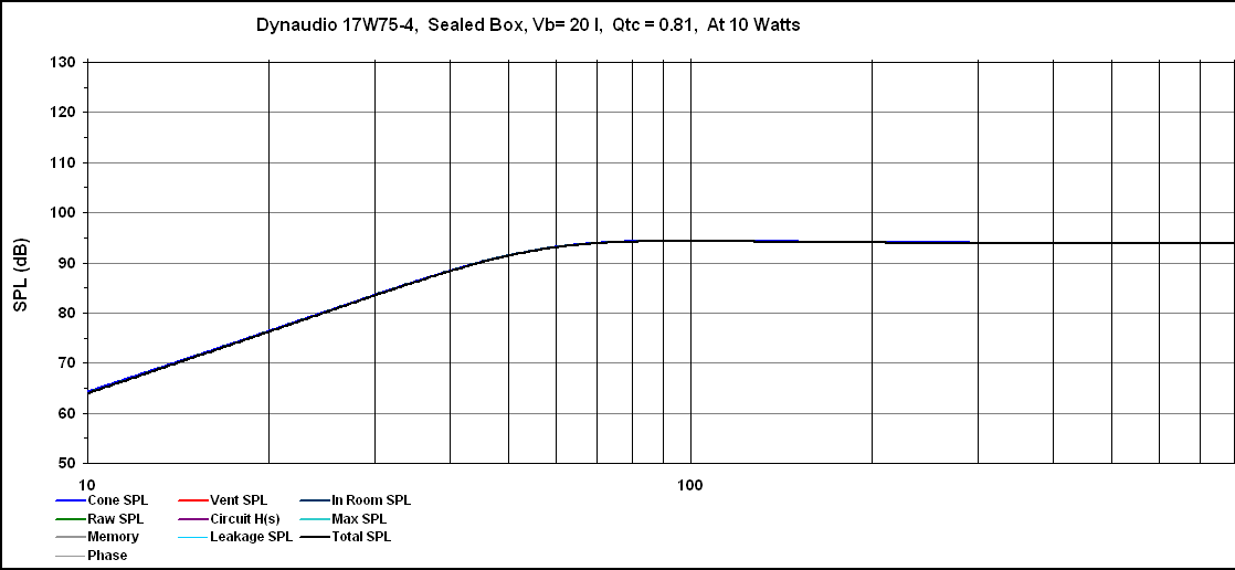

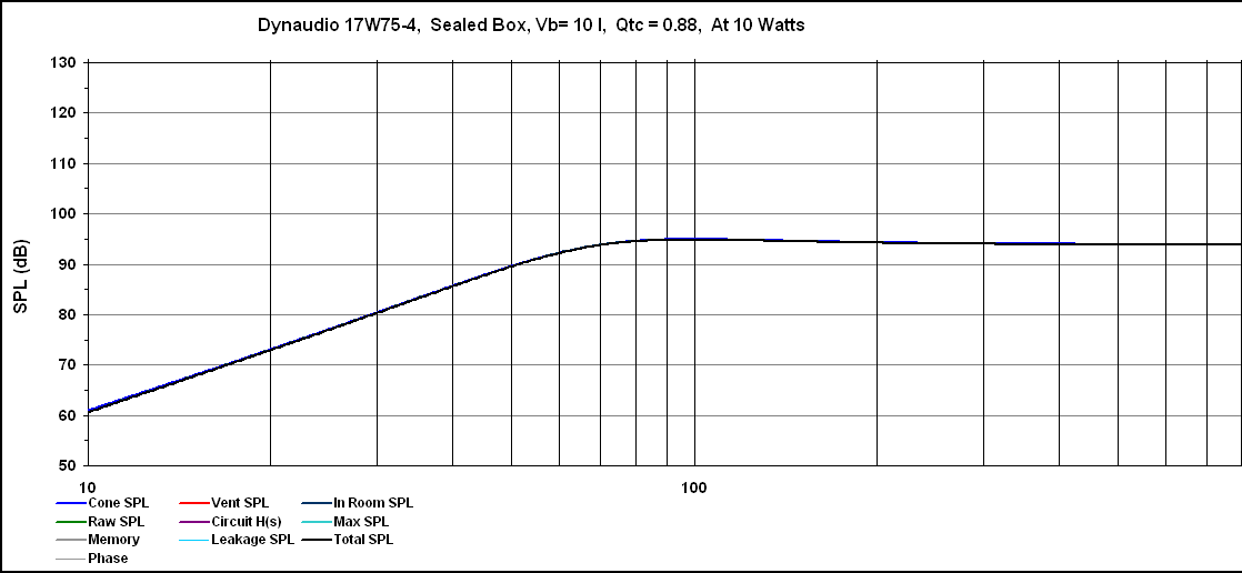

I would put the driver in a 15-20 litre cabinet to get a deeper
bass out of it, bearing in mind that the price of it would be increased
excursion for the same wattage. The diagrams show it. The needed
wadding (light to heavy) will lower the Qtc somewhat and kill the
standing waves. That's allright.
FWIW, ~15 L net is a ~1.1 Qtc before stuffing and what was considered by the pioneers of audio to be the most correct for the driver's compliance [Vas], so it wouldn't surprise me that's why Dynaudio recommends it. for a T/S max flat 0.707 Qtc OTOH requires a ~764 L cab, so this seems the reasonable size range by modern dtandards.
Being somewhat math challenged, I've no clue why, but have found that using the mean of most things speaker cab design related yields an excellent compromise between size Vs performance, so personally would use ~107 L based on its published specs and assuming a low total output impedance.
GM

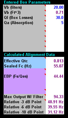

An adequately sized box volume stuffed fully would lower the
Qtc to about this simulated value(10W), not counting the Rdc
of the low pass inductor. That is a sane approach. I know that
because I have already done the same thing with 24W75, whose
Qt rised to 1,2 ( manufacture 0,9) after being fitted with a new
foam surround.
