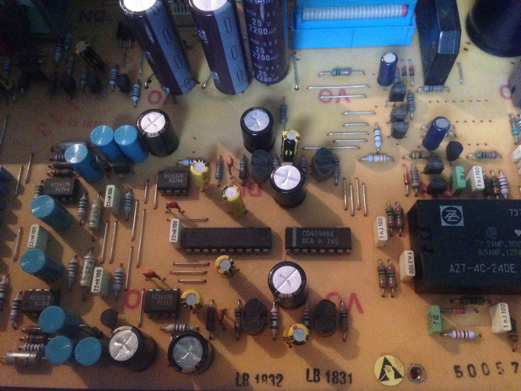

Picture of the decoder PCB with fresh caps.
As you can see my Silmic II are the "old" version with black body and gold stripes.
I hate the way the Nippon Chem SXE caps look in there, but ok, it sounds good.
Upper right small electrolytics are 1uF Panasonic FC
Big cap in the corner Nichicon KW.
Still have to change all the small yellow Frako electrolytics, awaiting the new caps shipment.
