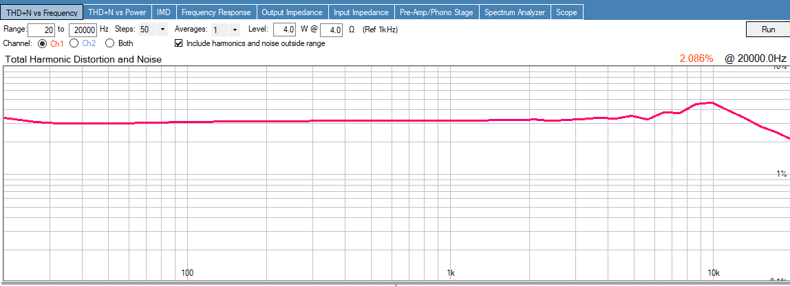

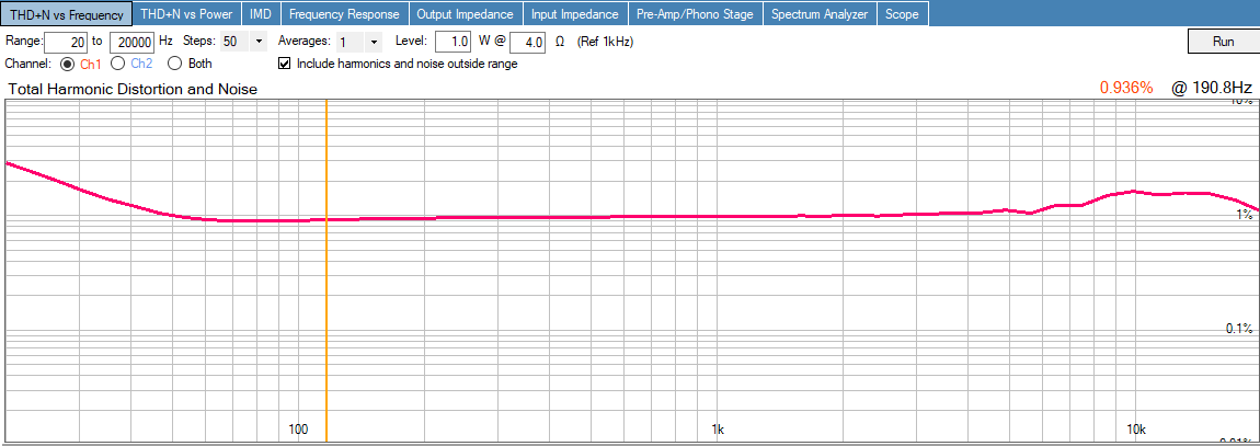

This is the S-5 k-16LS kit amplifier with CXPP25-8K output transformers. It's a PPP design and I wish I had transformers that had 4 ohm taps. I previously looked at rebuilding it as a 3 pair output to lower output impedance. Edcor says 120mA max AC+DC , but never specified on B+ or per plate lead. Others have asked and not gotten answers. I decided that 120mA on the B+ was unlikely since Hammond rates per plate lead and you'd need pretty high volts to get 25W with 120mA total.
I decided to do some testing. There is currently 100mA total on the B+, so 25mA a tube. Changing the cathode bias resistor experimentally I increased it to 163mA and distortion went down. So I figure that the core isn't saturating, and probably won't melt the winding. Transformers never warmed up before.
Here is the test data for this amp since I've never seen the data before. Of course the output transformers are upgraded, and no measurements were needed to know the Edcor was better in the bass frequencies. It's wired in UL mode. I was told that 20% UL taps would be better than the 40% with these tubes, but I have(kinda like I have 4 ohm speakers) 40% taps. This lowers output impedance, right?
I'll try to post test data with old transformers, and the Edcor without UL later.
Frequency response at default .1Vrms output. There is a decimal point in the db number 😉
Frequency response at approximately 4 watts, but I'm not sure if this "level" is in or out now.
1 Watt into 8 Ohms 100mA
4 Watts into 8 Ohms 100mA
1 Watt into 4 Ohms 100mA
4 Watts into 4 Ohms 100mA
1 Watt into 4 Ohms 163mA
4 Watts into 4 Ohms 163mA

So removed UL and went back to pentode operation and tested again. Results are up a little and down a little depending on power level.
1 Watt 4 Ohms in pentode mode.
4 Watts 4 Ohms in pentode mode.
Unless I'm missing something I'm going to build the 3 pair PP amp with fixed bias. Should lower my output impedance some to closer to the speakers. If I stay at 25mA per tube I'll be under the 163mA I tested before and with it'll be easier to adjust bias currents for more testing. I can go up to 40mA each and get the 120mA per side I think is safe with this transformer.
Cory
Cory

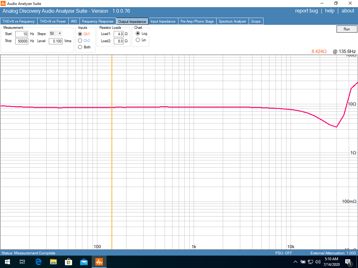

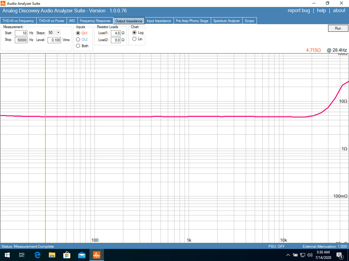

@6A3sUMMER Thanks for taking the time!
Sorry for the lack of information, I was trying to keep it short enough to read. I wanted to give some information on this kit as I've never seen test data, and many dislike it. Also wanted verification that Edcor's 120mA couldn't be on the B+ lead
, or it is very conservative.
The only change to the schematic was hooking the UL taps to the screen resistors instead of B+ and upgrading to the Edcor transformers, that is the schematic that came with the kit. It's a PCB design so big changes are hard to make. I think will try triode connection. Minimum experiences say I won't prefer it. Getting a little more power out of it was part of why I wanted to add another set of tubes.
You are correct there is no way to balance the current, or even measure it. Individual resistors are an option, but makes it a lot harder to play with bias settings. Either change will mostly likely be a new point to point with a few boards mixed in.
Now for my lack of understanding, and confusion to show up. I understand the impedance ratio of the transformer. And that tubes have listed data saying where they are best at. Datasheet says for PP 10K plate to plate, by 2 pairs that makes 5K, moving to 3 pairs is 3.3K. I have a 5K to 8 ohm transformer, with a 4 ohm speaker that's 2.5K. The book says lowest distortion is at 6K, which I assume would be 12K in PP. Also raising the plate voltage lowers the impedance some.
Does changing to triode, raising the voltage, or increasing NF effect the ideal impedance as far as distortion goes? After writing this I assume it does. I still don't have my head wrapped around everything involved with how tiode, UL, pentode and the output transformer are intertwined. I guess the function of triode mode makes good sense to me. Plate impedance of 5K and resistance of 50K is confusing. Is this related to the amount that the resistance 'can' change? I guess that is the third reason to build an amp is so I have access to modify it more and experiment. Any suggested reading?
Output impedance in UL
In pentode
Thanks again

1. Plate impedance, rp, is in parallel with the output transformer primary.
In Beam Power Mode (and in Pentode Mode for pentodes), most of the power is sent to the 5k transformer and from there to the load (speaker), very little power is used up by rp.
But damping factor is low. Each rp is 50k, and 1/2 of each output transformer primary is 1250 Ohms; 1/2 winding is 1/4 impedance (1/4 of 5k). But in Class A when both tubes are conducting, it is as if two 50k rp's (25k) was in parallel with 1250 Ohms). 1,250/2,5000
That gives a very low damping factor of only 0.05.
And the gain of the output tube is the tube transconductance, Gm, times the load impedance, which is quite high.
The fix for the low damping factor is to use lots of negative feedback, and the damping factor is increased.
Beam Power Mode and Pentode Modes give the most power out, so little power is wasted in in the plate impedance, rp.
2. Beam Power (and Pentodes) that are wired in Triode Wired Mode, have the lowest plate impedance, rp. And the gain is lowest too. A 6BQ5 plate impedance might be as low as 1500 Ohms. In Class A, we effectively have 1500 Ohms/2 in parallel with 1250 Ohms (1/2 primary).
1500/2 = 750 Ohms. 1250/750 = 1.67. The damping factor, DF, is now 1.67, much much higher than the Beam Power'sDF of 0.05. And . . . we have not even used any negative feedback. Negative Feedback will increase the damping factor.
