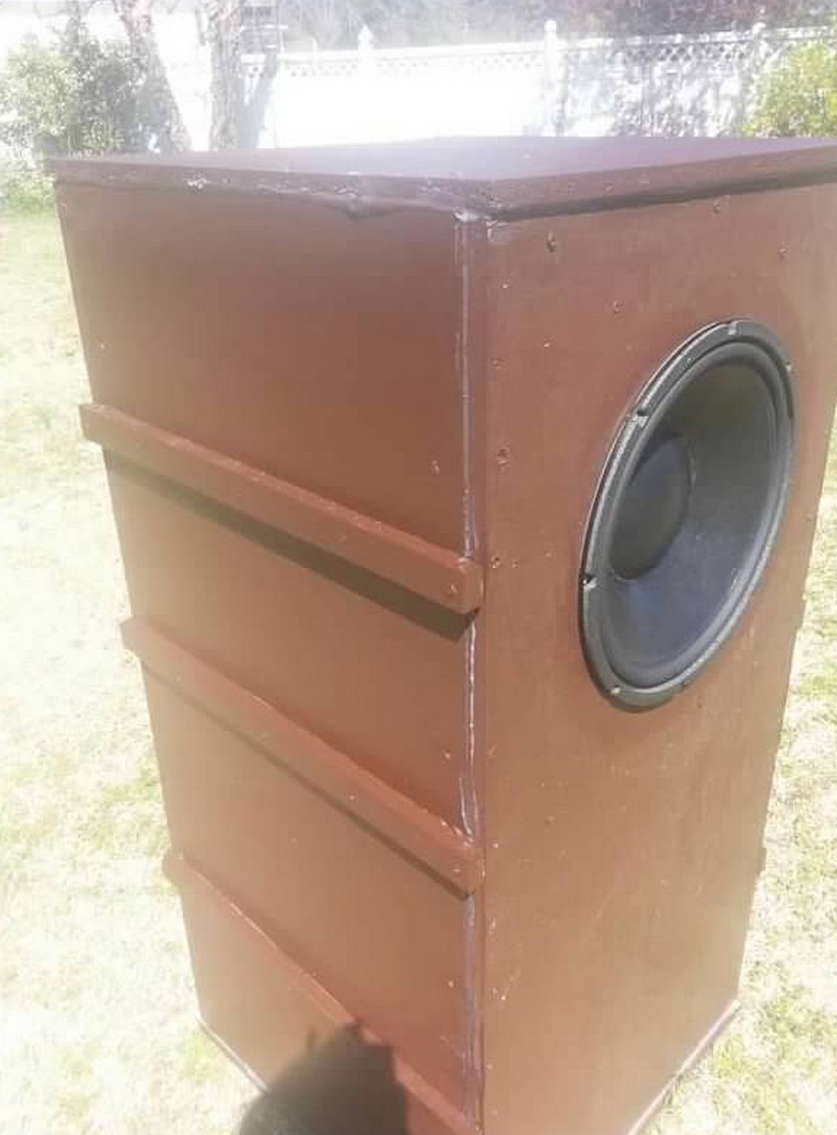

A port in the existing box is the best option by far, it will gain approximately 12 db at 16 hz for free, resulting in a bit more than doubling the perceived loudness at 16 hz. Adding another identical ported box and fully powering it will add another 6 db, for a total of + 18 db, almost 3x louder than the current situation. And that's still not even close to enough.
If OP doesn't have the construction skills to add a port to the box (he's mentioned several times that it's too difficult) I don't think horns are going to be in the cards.

Edit: Just so we're clear what we're talking about, this is the subwoofer in question, in case anyone missed the link.

I've shown sims a few times, most recently just a couple of posts ago. About 105 db at 1 meter at xmax, a bit more if you ignore xmax and shoot for xlim.
Not 80 - 90 db for sure, but even 105 is still barely perceptible at 16 hz.
