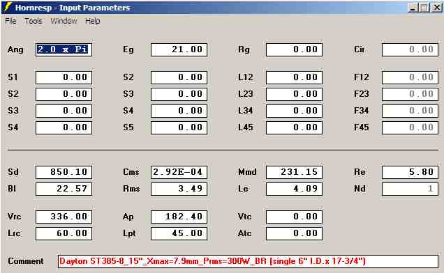

As I'm the guilty party suggesting 2ea. 6"I.D. ducts I went back, and checked the simulation in Hornresp, and 1ea. 6"I.D. duct @ 17-3/4" (45cm) would be sufficient. That is for 1ea. ST385-8 in your box. Much easier. So much for just a quick guess.
I'm attaching a number of the Hornresp screens including the input I used. Please, check everything to make sure I didn't fumble finger the data.
I'm also the one w/ the rule of thumb for passives area / driver Sd. It's an old rule, so many people may not have heard of it. Anyway, I also pointed to Jeff Bagby's software which I believe is quite nice for designing PR boxes. For all other boxes I recommend Hornresp and AkAbak.
Best of luck with your project.
P.S.: At the bottom of the reply page you'll find a Manage Attachments button. This will pop up a window to allow you to find files on your computer to use as attachments.

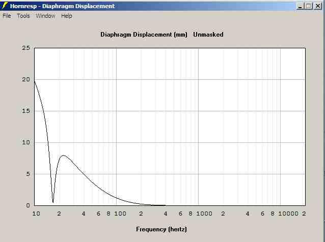

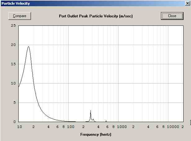

Pic 1 - Hornresp inputs.

Pic 4 - Port velocity peaks at 16 m/s with this 200 sq cm 60.5 inch long port. This is acceptable, there won't be any port noise. If you don't mind a larger, longer port that would be even better.
Pic 5 - This is the excursion graph, this shows that the cone excursion at the power level these graphs are shown at is 8 mm. You can use a high pass filter to protect the driver below 14 hz if you like.
So you can see that port and/or enclosure resonances are NOT a problem. Port noise is NOT a problem. Adding a port to a box is free and only slightly more difficult than tripping on your own shoelaces. The ported box outperforms the sealed box AND the dual driver sealed box by no small margin. Passive radiators are expensive and you will need probably 4 of them PER driver.
