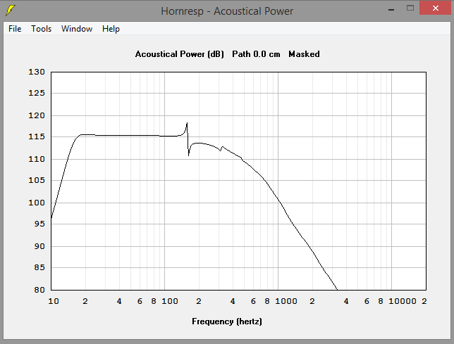

Clearly you've never even seen a simulator before. Hornresp shows efficiency and loudness (spl at xmax or any other level you want to see).
Based on your previous criticisms of simulators I strongly suspected you had never seen one, I think this proves it.

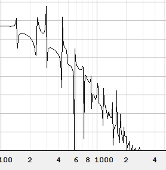

So I did a sanity check on your simulation ( just a guy )
You can't miss the resonances that are present.
I agree with DrDyna that they will not be as awful as simulated.
But note that a number of factors are missing in this simulation.
The driver is simulated as a perfect plane piston.
No breakup modes or any other driver distortions are in this simulation.
There will be in real life as you are pumping in 100 watts or so into this sim.
There is no modeling of driver suspension nonlinearities either.
In short you have a simulation of a perfect driver in an enclosure.
A perfect driver does not exist.
And I have tried hard to make them.
Still have absolute faith in your simulator?

So what? It's a ported box. The sim will match the measurement if you accurately sim what you build.
So what? Cone breakup is at 1.2 khz on this driver. Here's the data sheet - http://www.parts-express.com/pedocs/specs/295-130-dayton-audio-st385-8-specifications.pdf
If you don't like the breakup notch it out, but at 1.2 khz I doubt it matters much.
So what? We are all well aware of distortion at high power, power compression and port compression among a whole host of other things. These are so commonplace and well known these things usually are not even mentioned because even beginners know all about these issues, expect them, and even know approximately when they are going to kick in and how bad they will be.
So what? That's what klippel is for. I assume by now you've learned how to read the graphs. Dayton driver are very conservatively rated. This driver will be fine at least until it's 8 mm xmax.
Absolutely I have absolute faith in my simulator, because like most people I know it's shortcomings and the things it fails to address. You do to. So do most people. My simulator has been proven thousands of times over to be accurate within it's limitations.

View attachment 478798 You can't miss the resonances that are present.
I'll mention this again since you apparently missed it. When measured in real life those resonances will be about +/-1 db ripple and only above 140 hz.
A small amount of stuffing will make that curve smooth as a baby's butt.
TB46 simulated this in Akabak as mltl to determine proper port placement to further reduce the ripple.
Those resonances are not a problem. If that's what you are stuck on, forgetting your lunch and having to buy lunch should be a much bigger concern, that's a problem orders of magnitude more serious than those resonances.
I agree with just a guy on this one. Resonances in a properly designed ported box are small enough.I'll mention this again since you apparently missed it. When measured in real life those resonances will be about +/-1 db ripple and only above 140 hz.

Case in point . . . my own home subwoofer. Four 12” drivers (13mm x-max) and two 6” diameter by 12” long ports in about a 50 cu ft box. The box resonance is about 15 Hz., which gives essentially flat response to that frequency at 115dB 1 meter.
Close the ports and, according to the must-be-correct sim, the output at 20Hz drops by 6 dB and at 16Hz it drops by almost 9 dB (plus going well over x-max . . . if I lower the amplifier power to stay below x-max the overall acoustic output is down 12 dB). That’s the difference the box resonance makes. You can definitely hear it. That's why we use ported boxes for subwoofers.
The port resonance, on the other hand, because of the large diameter and short length, is up about 750 Hz. . . . far enough above the 50 Hz. crossover that it doesn’t even remotely matter. Even without the crossover it would have negligible effect on the sound of a 8’ (top of the 32’stop) organ pipe. That’s why only an idiot would use long skinny ports instead of short stout ones . . .
Parasitic resonances (e.g. 120 Hz) should be small, not the fundamental Helmholtz box resonance Fb.Small enough for what? If you can't hear the box resonance there's no point in ported boxes . . . hearing the resonance is what we build them for.
There are techniques to make the unwanted parasitic resonance small. For example, to couple the wall of the port to a small Helmholtz lossy resonator. I have tried that, works like a charm. Also, crossover frequency can be 80 Hz, not 177 Hz. With 24 dB slope active crossover, there will be additional attenuation at 120 Hz.You can't hear the pipe (port) resonance if it's high enough above crossover (which it is in almost all subwoofers). But . . . you don't want it in the passband if you can avoid it, which it is (or would be) with the described organ speaker, and you definitely don't want it so low that it's excited by the second or third harmonic of the fundamental. A 120 Hz pipe resonance from the port on an organ woofer is simply stupid . . . evidence of a complete lack of understanding of simple acoustics . . .

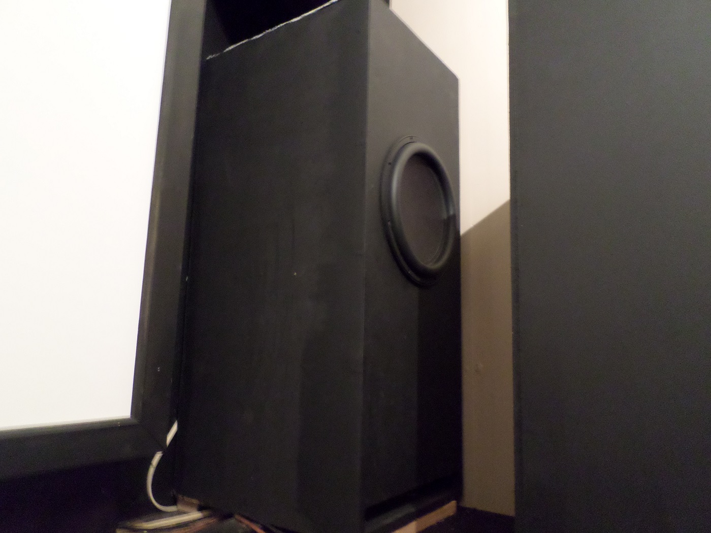

Here's a picture of one of my subs. Note that it's nearly identical to what you have, except it has a decent driver and a slot port, and I can tell you from actual, real experience that it does not have the port resonance indicated in the sim, but rather an insignificant bump that is far enough out of it's passband to be completely ignored.
