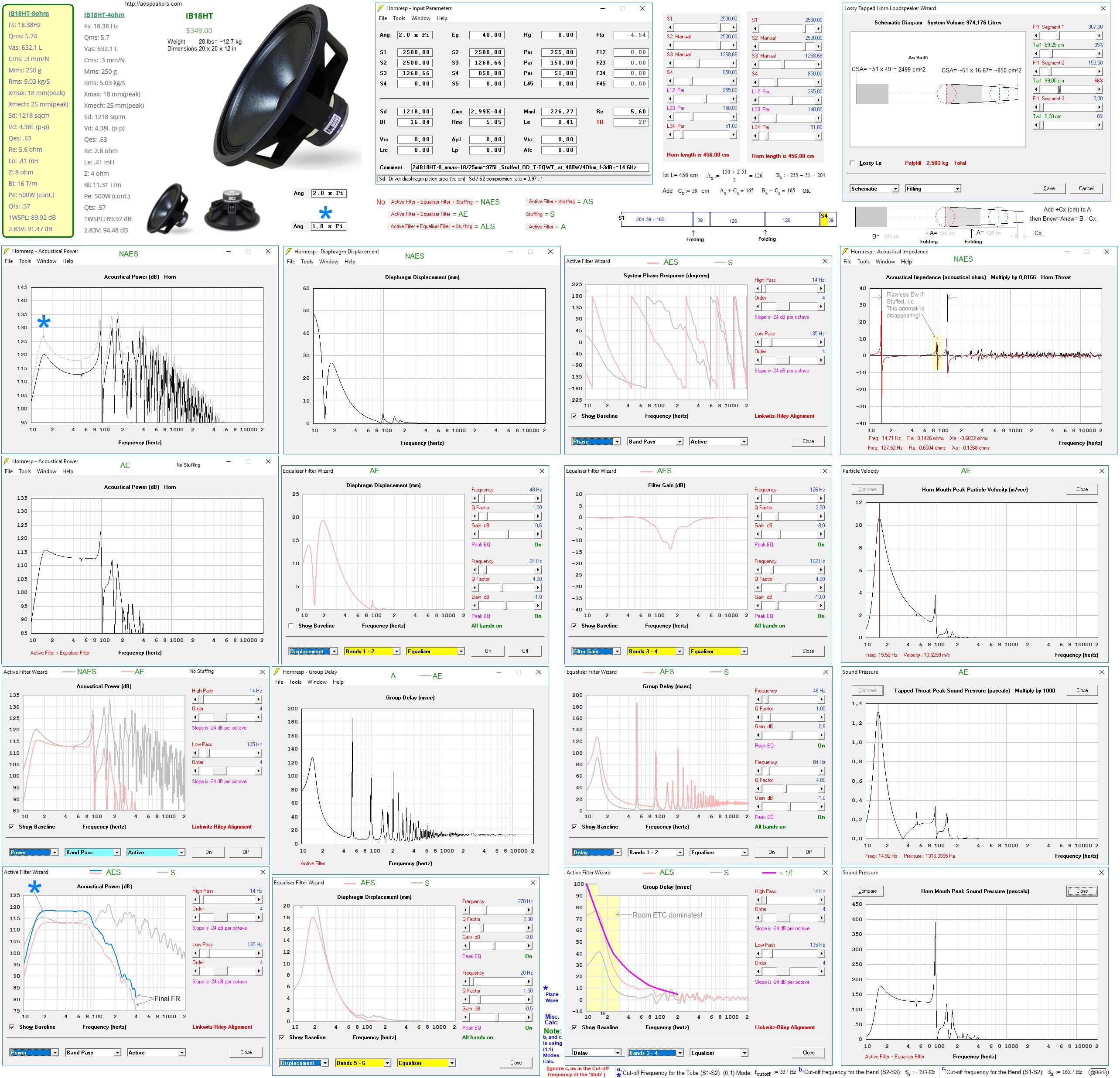

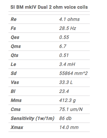

DTS10 and appropriate driver or specs
Art and Chris I understand you point, but you are making many assumptions that would take a HUGE post to explain. Art, You have said that the DTS10 will suit my purposes at 16 Hz with pipe organ SPL levels. The LAB 12 driver seems to have specs that are not as good as the original Eminence 122345. Is there any particular drivers that you might suggest or parameters that you would look for in a 2 driver box, like the DTS10? I appreciate your help, but please leave the aspects of the project to me, we are speaking of just the sup-woofer and enclosure that will do the job. Thank you, Steven
The specific parameters to look for were given in post #35, the LAB 12's Bl does not look adequate.The LAB 12 driver seems to have specs that are not as good as the original Eminence 122345. Is there any particular drivers that you might suggest or parameters that you would look for in a 2 driver box, like the DTS10? I appreciate your help, but please leave the aspects of the project to me, we are speaking of just the sup-woofer and enclosure that will do the job.
The new Stereo Integrity BM mkIV 12" TS parameters look like it would fill the bill at a reasonable price, though really strong magnetic force does not come cheap.

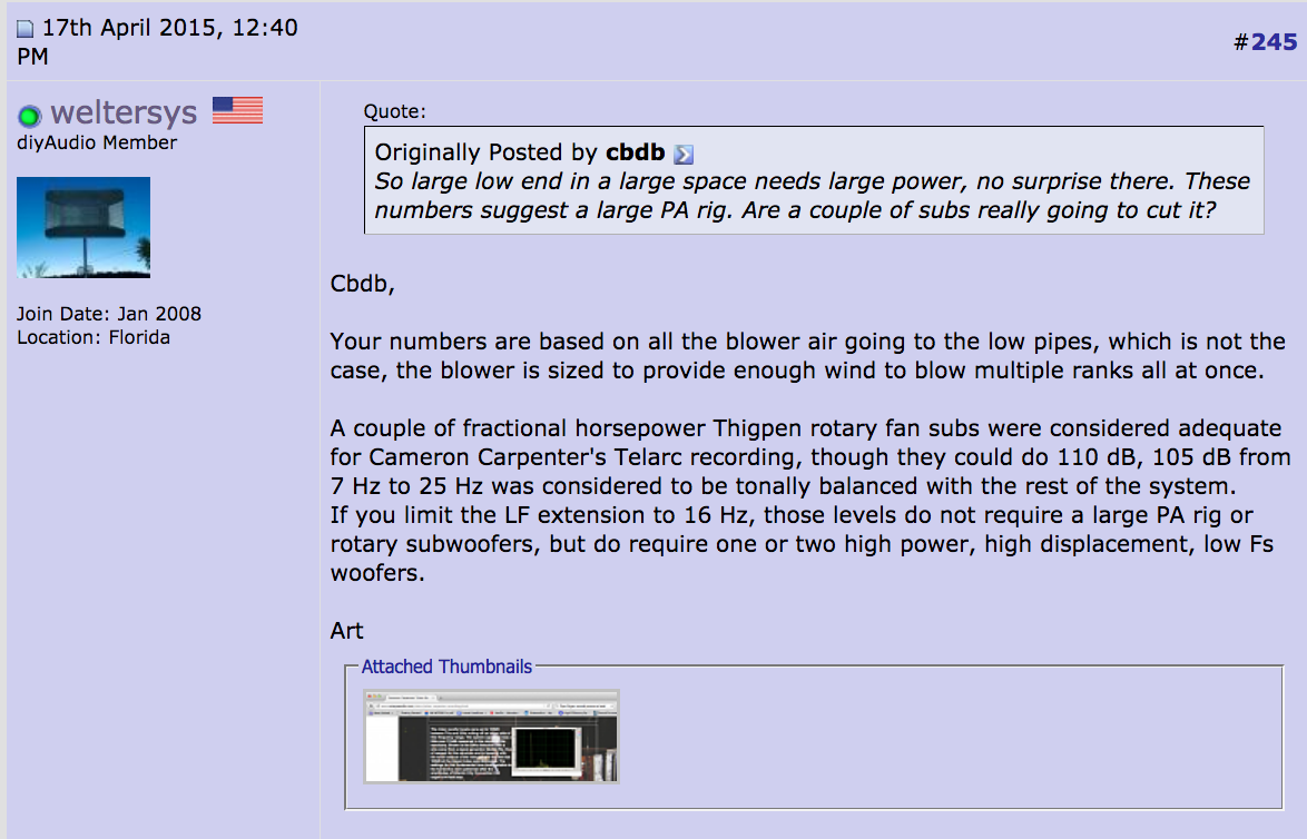

1) Others have, I have based my reccomendations on their measurements and my own experiences with pipe organs and a plethora of other low frequency instruments, both acoustic, synthetic, or sampled, all the way back from Kurzweil's first samplers back in 1984.
If 105 dB was good enough for Cameron Carpenter, I figured the DTS-10 should be plenty for you.
See post #245:
16Hz for church organ
That thread went on forever, three years ago..
