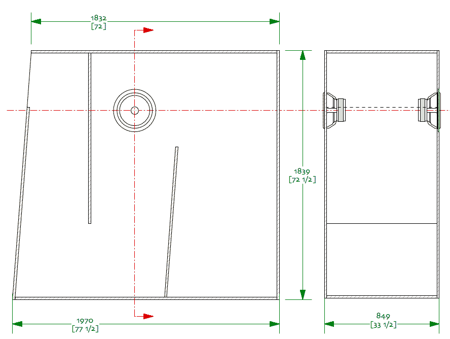

A push-push pair in a TL playing low and loud might be appropriate, such as an adaptation of your dual B-139 with a single fold, using a pair of LAB 12
Using MJK tables and a 10:1 line to keep it short. This is a 1st approximation of a line as so specified… one is going to have to hope for minimum 36” door openings. Necessary bracing not shown, but room included for it.
attachment.php
dave

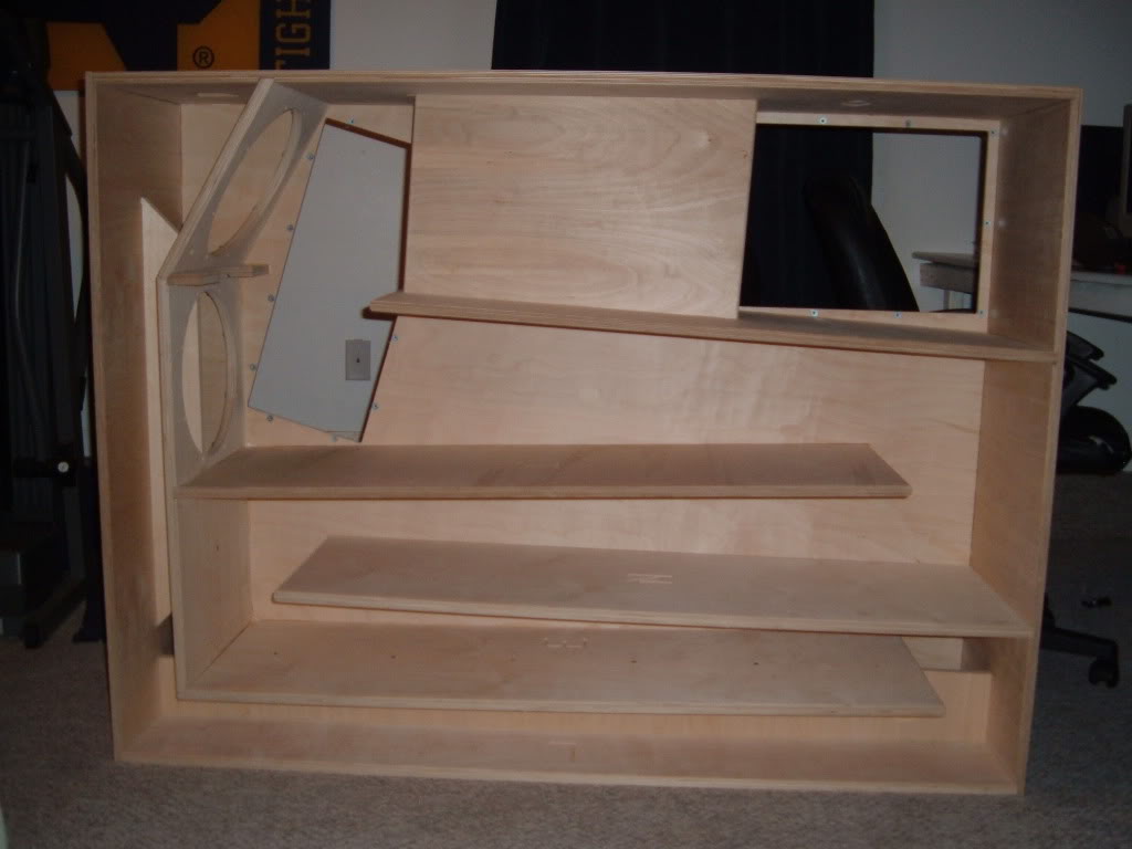

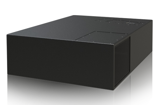

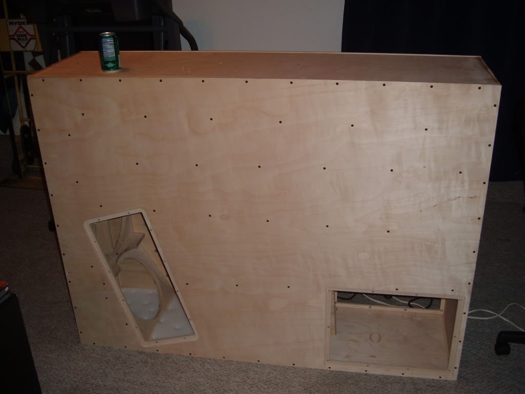

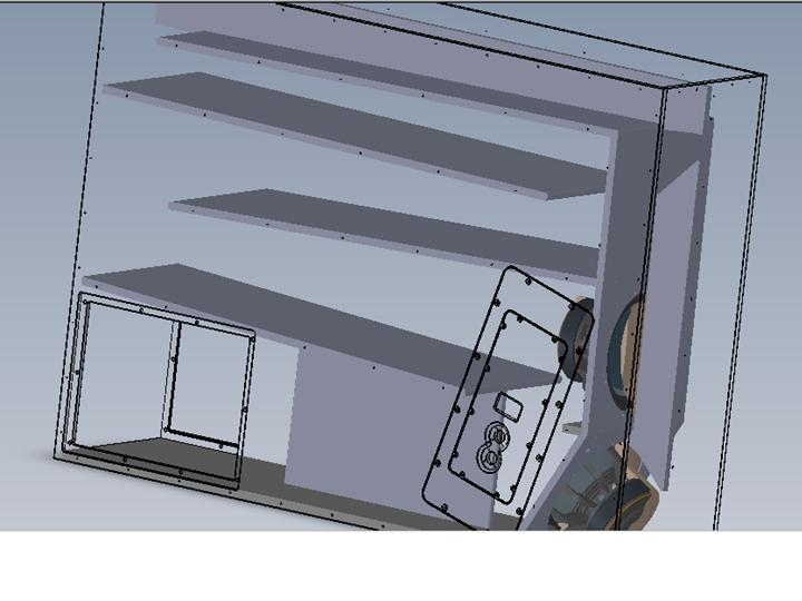

After many suggestions and searching...
From what I have read and what people have suggested, given the limitations of size and also the requirements of the enclosure, I have decided that a ML-TL design is probably the best computerize (and hopefully it is not a big computerize). I am going to model the build after the Danley DTS10 DTS10 | Danley Sounds Labs | Danley Sound Labs, Inc. . I know that is about a 9 year old design, but with the right drivers (12" with a lot of excursion) since the don't make the original driver that was in those in the beginning ( 2 - 12" Eminence 12245s), I need a modern comparable pair of drivers that aren't a million dollars. I have not been able to find the T/S spec on that speaker yet to make a comparison to something made today, but maybe someone here will have suggestions. The wattage will be around 1000watts, based on those used back then. That might have to be changed, but the specs of the DTS10 goes down to 10 Hz at ~90dB and rises to about 132 dB in the 80 Hz - 100 Hz range. The SPL is large IIRC. This is not my area of expertise, so the learning curve is steep as this is for a single design that will be repeated, if it does the intended job. Thank you, Steven

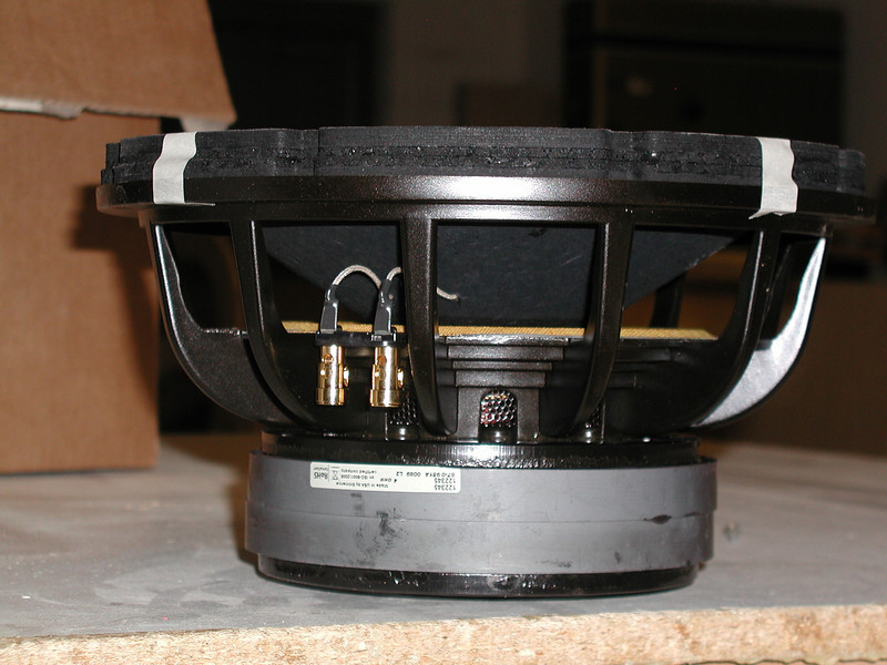

I am going to model the build after the Danley DTS10. I know that is about a 9 year old design, but with the right drivers (12" with a lot of excursion) since the don't make the original driver that was in those in the beginning ( 2 - 12" Eminence 12245s), I need a modern comparable pair of drivers that aren't a million dollars.

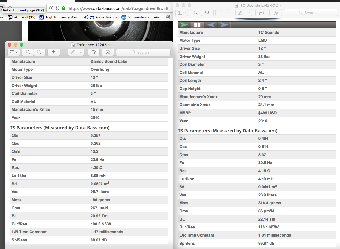

Steven,

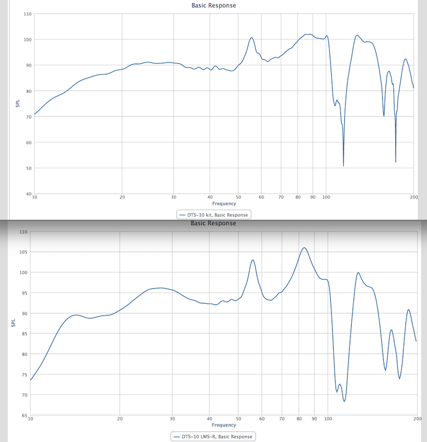

Josh Ricci (Data Bass link in post #6) tested the DTS10 with both the stock Eminence drivers and the TC Sounds LMS-R 12". He provided the TS parameters for both, the LMS-R 12" was capable of more output due to it's increased Xmax over the Eminence, though not as much as the difference would suggest.
The LMS-R has more motor strength (Bl), but a higher Fs, resulting in more SPL at the Fc (horn Cut-off Frequency) of 14-15 Hz, but a steeper drop off below.
Frequency response and TS parameters as measured by Josh Ricci below.
Given the large variations of many of the TS parameters between the two drivers did not result in large frequency response variations (compared to what will be experienced in rooms!), there is quite a bit of latitude in finding suitable replacement drivers.
Keep Bl in mind- much below around 20Tm the very low frequency performance may suffer.
Thank you for the T/S and Chart Info.
Hi Art and All, Thank you for the T/S info. and the chart info on the Eminence 122345. I couldn't find any reference for the driver and I assumed that because it is ~9 years old that it is well out of production and because this is so out of my forte, I guess I didn't know the right places to look.

I believe that Eminence 12" was replaced with the LAB 12 driver, which is still in production. You will need an appropriate pro sound amplifier, and the used market is your friend here. Hopefully the experts will keep contributing to this worthy cause. The 16 Hz target is in the home theater realm though, so getting the right rig will take some wrangling to keep the cost down.

If you have any more questions regarding the DTS-10, ask away.
By the way, you could build the cabinet and use only one driver to start with a cover over the second driver cut out, then later add a second driver if you still want more output.
The second driver and power will add 6 dB output, which sounds more than twice as loud to your hearing at 16 Hz. The DTS-10 with one modern driver properly powered will be a lot (as in more than twice as loud) louder at 16 Hz than the 60 watt EV 30W used in the 1974 cabinet that came with an analog Rodgers.
As phivates mentioned, use decent plywood rather than MDF, the goal is a stiff enclosure, not one that weighs a half-ton. You can save up for plywood, you don't want to pay for a back injury for the rest of your life.
