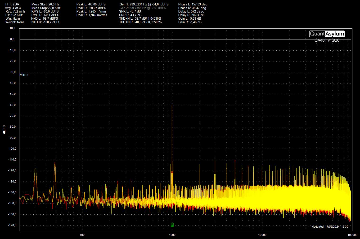

I want to know, what is the minimum possible THD at -60db level for 16 bit DAC?
Here is an measurement made of an TDA1541A non oversampling full passive , without any kinda filtering :
dont know if it's the minimum possible for an 16 bit DAC , but it doesn't seam's that far 🙂
- Digital Line Level
- 16 bit DAC AT-60DB
