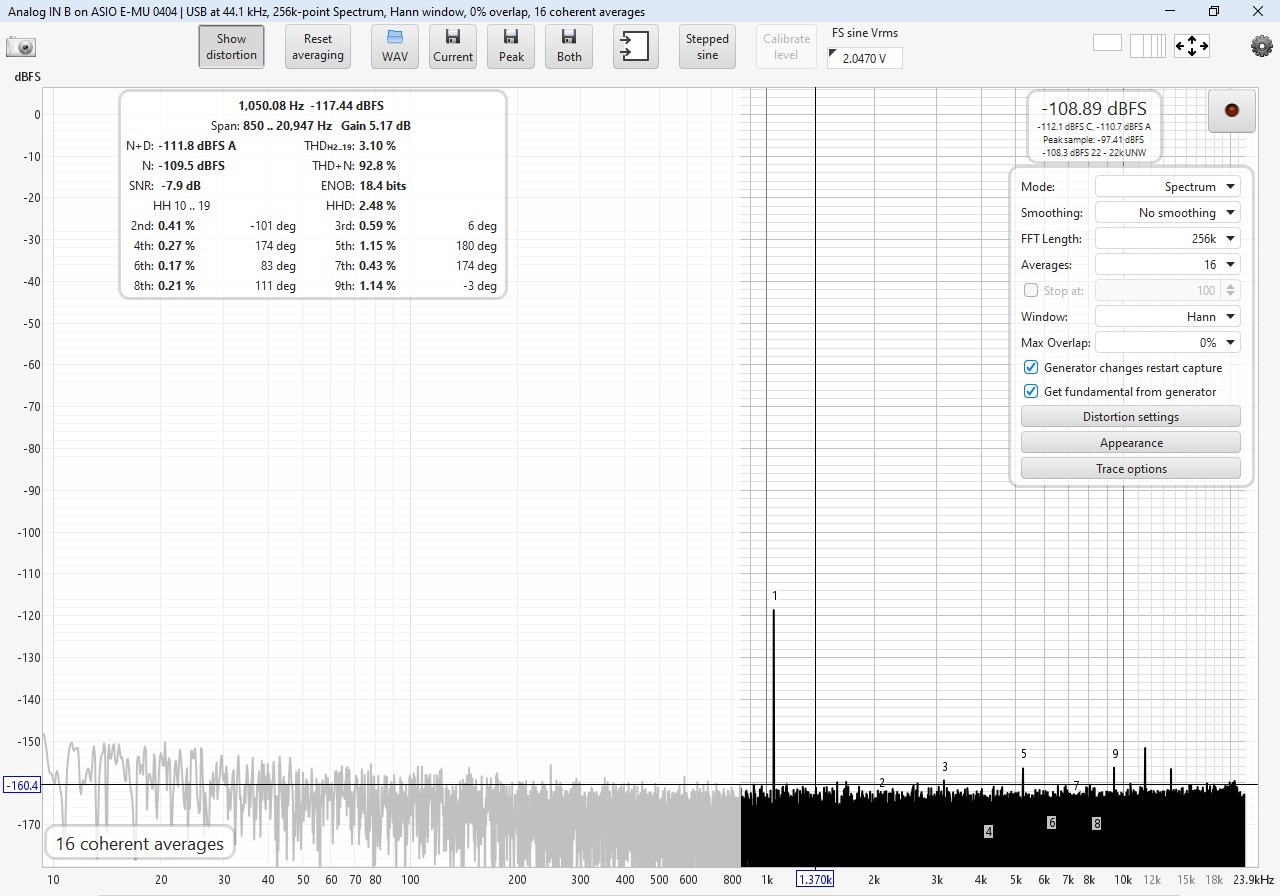

Please notice that for that test I had opted for no averaging, thus THD figures are highish.There is an error in table 16bit. The THD 1.9% and THD+N is also 1.9%. On FFT it says 2.17%. with 20khz BW. The DS gives typical 1.8% with A weighted which is 80khz BW.

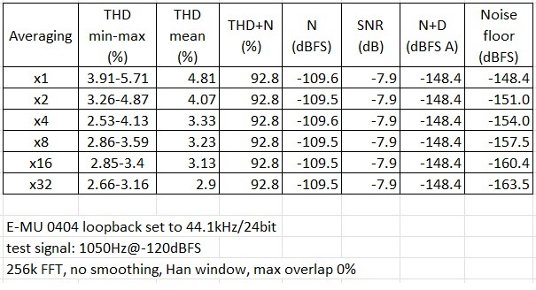

Also, THD numbers shown on results window of the software are not definite-fixed numbers. They vary over time if someone watches the screen, even after the number of selected averaging has passed. I had done a test to check the effect of averaging over THD and noise numbers, see attachment.
What changes predictably is the noise floor (-3 db for each average doubling).
THD fluctuates but the mean drops (this operation has to be done manually).
All other reported properties don't change
The measured effect is significant well below -60dB (for 16 bit data). The perceived audible effect varies among listeners.Because of dither, the noise doubled, +6db but the THD decreased significantly only at -80db, is it really audible?

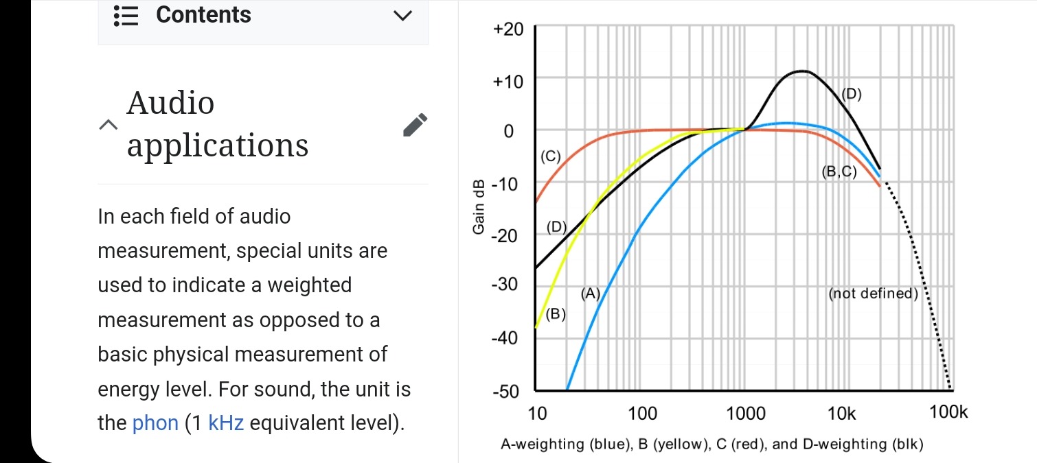

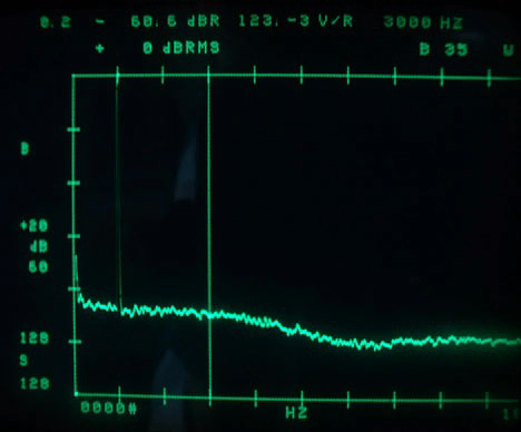

I made some simulation about A weighted and George's measurements 850hz to 21khz.
This in blue is the A filter.

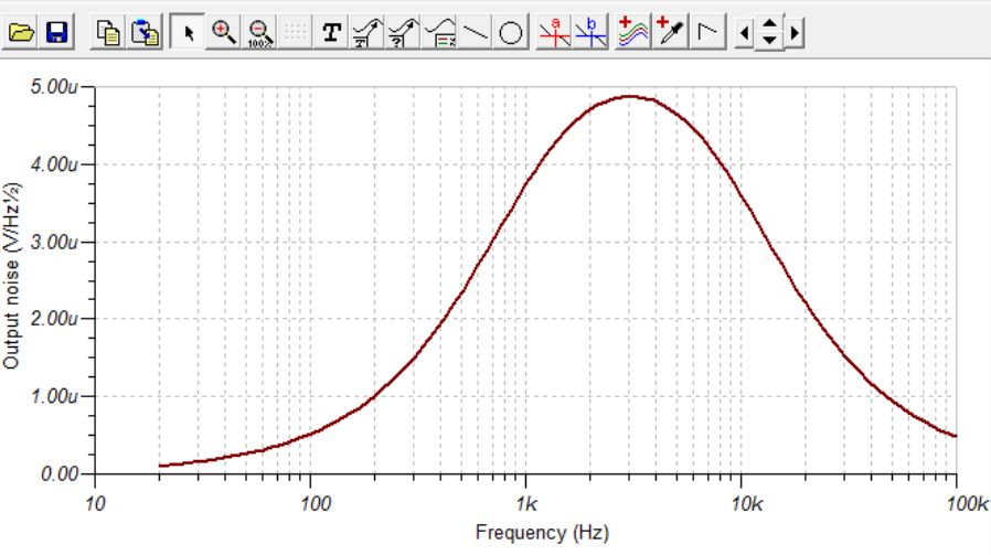

I generated a white noise by zener and filter it approximately.
The total noise for 20khz BW is 510uv.

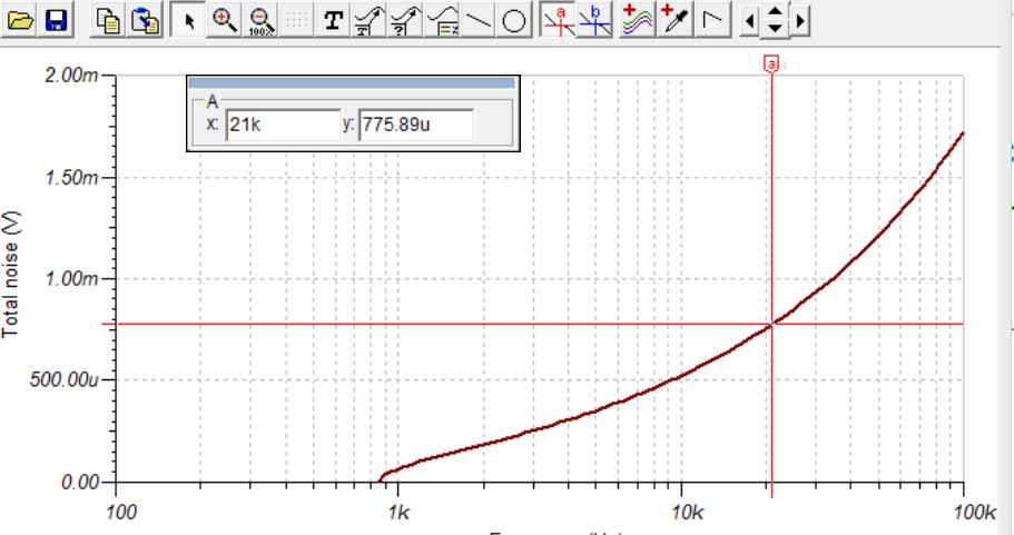

When measured without filter but from 850hz to 21khz as George did I have 770uv
This gives 3.64db difference.
Now can conclude that 4x// increased the S/N by 4.64db.

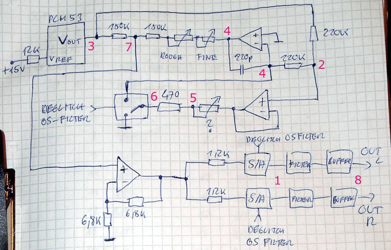

He measured CD players by test CD with different DACs.@Ken Newton indicated me a very important thread posted by @Bernhard in 2005.
By selecting among 50 pcm56, he could find miraculous one with no distortion.
But what amazing, is the Teac ZD700, also very clean but with some extra noise, probably dithered.
Post in thread 'New DAC measurement' https://www.diyaudio.com/community/threads/new-dac-measurement.49778/post-616228
He will study it in more detail.
https://www.diyaudio.com/community/threads/strange-teac-dac.56902/
The confusing element is the decimation is also applied which makes difficult to see the real reason of so low distortion.

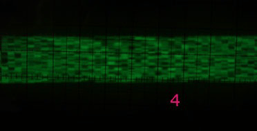

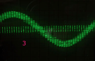

This what comes out from the DAC pcm53.
And this is noise generator probably.
I don't understand how the circuit generates both noise and decimate.
Decimating is similar to 2xoversampling by stuffing zeros between samples.
This gives me an idea. If injecting dithering noise, decreases the distortion, how about injeting the same noise in differential to get subtracted at the output?
Well, I haven't read Bernhard's thread yet, TEAC uses PCM53 in time-multiplexed manner, one period is signal+dither and the other is sole dither to subtract them after DA conversion. (and L+R channel multiplex for single DAC model)
The sole dither is sample-hold-ed and then subtracted on signal +dither period. The subtracted signal (No.7) is still time-multiplexed thus need another sample-hold.
On some models, TEAC used 2DAC par channel, signal with opposite polarity dither to eliminate time-multiplexing and sample-hold.

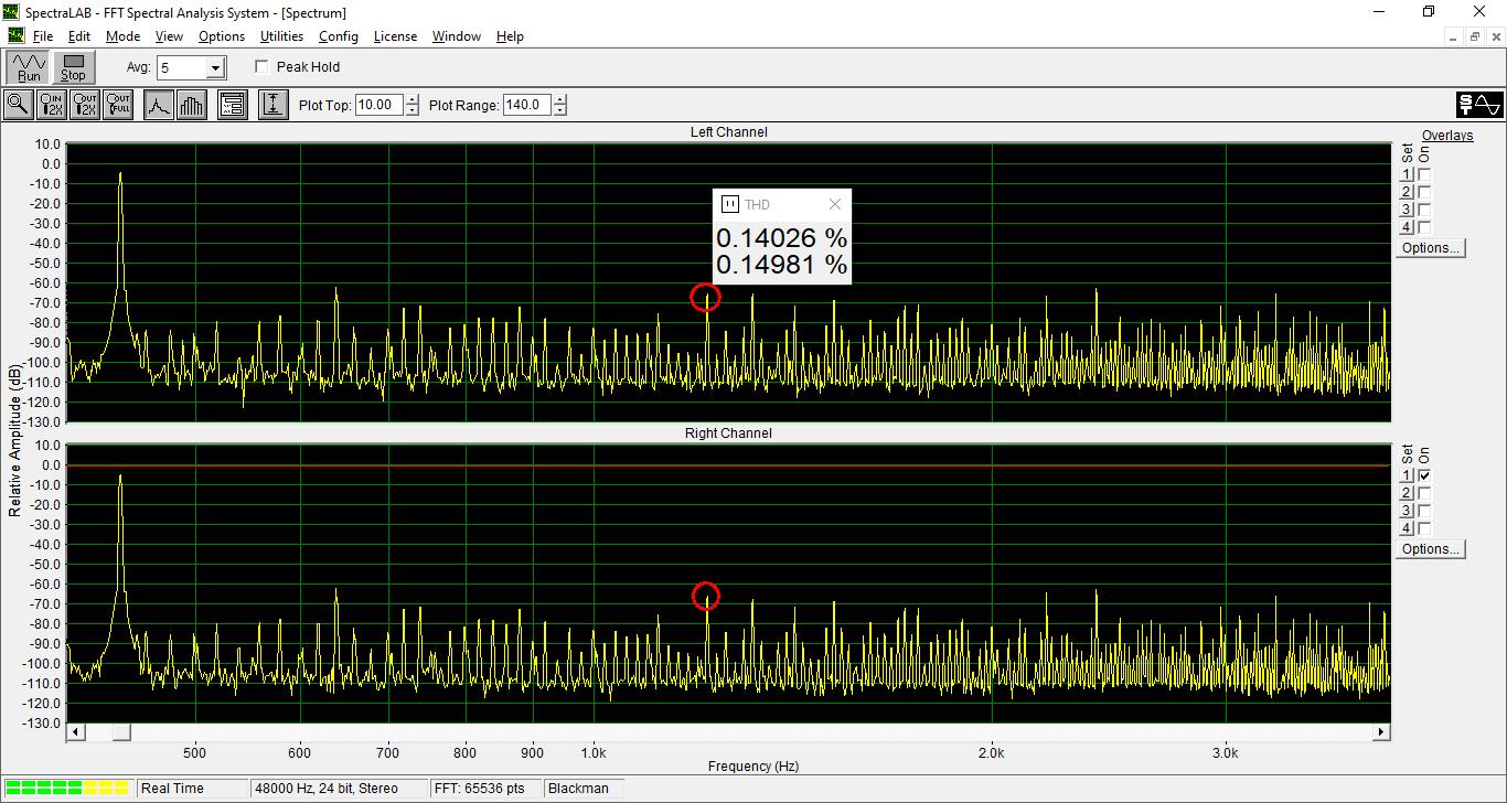

I built a sine generator that sends 440 Hz -60 dB I2S signal, digitally generated. I measured a TDA1541A in-situ, and the THD was around 0.15%. The 3rd harmonic component dominated.I want to know, what is the minimum possible THD at -60db level for 16 bit DAC?
I did not apply any dither, because the 440 Hz sine and the 44100 Hz sampling rate are not harmonically related.

Is it possible to reduce the "fur" in the spectrum? I tried 1k + 150pF filter in the digital inputs with very minimal effect.
When I stop the input, the spectrum is clean.

They have a beat frequency of 20 Hz: 22 times 20 Hz and 2205 times 20 Hz. You see all multiples of 20 Hz in your measured spectrum due to the lack of dithering.
Even without any such relation, you would still get harmonic distortion when you don't use dither. Just imagine you pass a small sine wave through a coarse quantizer without any sampling: you change it from a sine to a periodic staircase-shaped waveform, which has harmonics in its Fourier series.
How do I implement the dither? I generate the I2S with ESP8266. Is it a random 1-bit amplitude digital noise?
You calculate the sine with high accuracy, and then you add n independent uniformly distributed random or pseudorandom signals with a peak-peak value of 1 LSB of 16 bit before rounding the sum off to 16 bit. You also have to make sure you don't get overflows.
n = 1 suffices to get rid of the distortion peaks in the spectrum (the ones due to rounding to 16 bit that is, not those due to DAC imperfections), but n = 2 is more usual for audio because it also makes the RMS value of the requantization noise independent of the signal.
