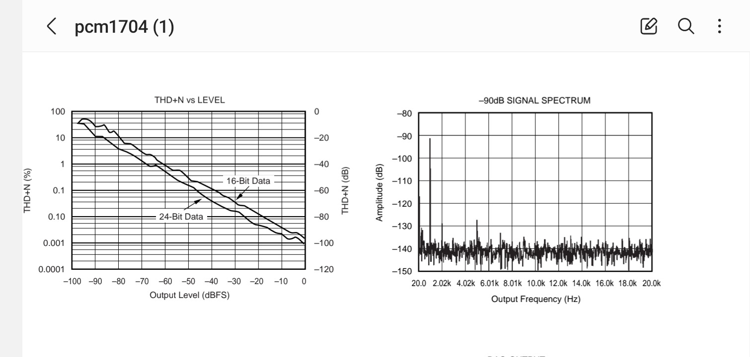

When sampling, the error of the output is +/-0.5LSB, forcibly there is distortion even if the DAC is perfect.

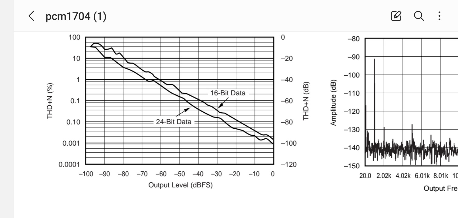

The lowest I found in datasheets is that of PCM1704, it says 0.9% with 16bit data, when it is 0.6% with 24 bit.

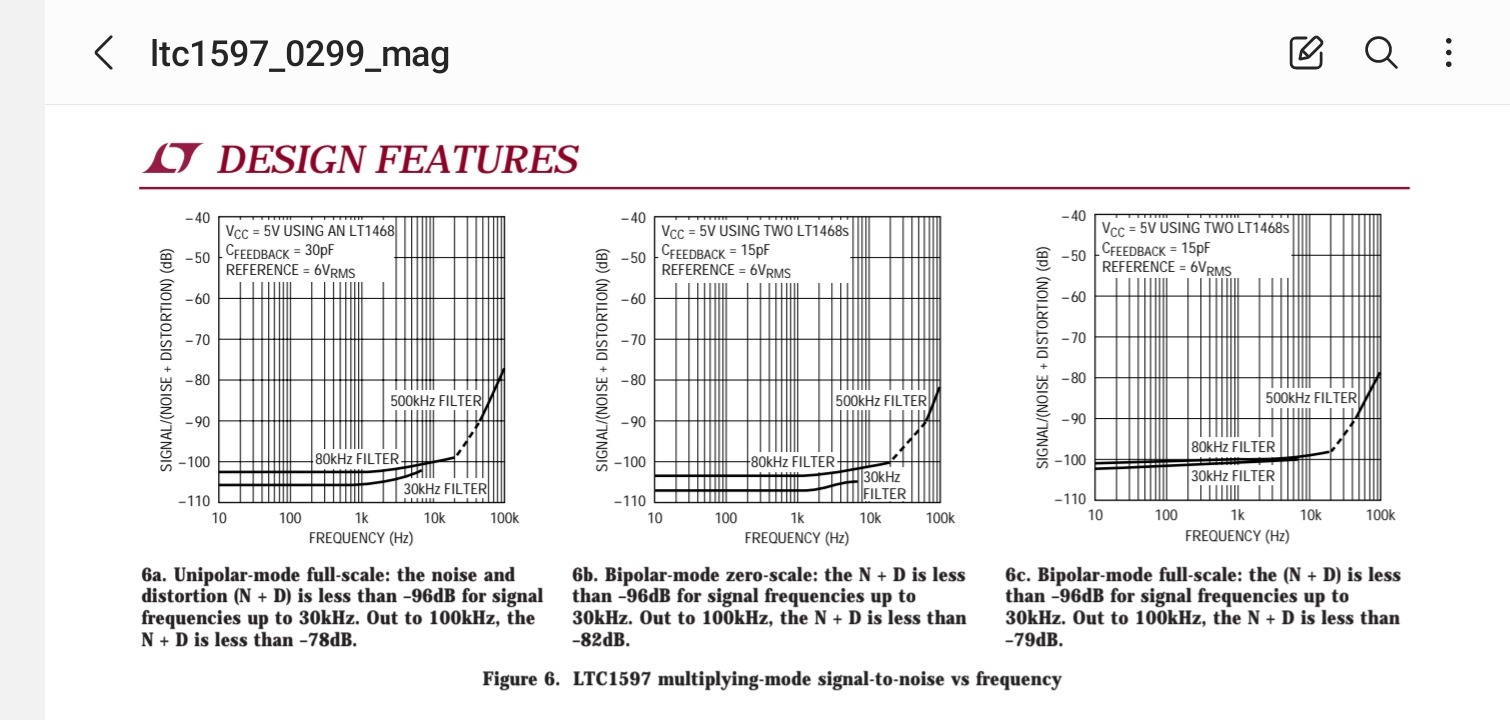

A very linear 16bit DAC the LTC 1597 has a distortion lower than the 24 bit 1704, I wonder what it is at -60db.

I think I remember from college SINAID for a digital representation is 6db x #bits, so 16 is 96 referenced to full scale ideal. Looks like the pcm1704 is close to perfect. At -60db signal level, SINAID will be 36db down from the signal. A 24 can ideally do 144db, but most only achieve somewhere between 18-19 bits.
This what I also thought. -60db is +/-32 levels that is 6bit definition, so the minimum THD should be -36db. The 1704 shows -42db, this what made me ask the question.
You are still mixing up THD+N with THD.
Regarding undithered THD+N with a perfect DAC, you get 1.76 dB extra because of the differences in probability distribution between sine waves and quantization errors. Besides, you get some decibels extra when you don't measure over the full Nyquist bandwidth, but something smaller.
With triangular dithering, you lose 4.77 dB, but the quantization error then behaves very similarly to additive noise.

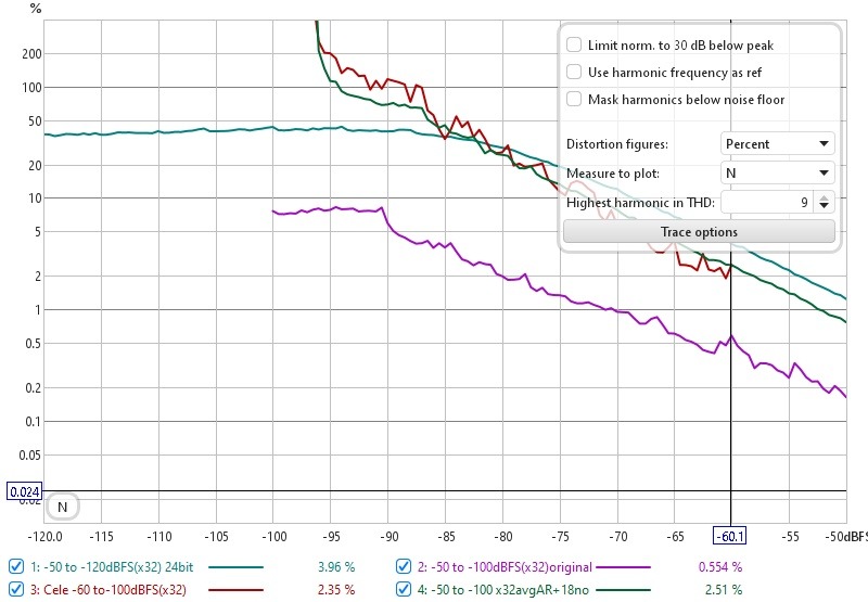

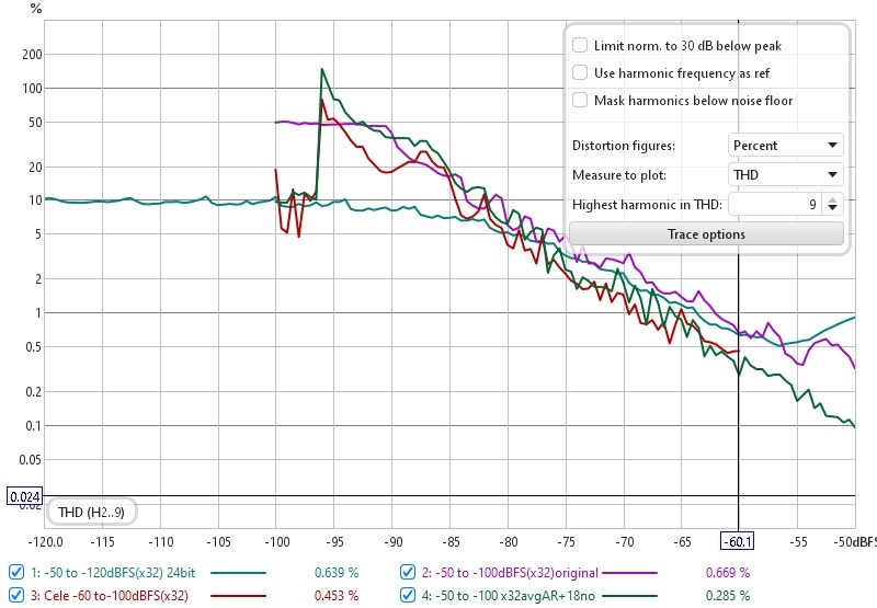

I want to know, what is the minimum possible THD at -60db level for 16 bit DAC?
From some 1kHz step level measurements I have made, THD is btn 0.28% and 0.7% at -60dB level.
Noise is btn 0.5% and 4%
All these DACs are based on TDA1387 (Abraxalito's implementations)

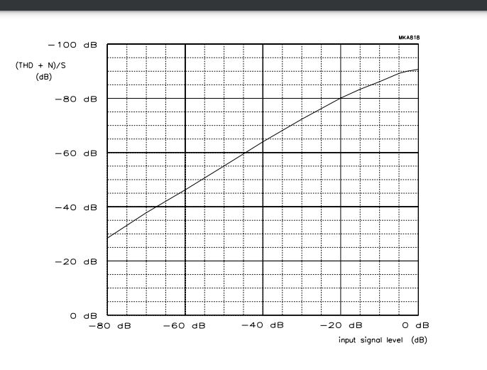

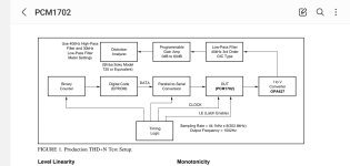

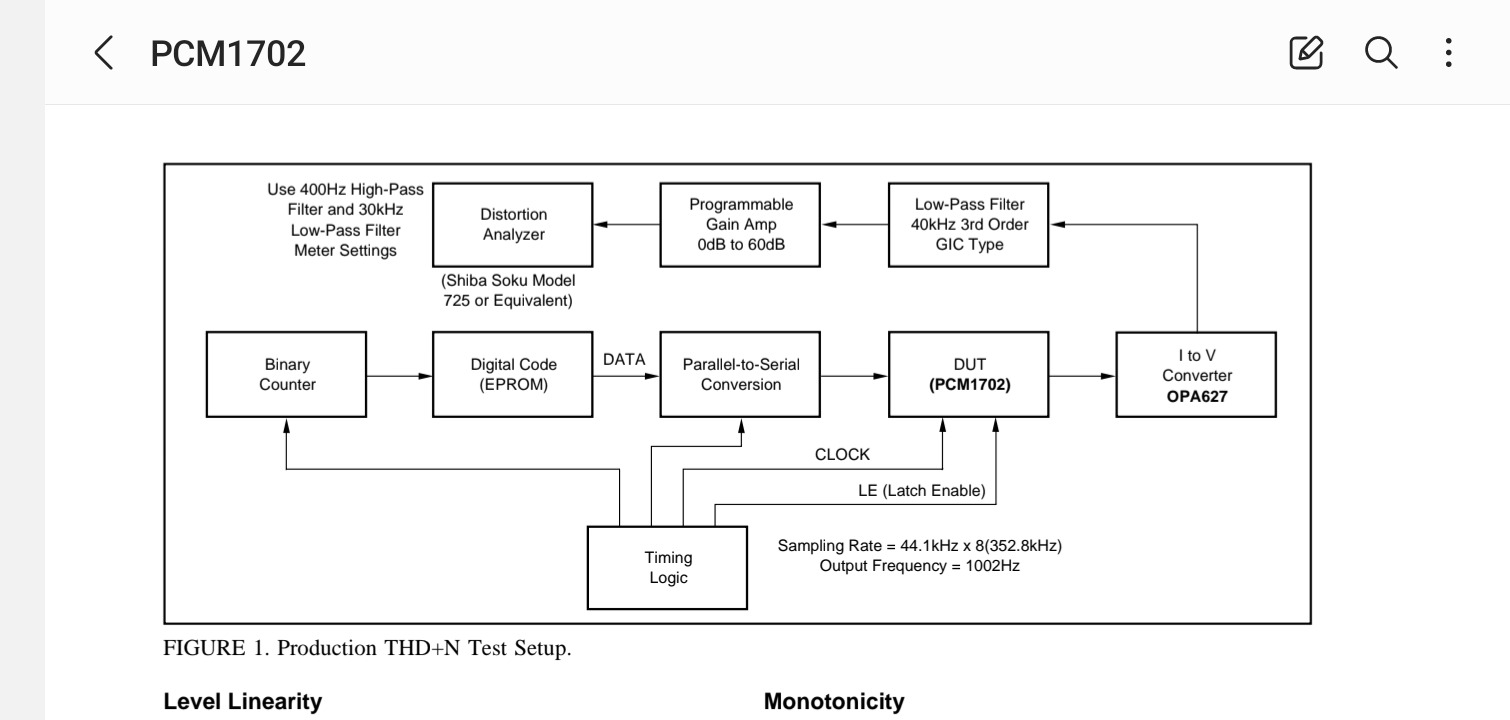

To compare apples to apples, the measurement of pcm1704 probably is similar to 1702 shown bellow is filtered at 30khz and not dithered. Whereas the tda1387 is typ. 1.7% THD+N with 80khz maybe 1.5% with 30khz. This meanes only -6db decrease can be hoped from modding the TDA.
What I find sad that paralleled DACs measured by George doesn't decrease the noise. Normally, every doubling the number of DACs, the noise should decrease by 3db.

What is wrong about George's measurements, he uses dithering option in his generator. This input noise is decreasing the THD for sure as Marcel explained but increasing considerably the overall noise. As the dithering noise is in the recorded data, it is useless to go low noise audio DAC. This means paralleling DACs doesn't pay specially if your estimation of noise digital nature, doesn't decrease.

If I find George's measurements wrong because it doesn't compare apples to apple but what in real world one will get. By this we can't know by how much better he got by using 32// DACs As I mentioned, according to his measurements, there is no any need to look for low noise DACs.
