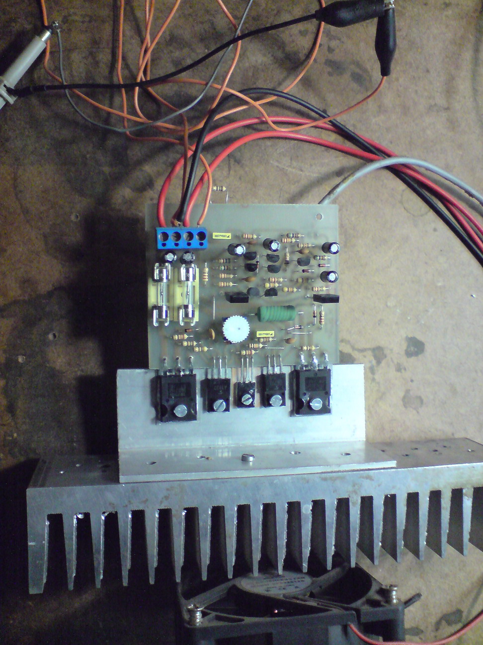

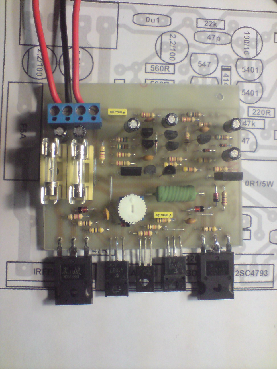

NX-14 Completed
Hi Apex,
I completed my first NX-14 yesterday, I post some pics here. I also completed the PSU + Protect. I have a problem with my NX-14. On power up, +30V-30V used, I measure +10V dc on the output. I cannot set the bias current. Turn the pot but nothing happens. There is no short as my power supply is not limiting. I will do some troubleshooting tonight and double check every thing....will keep you posted.🙁🙁🙁

I think I found my problem.....After reading your other post in 100Watt HiFi amp, It seems like I have to connect a seperate wire from input ground to power ground. Will do so and test again tonight. Will let u know on my progress.

no...........I have to connect a seperate wire from input ground to power ground.
Connect the Signal Ground (Input Ground) to the main Audio Star Ground.
Connect the Power Ground to the main Audio Star Ground.
Connect the Speaker Return to the main Audio Star Ground.
Connect Chassis to main Audio Star Ground.

Amplifier must have connection from input GND to PSU GND or you can put 10R resistor in parallel with C13 (100nF) for the test.
If you can't set the bias current, replace R17 1k with 470R. Trim pot 1k set at maximum value (1k), turn it down to set bias.

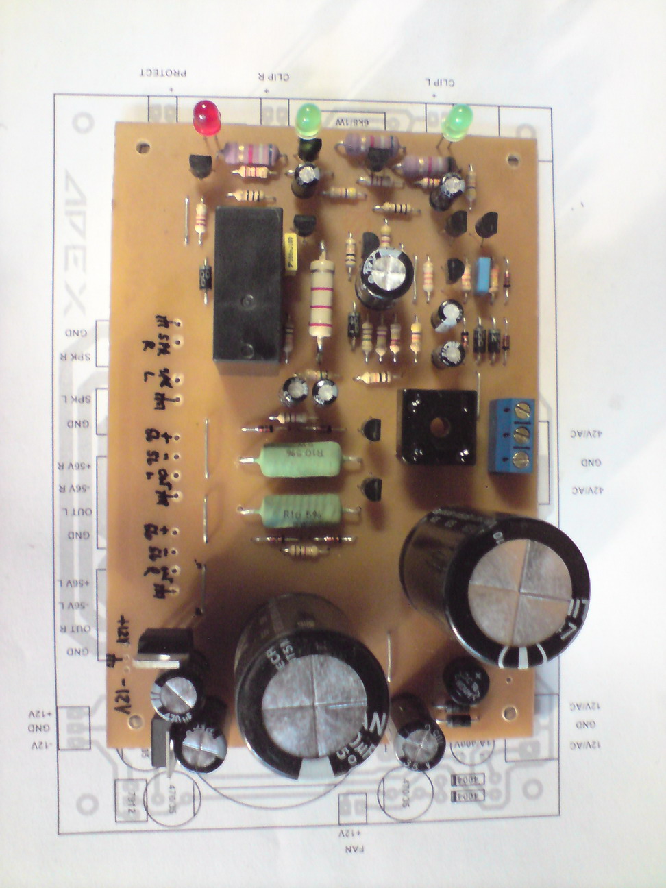

For +/-30V resistor 1k2/2W on protect pcb must be replaced with 470R or lower if you want 24V on relay, or you can use 12V relay and find serial resistor value to get 12V on relay.
Thanks Apex.....but I have a +/-50V 10A toroid for my amp.I tested it with my PSU+Protect and all seems okey.... I connect this amp to +/-30V from my bench PSU to test amp first and if everything is okey.....I will connect amp to

RE... NX-14 Completed
Hi Apex,
I connected 10R in parallel with C13(100nF) as you suggested.....DC on output is gone. Replace R17 1K with 470R and still cannot set the bias current. Turn pot and nothing happends.....I then connected test load.....put some music on and check with my scope the output....sound was playing. Mounted the amp on heatsink......put test speaker on...connect sound and sound was playing.....one problem.....the sound is a bit distorted......I do not know if this is because of the bias problem or the low voltage that I am using....(+/-30V)......I want to connect my transformer and PSU+Protect today and test again.....Do you have any suggestions on how to fix bias problem......do you have a schematic with voltages for me to do some measurements........can I go forward and connect my transformer to with this amp.......I am planning on building the second channel this weekend an will see if I get the same results.....will keep you posted on om progress.....

Low voltage can't be a problem. You can do some measurements:
DC voltage on resistors
R4 (560R) 0,6V
R14,R15 (220R) 1,2V
R20,R22 (220R) 3,5V

Hi Apex....
If these voltages are okey......can I go forward and connect my transformer.....I must say that the sound is very good.....just that the bass or low freq distorts a little.....any other suggestions......to fix my bias problem.....

Yes, but try without 10R, use separate wire for input GND, and put zobel network on speaker output (5R6/2W, 100nF).
