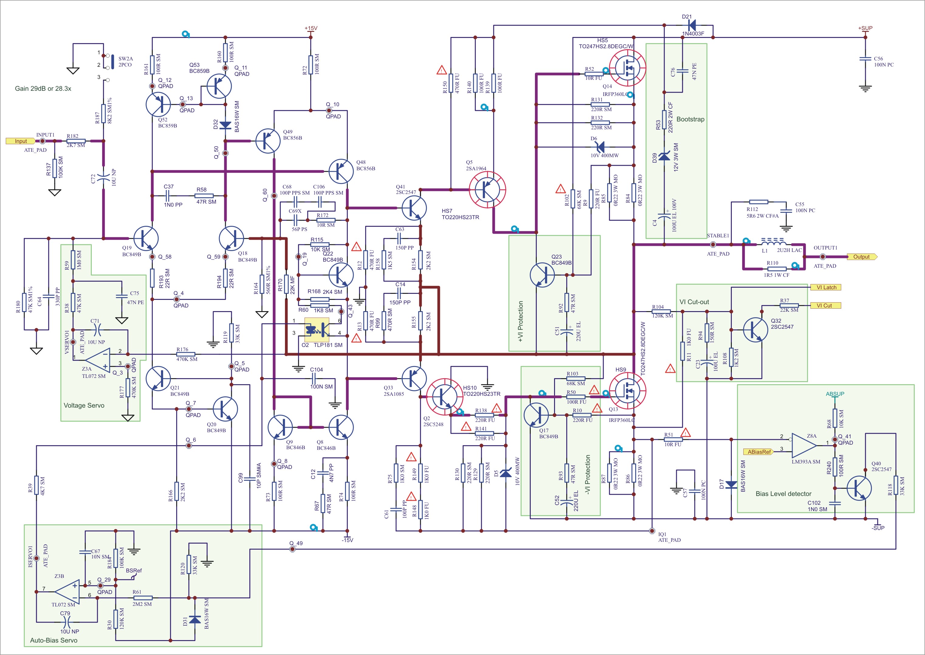

Perhaps just D1 put in opposite direction?Try adding another diode in parallel with D1 but in the opposite direction 🙂
I will remove RC, and do make some test, thank you Wahab.
what is the purpose of these two opposite-parallel diodes ??
The diodes reduce the amount of time that the output remains stuck to the rails after clipping. This is achieved by preventing the voltage across C3 from deviating too much from what it should be when the amplifier is into linear operation.
Without diodes, C3 is charged and discharged in an uncontrolled way during clipping, and the output will remain stuck to the supply rails until the voltage returns to the normal value (which takes some time).
Thank's to Eva, schematics is in post #31. This is condition of overload with hard cliping (more than 10%THD), not usual home listening.The diodes reduce the amount of time that the output remains stuck to the rails after clipping. This is achieved by preventing the voltage across C3 from deviating too much from what it should be when the amplifier is into linear operation.

and what if i dont use C3-R5??most schematics i have seen, dont have this network.
will i have to use these diodes again?
Don't change anything on this schematics, it just look like "most schematics" for diy, but take a better look, this is high performance amplifier, and you must use C3-R5, don't try to make it simpler, it is imposible if you want to have better amp than "most".and what if i dont use C3-R5??most schematics i have seen, dont have this network.
Regards
C3 and R5 are part of a pole-zero compensation system.
The advantage of pole-zero compensation is higher open loop gain at mid-high frequencies, which translates into lower high-frequency distortion and lower output impedance, without any substantial degradation in stability. The usual rise in output impedance and distortion above 1khz in traditional amplifiers is moved upwards, it does not start until a higher frequency (may be as high as 20khz resulting in flat THD and constant damping factor, which makes the amplifier closer to "ideal").
Pole-zero compensation is rarely used in DIY amplifiers because it's a bit more complex than the traditional dominant pole compensation and harder to implement for people with no knowledge about feedback control loop theory (or even without an oscilloscope).
