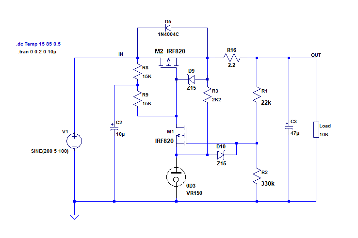

OK, here's a stab at adapting the feedback (series) regulator. Attached schematic. I took a quick read through the thread about high voltage regulators and tried to apply the protection parts from there. I'm not sure about R16 (2.2R) or D5 (1N4004 from drain to source of M2). Otherwise I just added two 15V zeners from gate to source of the two IRF820s.
R1 and R2 values needed to be adjusted for 162V out. I suppose a pot there would make the regulator adjustable. Maybe a 25k pot so that I can fine-tune it on test?
I expect I've missed something, or goofed something up...
As drawn, R16 serves no purpose, it waste a bit of heat and slightly increase the output resistance, but fundamentally it poses no problem.OK, here's a stab at adapting the feedback (series) regulator. Attached schematic. I took a quick read through the thread about high voltage regulators and tried to apply the protection parts from there. I'm not sure about R16 (2.2R) or D5 (1N4004 from drain to source of M2). Otherwise I just added two 15V zeners from gate to source of the two IRF820s. .
Using it for protection would make it useful: either with the cathode of D9 returned to output, and values adapted, or with a small sensing transistor.
The latter has my preference, because it is minimally intrusive
Yes, place a 10 or 22K trimpot at the junction of R1 R2, wiper to the gate of M1.R1 and R2 values needed to be adjusted for 162V out. I suppose a pot there would make the regulator adjustable. Maybe a 25k pot so that I can fine-tune it on test?
D5 is redundant, because it is in parallel with the much larger body diode of the MOS.... but it does no harm.I expect I've missed something, or goofed something up..
Otherwise, the circuit looks OK.

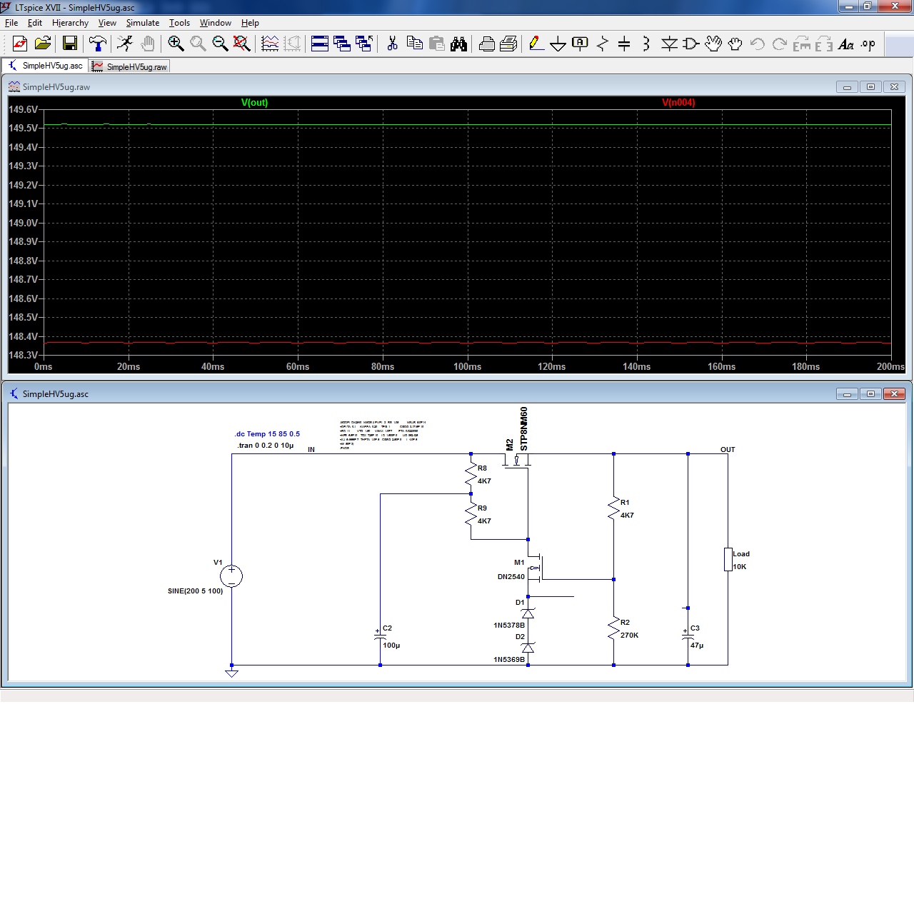

If one wanted to convert the regulator to true unity gain, that wouldn't be possible without resorting to additional translations, not attractive.
However, if a residual gain of 1~2% beyond unity can be tolerated, the problem very much simplifies itself:
The two traces show the output and refence voltages: it is minimal.
The bias of the VR tube with a resistor is no longer possible, so R8 and R9 have been reduced to make up for the missing current.

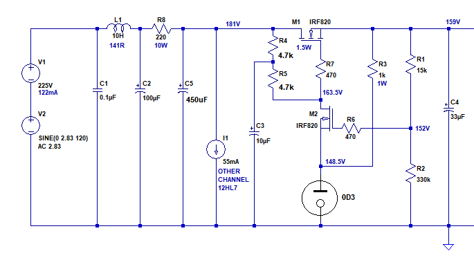

No, I meant the whole thingy. I did not look carefully and did not realize that M2 is a source follower, so everything is fine.
With the series feedback regulator, is it normal to have some high frequency hash showing up on the power supply rail coming from the voltage reference? It seems to appear in the simulation whether I use zener diodes or I use an 0A2 (Stephie Bench's model).
I've attached the .asc and the 12HL7, potentiometer and 0A2 model files so you can see what I'm seeing, or if you feel so inclined, correct it.
I see about 200µV pp of signal correlated to the signal of the subsequent amplifier, nothing out of ordinary IMHO.

I hope it's OK if I pester you with a couple more questions...
Referring to the attached schematic:
1) I got confused between my original circuit and your modification for more feedback/lower gain, and I wired in 4.7k ohm resistors for R4 and R5 (they're 15k in the previous schematic) but left in R3 (the current setting resistor for the VR tube). In simulation the only difference I see is about 1.5mA more current drawn by M1 and the VR tube, but no change in performance. Do you see a problem there?
2) Assuming R4 and R5 being 4.7k ohms is OK, what pole is acceptable for the low pass filter formed by R4 and C3? That looks like a decoupling network for M1, with R5 as the drain load resistor. Am I close?
If that is the case, then we'd want R4/C3 to attenuate frequencies down as low as possible. If I'm using 4.7k for R4, do I want to use at least 22uF or 33uF for C3? Or would 10uF still be OK there?
3) What value of capacitor is appropriate for C4 (shunting the regulator's output)? Would 10uF be fine there? Or do we want more, like 47uF?
Would making C4 a film capacitor be beneficial? If so, what value cap is too small?
4) As you can see, I removed R16, and I've left out the diodes D5, D9 and D10 from the previous schematic.
