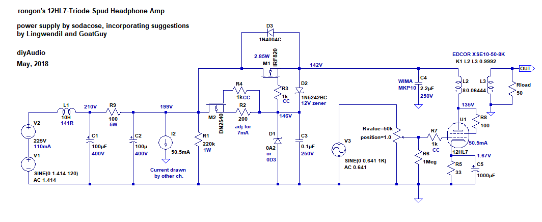

The design of the power supply for this idea would be:
- Choke input using 10H 141R and 330uF 400V electrolytic (because I have a couple),
- maybe something like 100R 5W and 330uF RC filter after the choke input filter,
- After that, each channel would get its own "Simple VR tube regulator" as in sodacose's schematic,
- Finally, each channel would get a 10uF film cap from B+ to 0V as close to the tube socket as possible.
That ought to be very good, no?
Sodacose said:I'd say you'll be good with the suggested filter.
LOL ... Yeah, okay, point taken. 😀
See attached schematic. Does that look about right?

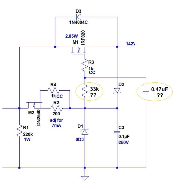

Lingwendil said:If you want a soft start feature you can add an RC filter in series with the gate resistor, with a largish resistor and a moderately sized film cap to ground you can play with parts values to get a nice ramp up feature that gives the VR tube time to settle.
That sounds like a great idea. But... questions:
RC filter = RC in parallel (tank circuit), or an R and a C in series?
Does the largish resistor go in series between the gate stopper resistor and the anode of the 0D3? And then the capacitor goes from jct of gate stopper and ramp-up R, to ground? Like in the schematic I've attached? (Which I doubt, but hey, I gave it a try...)

100k/1uF would be a decent start, or even higher, I've gone 100k/10uF before.

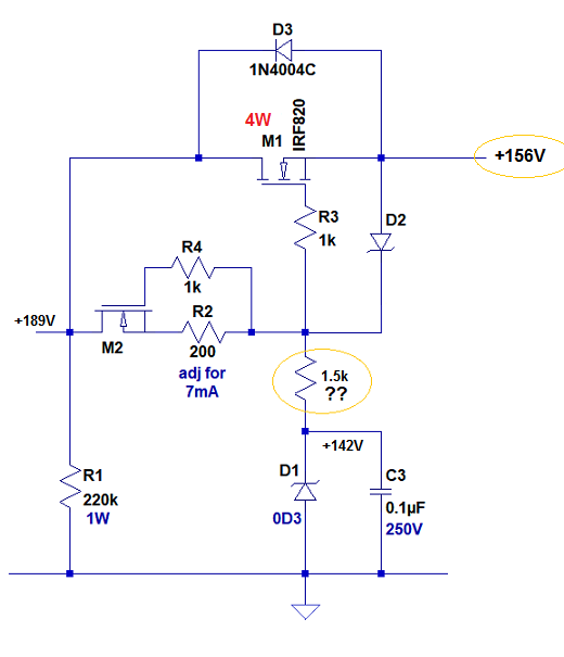

If I place a series R of 2.2k 'on top' of the 0D3, the output from the source follower increases to +156V, up from +142V (see attached diagram; note that it shows 1.5k for that R). This allows a bit more headroom from the amplifier, for when I use 300-ohm cans.
At the same time, if I were to install a 6AX4 or 6AU4 damper diode in series with the B+ before the choke, wouldn't that provide a slow enough B+ ramp-up for the 0D3 to stabilize? I have a 6.3V 2A winding available on the power transformer and an octal socket, both of which aren't being used at this point.
Another possible benefit from using a series damper diode is that it would allow me to use a single LC choke input filter with +189V out to the drain of the source follower IRF820 (and no RC stage after the LC). I could then use one regulator for both channels, and still keep the power dissipated by the source follower at an easy-to-deal-with 4W.
What do you think?

No comments on the series resistor sitting on top of the 0D3 to raise the B+ feed by a few volts? As in this:
1.5k is the value LTspice says would raise the B+ from +146V (a little too low) to +156V (just right).
Also, no comments about using a series 6AX4 damper diode to give soft-start to the B+? Would that make the series RC ramp-up filter unnecessary?

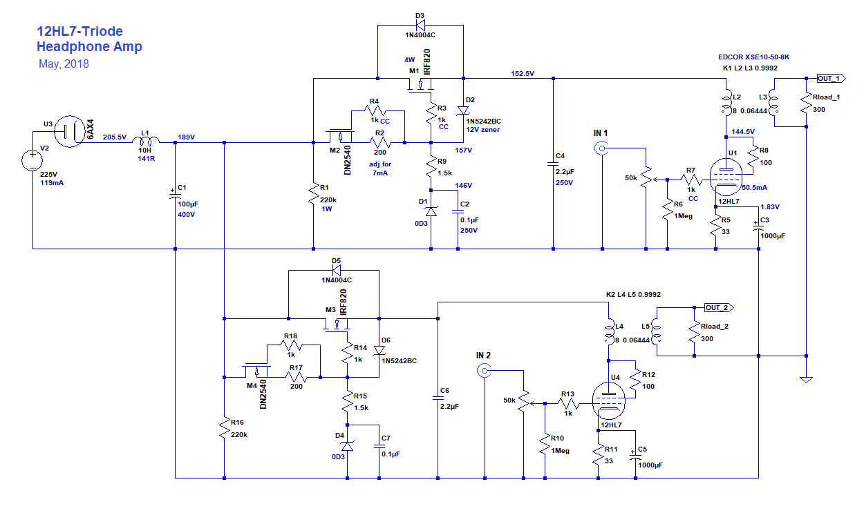

I've attached a schematic and .asc of the proposed stereo headphone amp circuit.

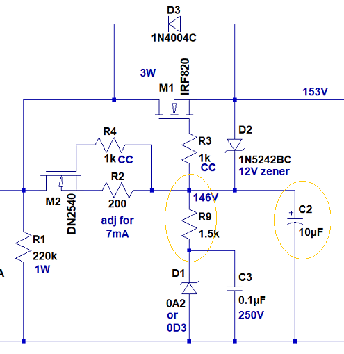

I would rather a pair of Zeners than the resistor, but with a CCS feeding either way is likely to be just fine.
As for the damper diode, I personally would prefer the RC filter, as it's one less filament to worry about. 1M/1uF or 100k/10uF would give you a couple second rise time, which should be plenty sufficient. You don't really, need it, but it's a nice feature to have.
Of course! Zeners! I'm such a dummy. Of course a couple of 5.6V zeners would be the answer. I have dozens of them. Used this way, they'd be dissipating very little power (5.6V at 8mA = 45mW).

I see your point, definitely. Thanks for sharing that trick; it's a good one. But I'd like to fill up the three pre-punched holes in the top of this ugly chassis with octal tubes of some kind. Two 0D3 and a 6AX4 would look nice up there, and I have the heater winding ready and waiting.
Or why not do all of it? Put in the couple of zeners to raise the B+ and the RC filter to ramp up the voltage slowly to the 0D3 and the 6AX4 in series before the input choke...

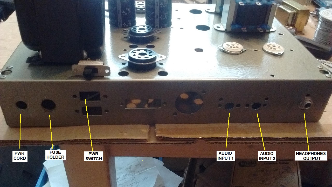

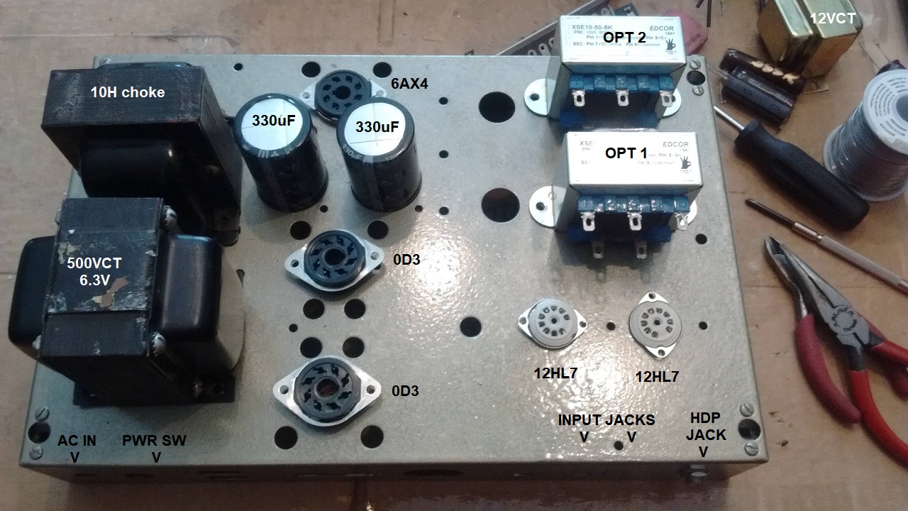

I need to spend a couple hours pondering the layout. I always screw up that part of the process. I need to wire up some perfboards with the MOSFETs and supporting passive parts, see how much room that will take up. Once that's done I'll be able to see what needs to go where. Hopefully I'll have a few hours I can devote to this over the weekend.
How big is the extra octal hole? You could stick a can cap in it. Shine up a motor run cap or something like that.
I should post a photo of the chassis. Oh wait... Here's one just like it:
It's got a lot of holes. I cleaned mine up and painted it bronze hammertone.

I got a moment to ponder layout issues. Here's what I have so far (see attached photos).
- The two Edcor OPTs will go underneath, in the positions shown.
- A RatShack 12VCT 1.2A transformer will also go somewhere underneath the pwr transformer and choke.
- I'm thinking of AC heating the 12HL7s. If that doesn't work out, I'll do the FWB rectification > LM317 thing.
- I think I can squeeze a vol ctrl pot in between the input jacks and the headphone out jack, on the front panel. Or I guess I could have it sticking up, in front of the two 12HL7s.
I'm open to any suggestions.
