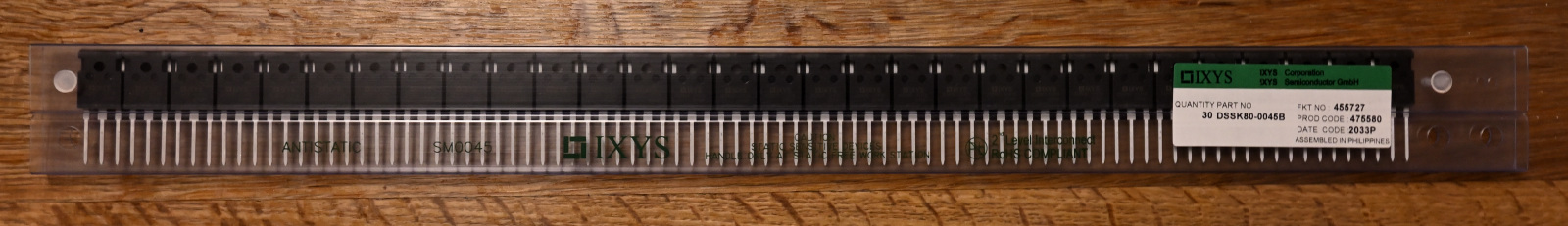

The PCB (Universal PCB from DiYAudio Store) has easy mount for TO-247 and the layout will parallel the two diodes in a TO-247 package with 3 legs.....without need for any bending of the legs. And the TO-247's is on the way to me.......

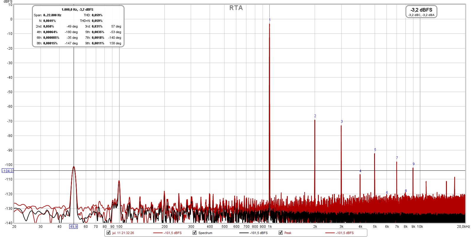

Here is a distortion measurement from the time where the SiC 600V, 14-15A diodes was installed (TO-220, 2-leg, single diodes).
Since then I have made improvements to get the 50 Hz peak lower and and a few other "improvements".....
Interesting discussion about odd harmonics.....I learn something every day!
From distortion measurement it can be seen that odd harmonics was less at that time.
I hope I can get that low again using the TO-247 Schottky. I will be satisfied if this is possible together with the much lower 50Hz peak I have now.
