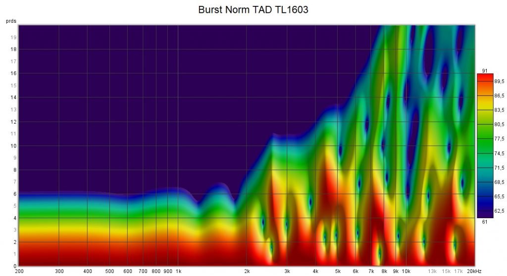

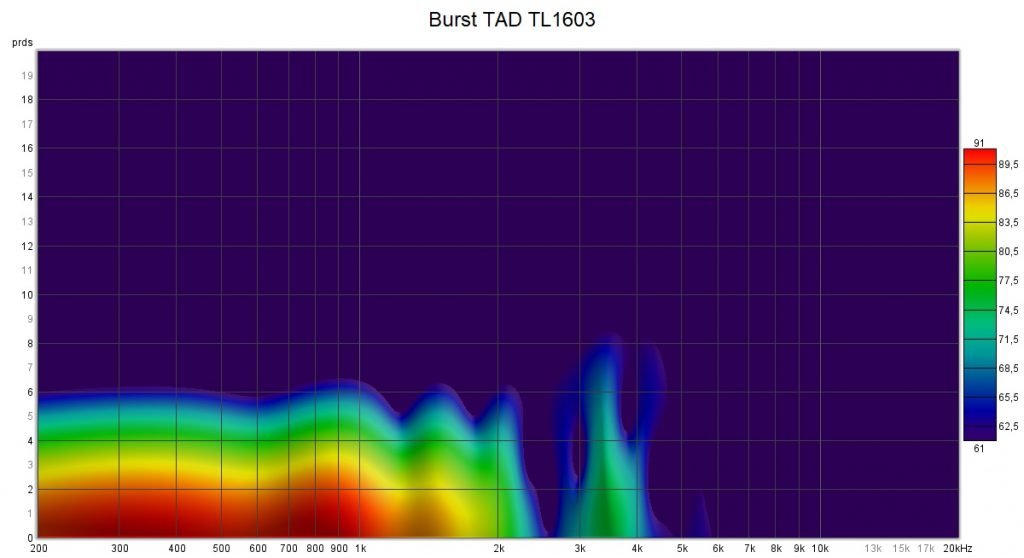

Yes, what you have : very high Le, one kilo cone, very low efficienty and just Xmax.... good for sub and infra bass. The problem is not to make the sound but to stop it without ringing till the next note I believe. High Vas, 15 to 16", 100 g, not stelar Le, a little effiienty, something 2.5" voice coil length ( ?)seemed to work fine (Altec, etc).
The sub with low Vas of SB Acoustic (the flats one) are imofor HT and high power active conf.

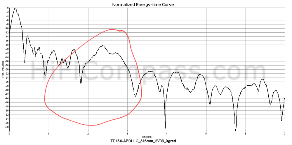

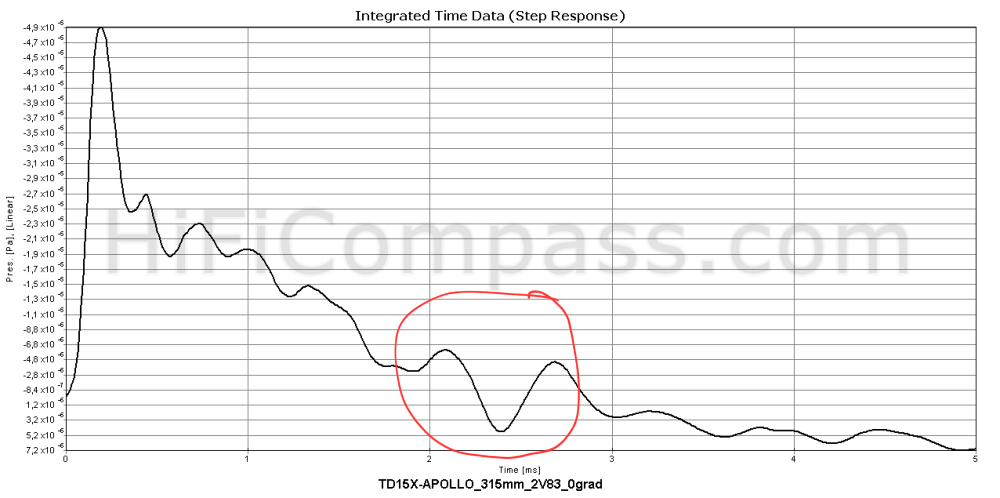

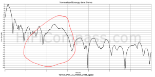

However, from what little measurements I've seen on these devices and the measurements I've taken of the TD15S cone resonances could be more of a factor at 400-500hz on larger Vas devices.
Has little to do with VAS.
It is the cone/surround resonance area of a typical 15".
Which has not been adressed in the driver design.
TAD and Fostex Laboratory (W), is about the only ones who does not show it, because of treated cones, damped surround etc.
Also a TAD recone kit is not a circle actually, which also helps.

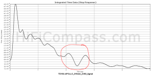

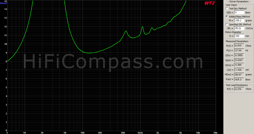

As for the AE TDxx. They have also got a anomaly in the impulse and ETC curves that should not be there (look at attachments).

Too much inductance seems to be a bad brake.
How is it much more of a brake then a huge inductor put in series to do the exact same thing?
Unless going active, the result is not all that different.
You just need a heap of passive xo parts to achieve the same as the coil inductance does more or less.
Taming the cone breakups and "pulling" the output down in level.
Not stating in any way that high LE is desireable obviously.
Older drivers made for a passive implementation the choice makes sense as one can get away with simple filters etc.
Yes, Klippel's distortion analysis for drivers point to it being a significant source of distortion in the driver.
But if the circuit it is connected through does the same?

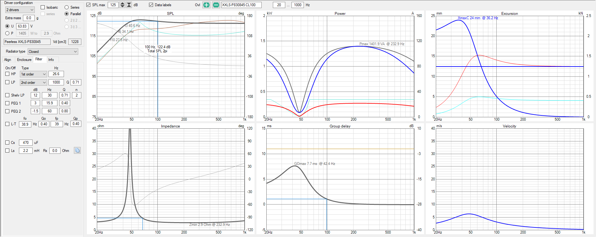

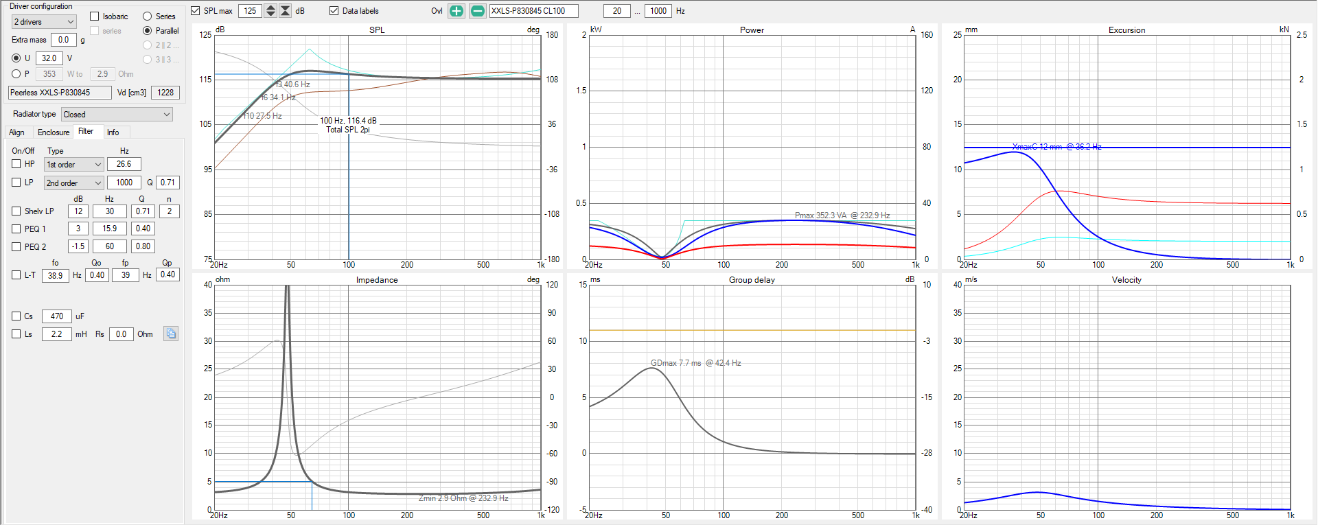

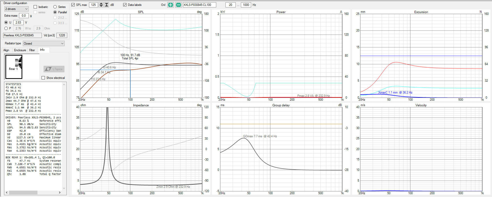

I also prefer sealed boxes. A pair of the above in 100L sealed box cabinets, 13 3/4" (35cm) wide. Note- below is with no EQ applied.
Sensitivity: ~91.7dB/2.83V (Ref 100Hz) /1m (brown line- 4pi)
Anechoic F3/F6/F10 - 43/36/29 (Hz)
Long term maximum SPL: >115dB in half space (black line- 2 pi);
based on IEC rated maximum power (350W), IEC weighted pink noise applied continuously for 100 hours, from 100Hz to 1KHz /1m,
x-max not exceeded.
Maximum short term sine wave output on-axis in half space, averaged from 100 Hz to 1 kHz at 1 m:
122dB
NB. Requires amplifier that can deliver 64V transients. Excursion still within the limits of the voice coil (<x-damage)
Pictures, or it doesn't exist?
from: https://www.diyaudio.com/community/...and-for-scanspeak-7-2-way.420013/post-7846629
It was desiGned to meet and xceed all specifications of 1238(1” tweeter + 5” midrange)A(+ 15” ported woofer) and AC (twin 10” ported woofers).

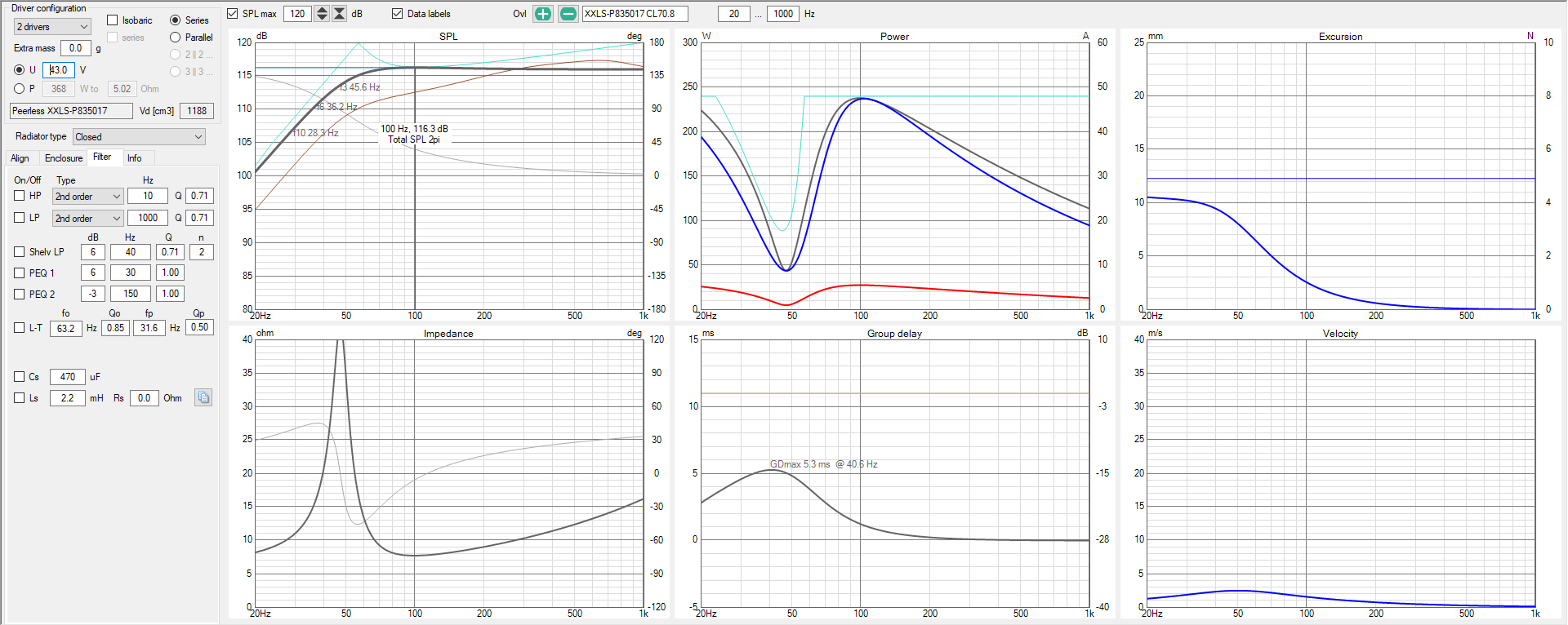

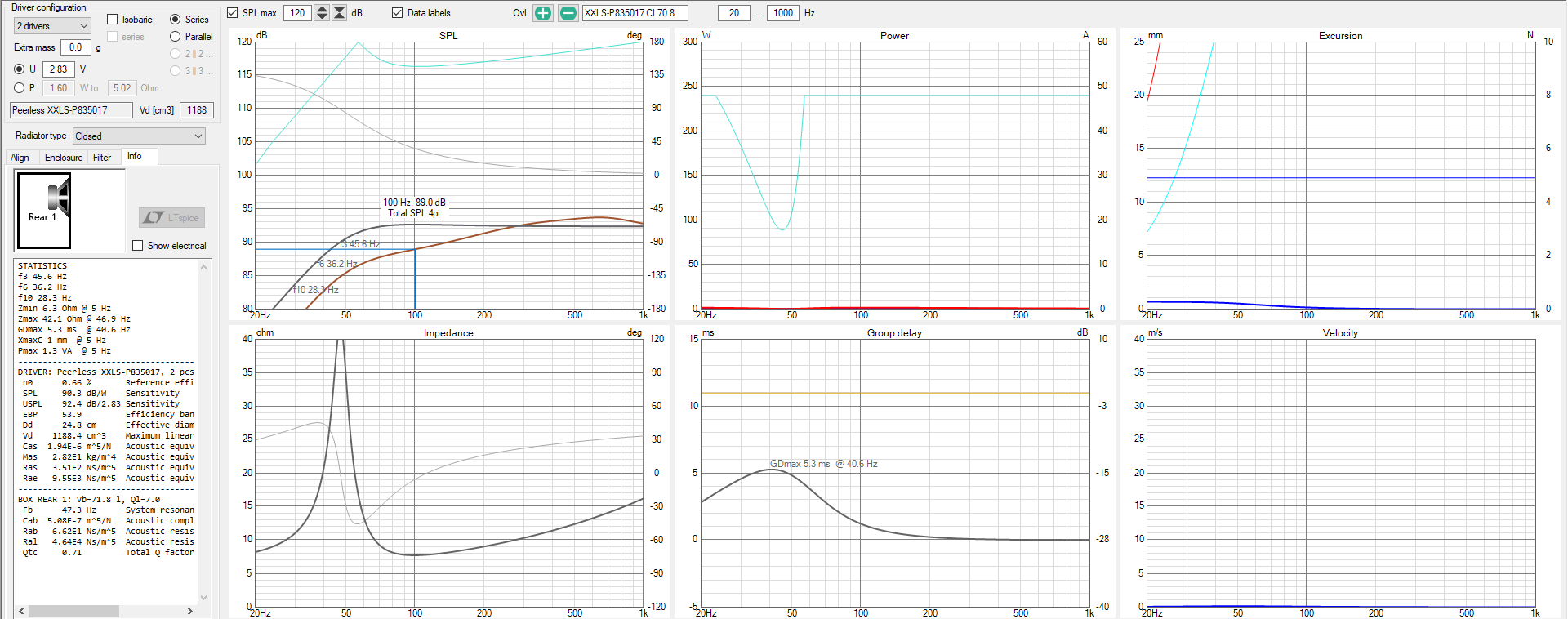

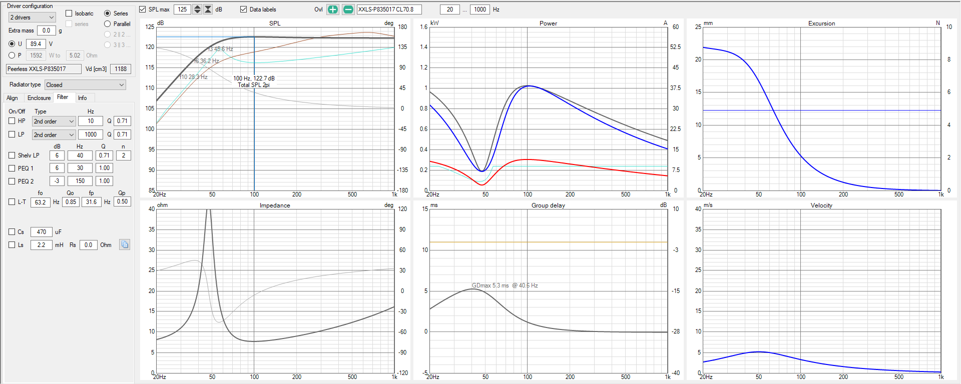

Another option of twin 12" woofers wired for 8 ohm nominal load:
Twin 12" alu cone XXLS P-835017 (4 ohm) wired in series
Sealed box, this time smaller volume 70L:
Sensitivity: 89dB/2.83V
F3/F6/F10: 53/41/31Hz
Long term maximum SPL: 116dB in half space (black line- 2 pi);
based on IEC rated maximum power (240W), IEC weighted pink noise applied continuously for 100 hours, from 100Hz to 1KHz /1m,
x-max not exceeded.
Maximum short term sine wave output on-axis in half space, averaged from 100 Hz to 1 kHz at 1 m: 122dB
NB. Requires amplifier that can deliver 89.4V transients (1kW into 8 ohms)

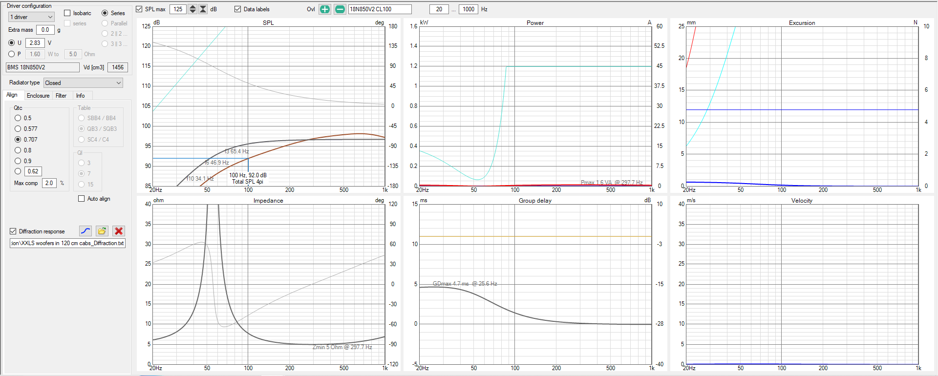

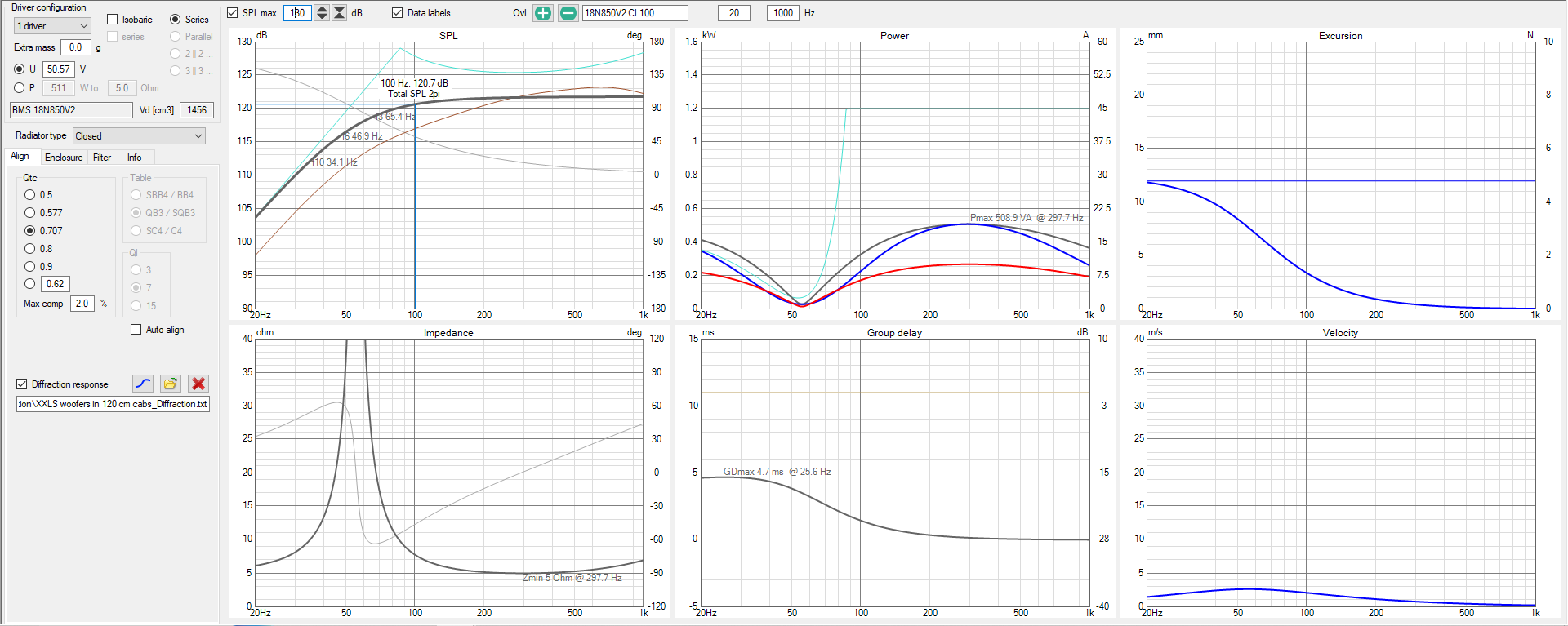

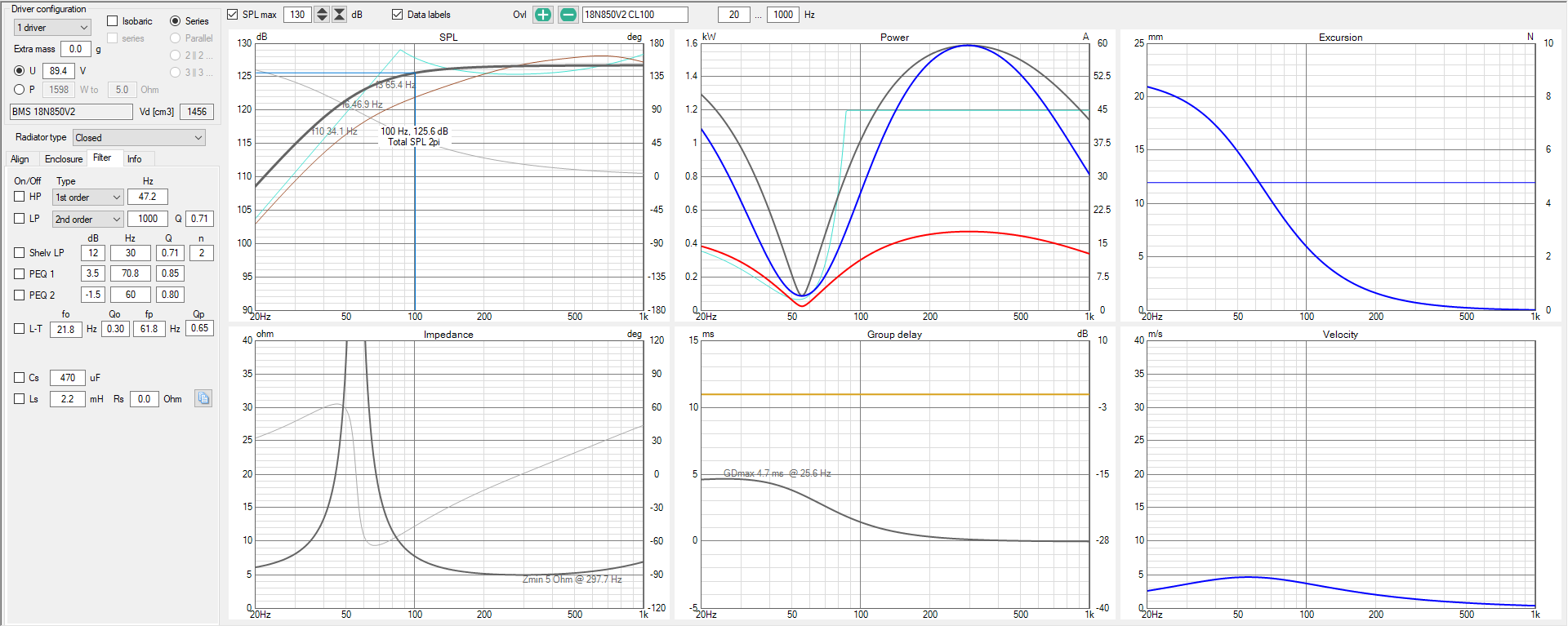

I don’t know why people recommend BMS…
Now I understand why:
Although not extending as deep, in a 100L sealed enclosure, has more than 4dB higher maximum SPL above 100Hz than a pair of 12” woofers with equivalent excursion.
Sensitivity
: 92dB/2.83V (Ref 100Hz) /1m (brown line- 4pi)
Anechoic F3/F6/F10 - 64/48/35 (Hz)
Long term maximum SPL: >120dB in half space (black line- 2 pi); from 100Hz to 1KHz /1m; x-max not exceeded.

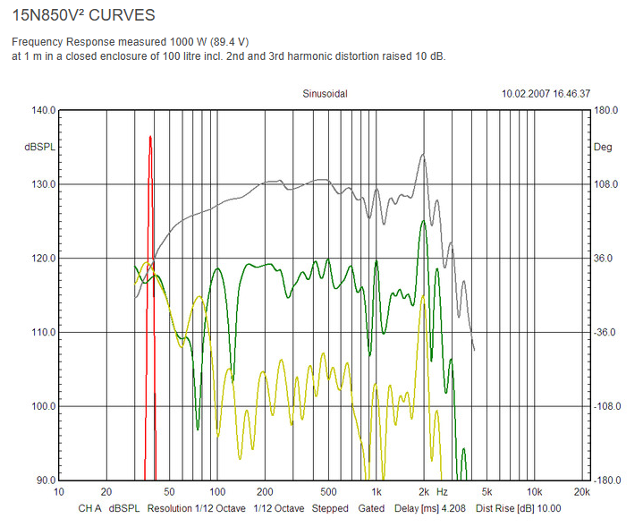

Here's it is with 89.4V applied, which is 1000W (8 ohms), close to 1200W AES noise power handling rating (applied continuously for 2 hours)
Max SPL for 100+ Hz: 126dB. Note: x-max EXCEEDED.
Here's BMS' own measurement:
Reference:
https://www.bmsspeakers.com/index.php-184.html?id=15n850v2_curves
