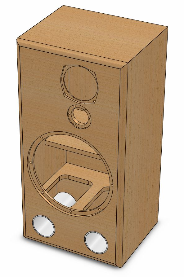

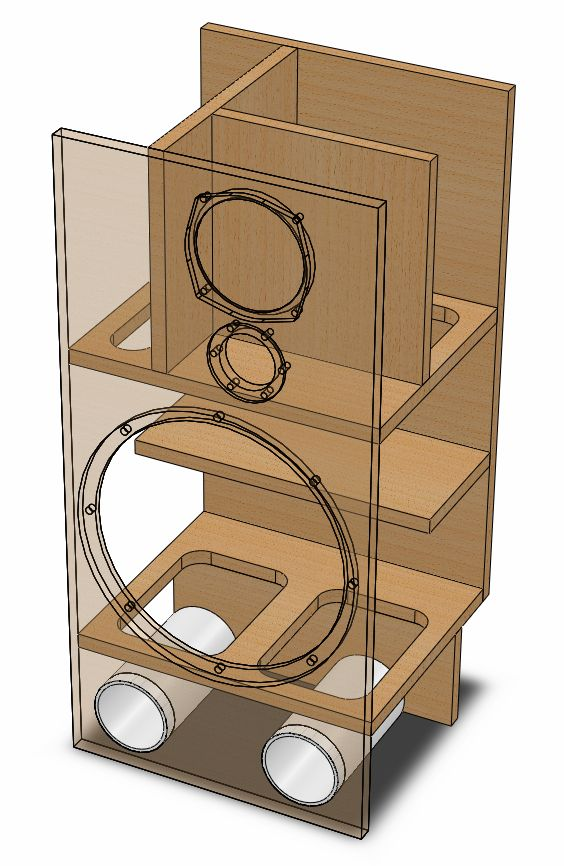

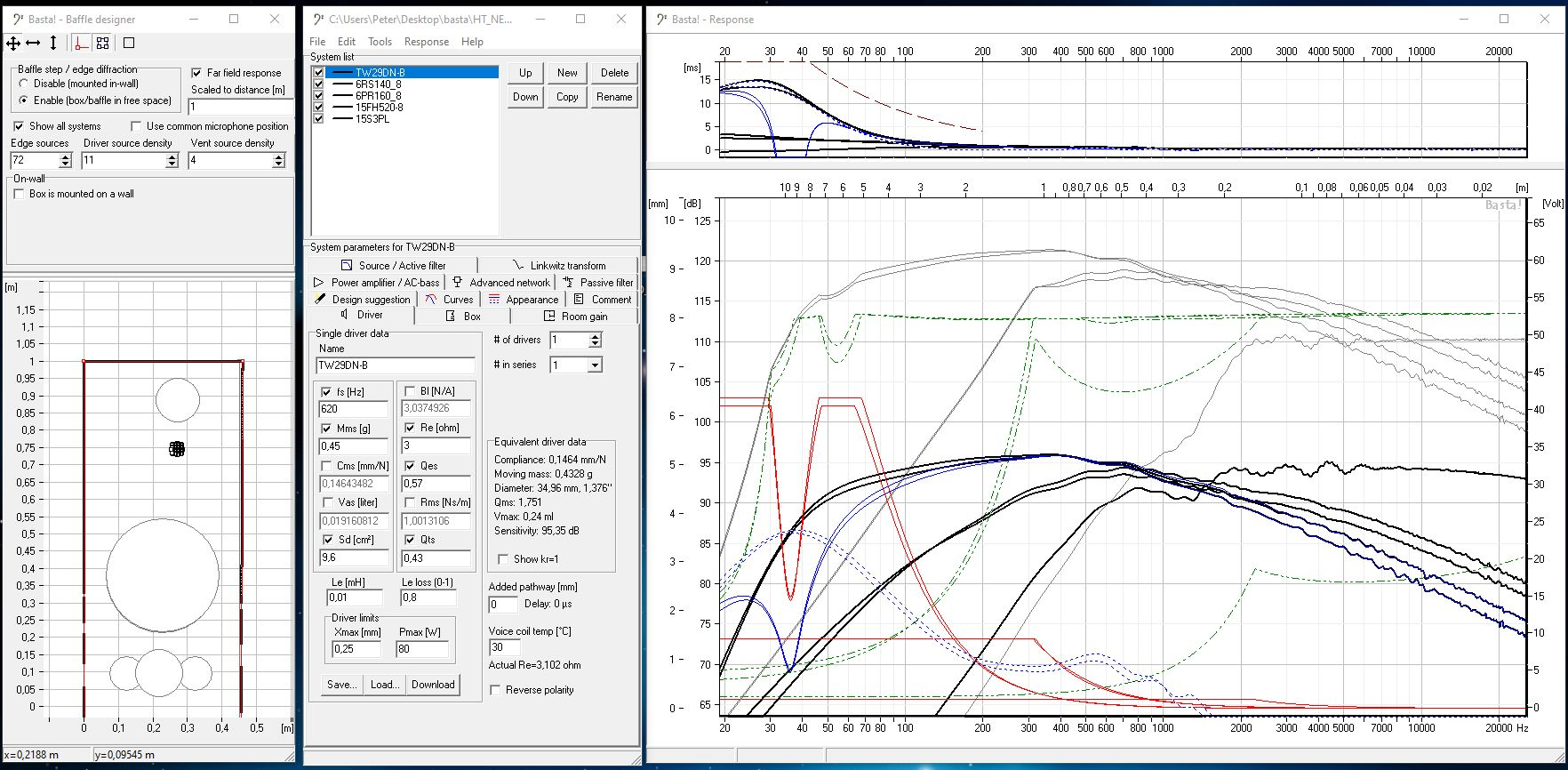

I had worked on a 15"/6"/1" HiFi speaker concept some time ago - never realized, had blown up the concept to 18"/8"/1" then - and intensive market research accompanied with simulations gave me following last selection as best compromise between TSPs, good value and features:
Sica 15S3PL
Faital Pro 15FH520
Both very low mechanical losses / very high Qm, low EPB for deep tuning and nice motors for the class.
(Enclosure volume in sim was about 120l, if I remeber correctly)
Another two options that look very good also, but only available from TLHP france:
https://en.toutlehautparleur.com/br...ker-kartesian-wom380-vtlhp-8-ohm-15-inch.html
https://en.toutlehautparleur.com/br...speaker-phl-audio-5510mnds-8-ohm-15-inch.html
Both specified and designed for Hifi-Application.
