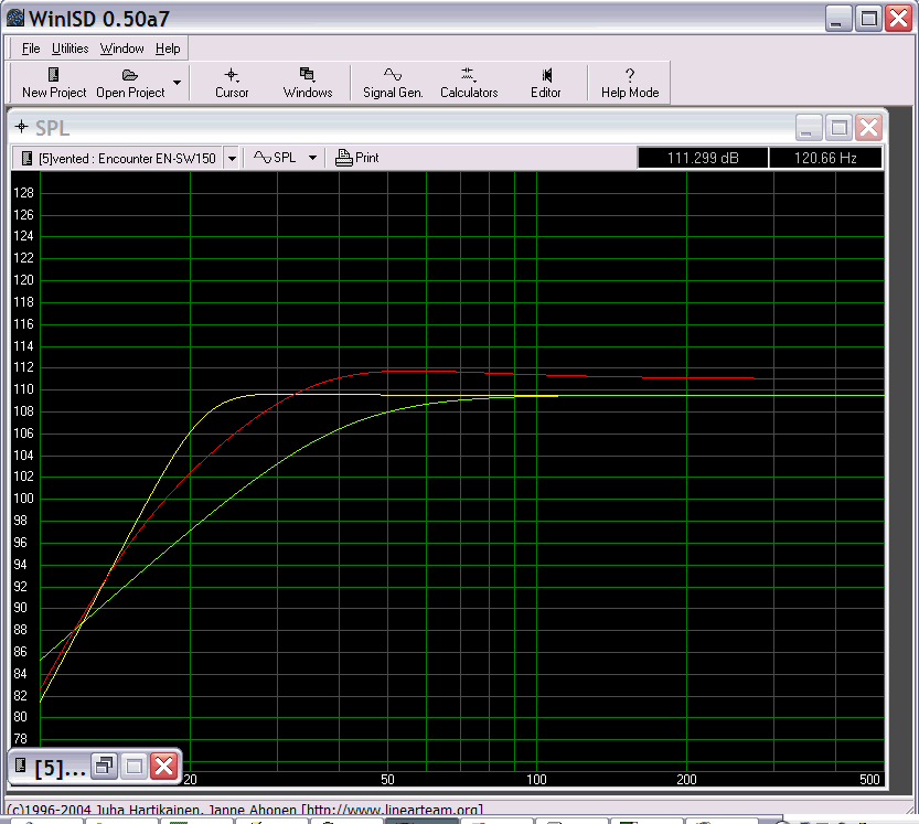

I assume this is for home HIFI and/or HT, so here's a basic T/S max flat alignment (yellow trace) since the sealed cab variant (green trace) has a rather high F3 of ~40 Hz:
10 ft^3 net Vb
22 Hz Fb
(2) 4" diameter vents 11" long
With its low Xmax it's only rated ~100 W down low, though considering its 23 mm Xmech and some room gain, it can be overdriven somewhat.
This is too big by most folk's standards, so venting the sealed cab to lower F3 a bit seems a reasonable compromise and allows for a slightly higher ~140 W rating down low (red trace):
4.71ft^3 net Vb
23 Hz Fb
(2) 3" diameter vents 13.1" long
Note that since there's no published inductance spec these are flatter than they will be in reality depending on how much it has and of course without measured specs may just be a 'pipe dream'.
I uploaded the WinISD driver file in case anyone wants to view the other graphs/whatever: http://www.hometheatershack.com/for...inisd-pro-files-fusion-encounter-en-sw150.wdr
