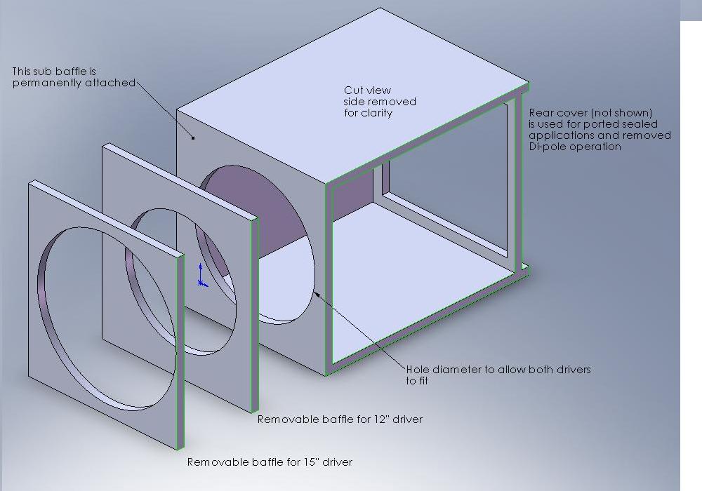

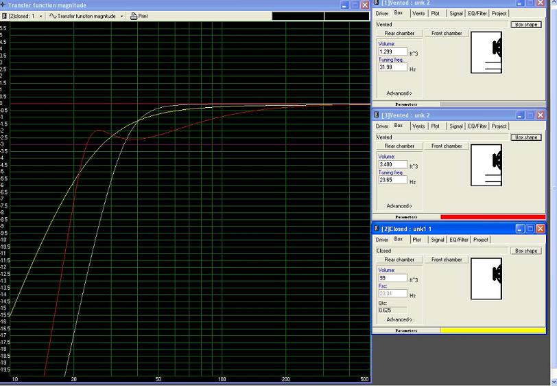

If you build a 17"x17"x22" box (external dims) with .75" mdf you will end up with about 3.2 ft^3 internal, this will provide an EBS3 alignment for the 12" with a 4" x 14.72" port rear mount for simplicity. If you use removable baffles (see following pic) you can use this for the 12 and the 15, which will be in a U-frame like mine which I am quite happy with. BTW U frames need to be kept away from the back wall, read the linkwitz website for more info.
The following winisd plot shows in gray a quasi-butterworth alignment for the 12 and the EBS3 (red) plus IB alignment for the 15" (yellow), just for reference purposes though.

Alright that pic turned out bad, the steep rolloff grayish line is the butterworth alignment, the other is the 15"
The next pic shows what I mean for removable baffles and such, this is not complete, you'll need to dimension everything and add bracing and such. But it should give you enough to get going on the "di" part of "diy" I think you will learn a lot from trying this project.
In addition if you use a shelf brace inside with a single large cutout (plus port hole) you can close it off and hear how the QB alignment will sound as well, all you have to do is locate the brace where it will create a 1.3ft^3 space in front of it.

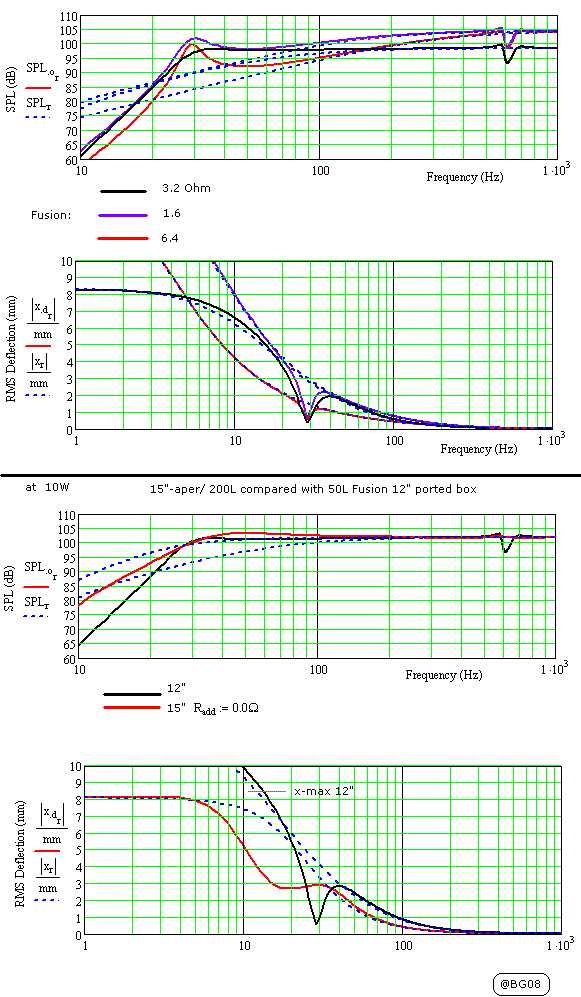

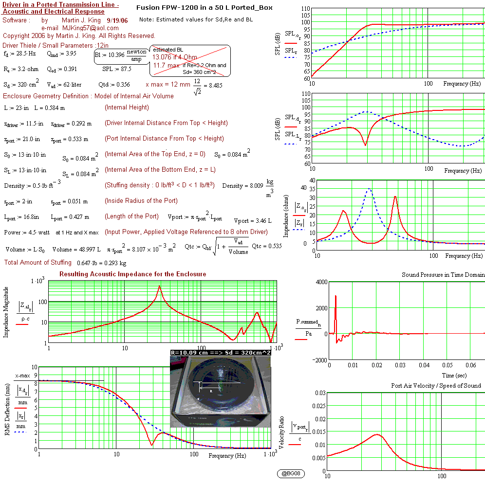

Chicho,FYI
Based on the given 12" DVC woofer data:
xmax=12
vas=62l
fs=28.5
qts=0.35
qms=3.95
qes0.391
See your 12” driver data somewhat expanded and simulated in picture 1(2).
If the referred TS data are true and collected when using one of the coils, the Qts value will be modified from 0.35 to 0.1853 when the coils is series or paralleled, also note that the coils in series will double the BL value.
If the driver coils are connected in series and parallel and put in a 50L ported box, see picture 2(2).
