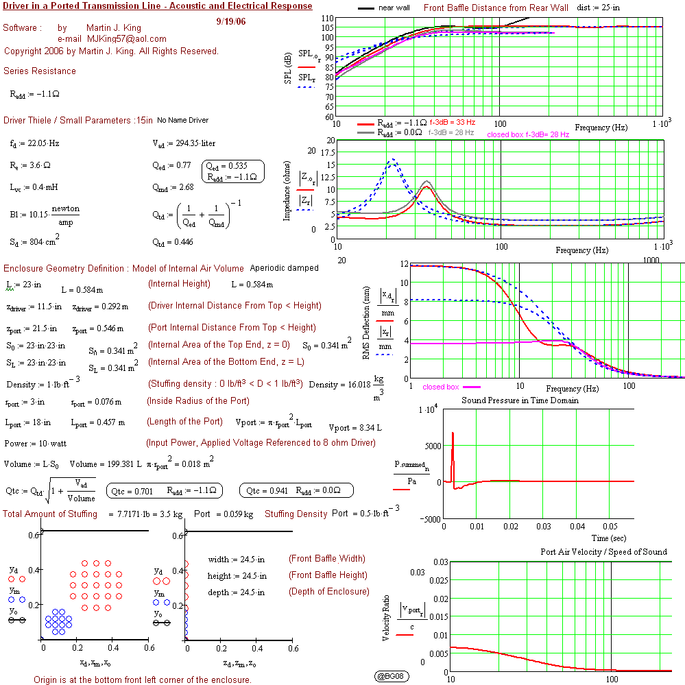

I too prefer the 15 but in general I am not a fan of highly damped drivers. If you need a little box then the 12 would seem the obvious choice but you will have to go ported to get reasonable bass out of it.
My quick modeling of the 12 indicates that with and extended bass shelf (larger than "normal" box with lower than "normal" tuning to extend bass response) you could get relatively strong output down to about 30Hz but then falling like a rock with 20Hz level down about thirteen dB and off the charts gone by the time you get to the low C of a 32' organ pipe. This box is only a couple of cubic feet so easily withing your size limits and this is an advantage.
Now by contrast the 15 in IB as it is intended gives strong output down to 25Hz only 5dB down at 20Hz and still holding -15dB at 10z. But alas you need a bit smaller box. Your limit was about 3 cubic feet as I recall so in a sealed enclosure of that size we have -5dB at 30Hz and about 14dB down at 20Hz (similar to vented at this freq). However the low C is only down about 18dB compared to more like 22dB in the vented 12". Now the wrinkle is a 3dB bump at about 55Hz. If you are into rock/rap you might actually find that to be a plus. However most would want to tame that.
If you are willing to double the size of the box that bump would be tamed significantly to only about 1dB at 50Hz and the bass is extended significantly. The ideal box is about 10 to 15 cubic feet of course.
Now here is what you could try. Build a 3 cubic foot box for the 15 and put an aperiodic port in it and play with the stuffing and see what you get. You should be able to retain much of the advantage of the sealed box and tame the bump a little bit. Just build a crude box out of scrap and experiment. It won't cost much to try it out and you may just like the results.
Keep in mind that room gain will raise the output on the bottom end somewhat so that you may get significantly better results than the open air results that we have simulated here.

Well, that box is only 220 litres giving nearly the same performance as a 50 litre box with a 12" driver.
Remarkable.

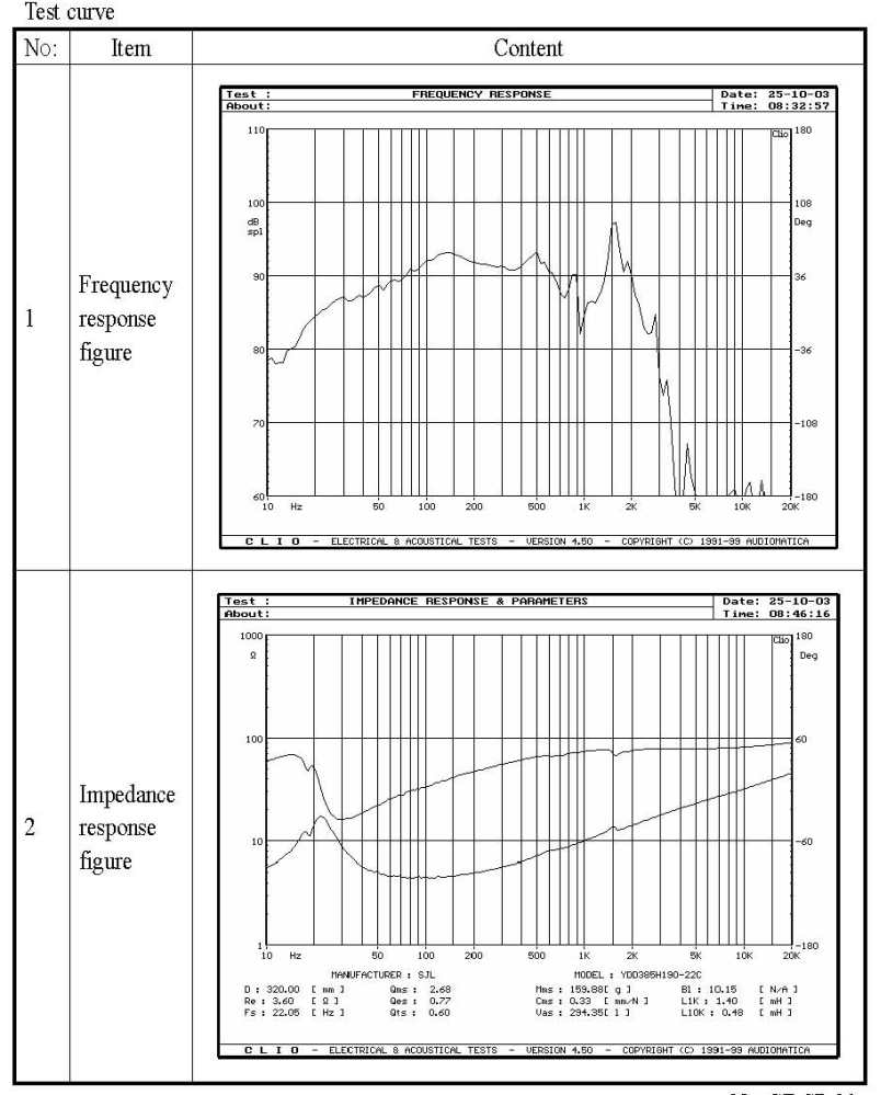

this is the one of the specs that came with the 15.
