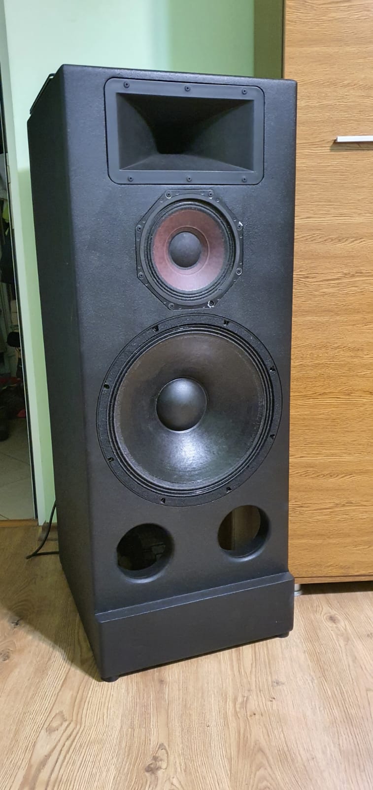

I was just wondering if you still have those speakers and how they turned out. Are you happy with the sound. In particular the Mid with B&C 8PE21?
Hi Tarl
Sorry for the late reply, i still have the speakers and i am verry pleased with them.
I have two more 8PE21 and i'm thinking of adding it to the speakers to make them MTMB, but i'm not sure yet.
Also i changed the enclosure to larger ones made from plywood.
I changed waveguides from B&C ME20 to Eminence H290.
The Eminence waveguide has better directivity control above 8khz.
Mihai,

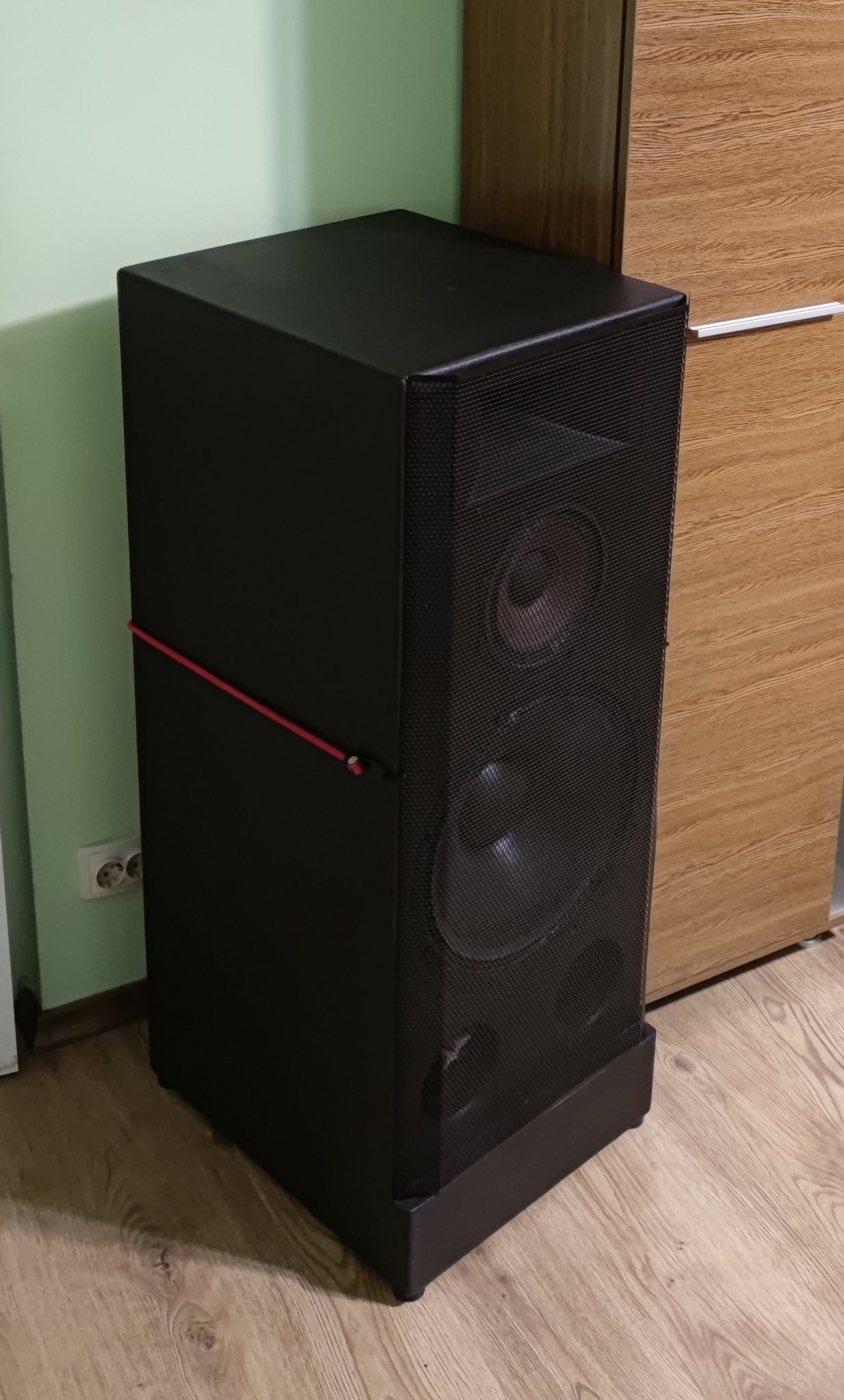

Would you mind sharing box size and the protruding baffle bottom plate purpose under the ports?
I'm not home at the moment, but from memory baffle is 45* 116 cm and depth is 50 or 55 cm. Internal volume is 180 liters iirc.
Bottom plate purpose is cosmetic. I have metal grills and i could not find one that is longer than 100 cm.
I still haven't properly attached the grills.😬
