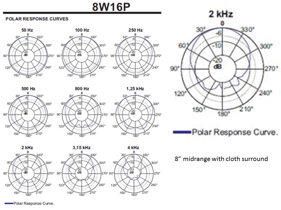

Attached polar response of 8" pro-midrange with cloth surround suggesting match to 90-degree ME20 between 1600-1800Hz range. You will want to make 8PE21 measurements to set the best crossover frequency before you purchase expensive passive L-R-C parts.

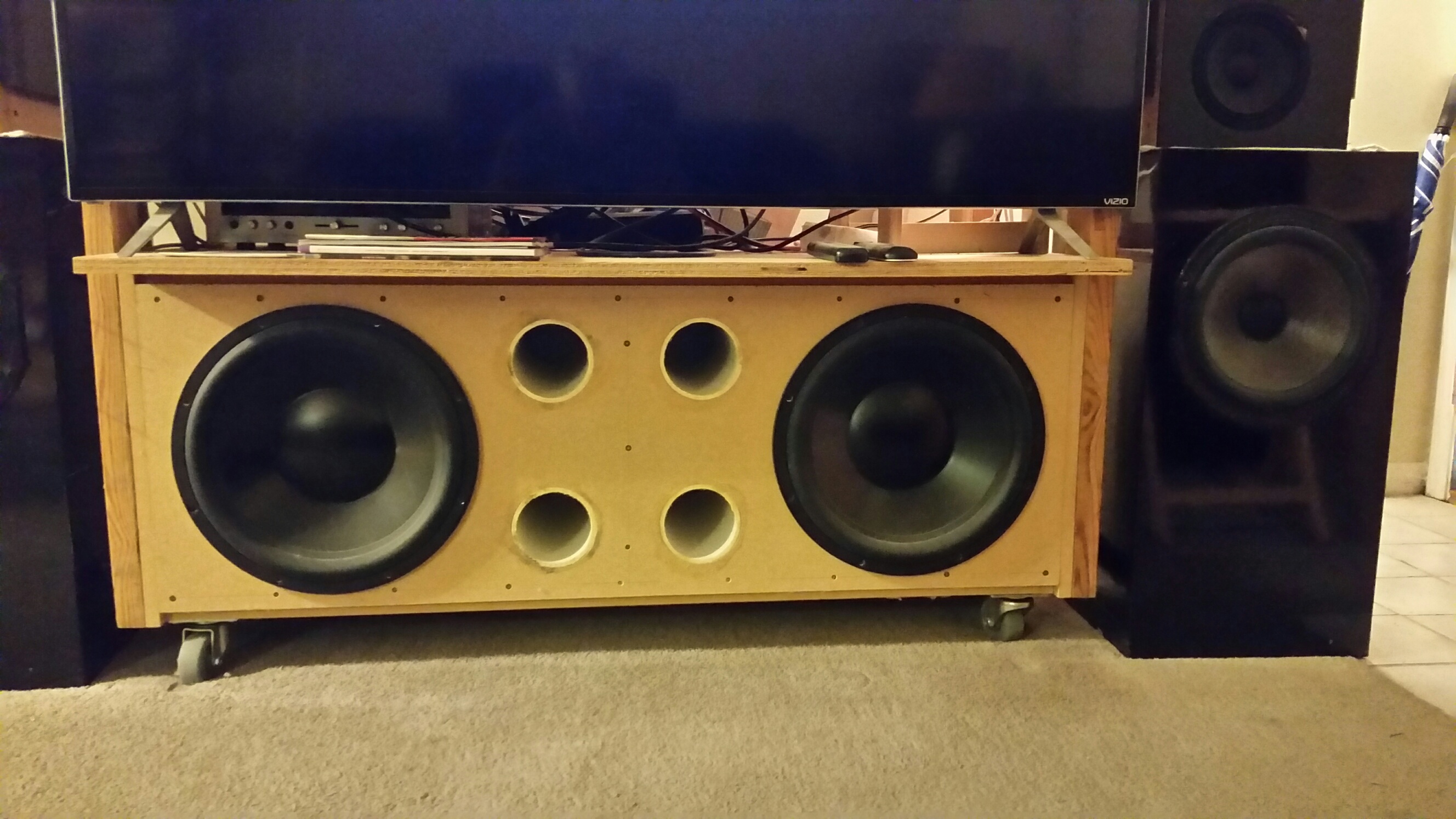

What are you matching them with down low?
For now, just a home theater sub (2x 15 inch units, but in a common enclosure)

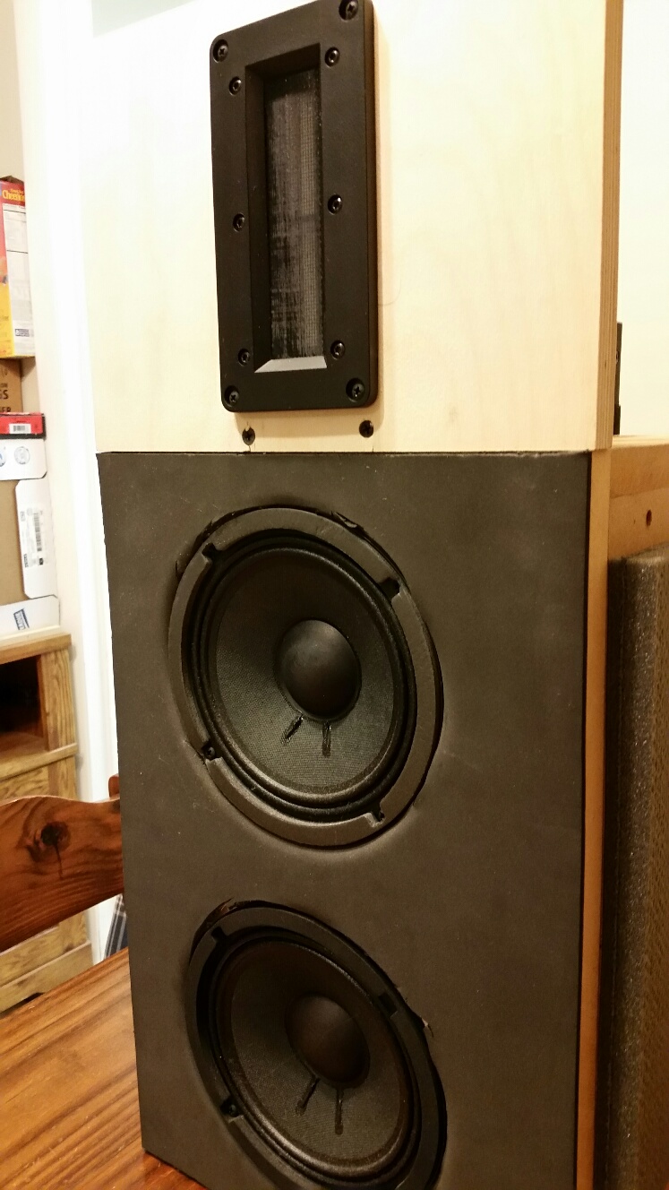

I neglected to mention in my previous post, that I have these 2x 6fe200's
in a 1.5 configuration, for the exact reasons mentioned above. The highs are rolled off of the bottom unit, and said bottom unit is utilized to compensate for baffle step diffraction. Smaller sized mid range units, such as the 5 or 6 inch range, when used in singles, often times sound a bit to "thin" in the lower mid range, for my tastes.

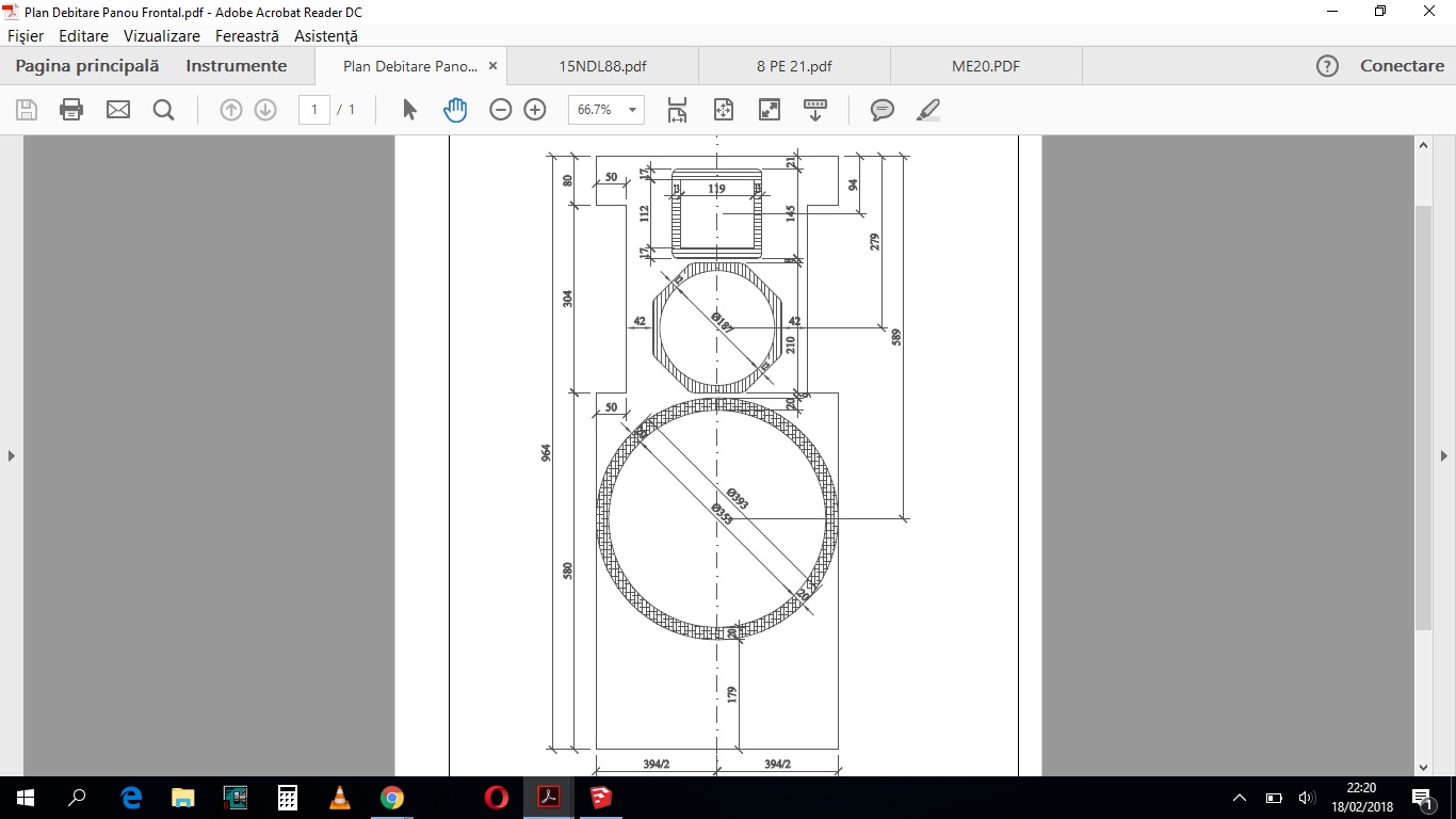

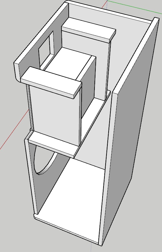

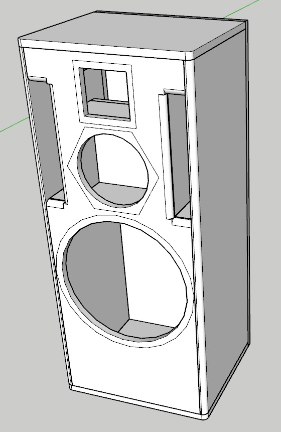

I made some changes to the enclosure, the internal volume now is 100 liters and i changed the ports. The new ports are 5x30 cm and there are two of them.
I am not sure of what tunning i should chose for 15NDL88.
The midrange has it's own enclosure at about 6.8 liters closed.

Edit: I would advise not to put the ports besides the mid if not absolutely necessary. The baffle becomes narrower for the mid and the baffle step jumps up to a much higher frequency - you lose spl in the important low mids and you'll lose linearity aswell. I would use tubes which have 3 advantages: You can shorten or replace them (which you can't with the slot ones) for bigger length if you realize you'd like a different BR tuning and they eat up less volume in the speaker. If you know the tuning is what you want, slots are fine but it would be better to move them.
Another opinion on baffle design.
1) I would not put the ports near the midrange to avoid mixing mid + deep bass air pressure waves, and creating extra nasty diffraction effects as the midrange pressure wave falls into the side ports. I would put two round ports a few inches below the woofer spaced about 20% away from each side panel. You can still experiment to cover over the side ports and cut the lower round ports.
2) I would mount the woofer about 3-4 inches below the midrange in order to provide both "woofer breathing" room plus enough separation for a "shelf brace" which is also part of the sealed volume midrange cabinet. Since cabinet volume for the midrange is small, the current baffle is acceptable with some attention to the midrange cabinet construction, plus a self brace supporting the woofer magnet -- which spreads the woofer vibration energy around all cabinet panels -- thus reducing woofer front baffle vibrations transfer to the midrange. I am not a fan of putting a large rubber gasket around the midrange frame-to-baffle mount for vibration reduction.

I already said the same. The reason it's done that way at PA speakers is because there's sometimes no room for the maximum-compact speakers. And it's usually not done besides the mid-CONE, it's done on the side of the horn, which is less influenced by that port placement.

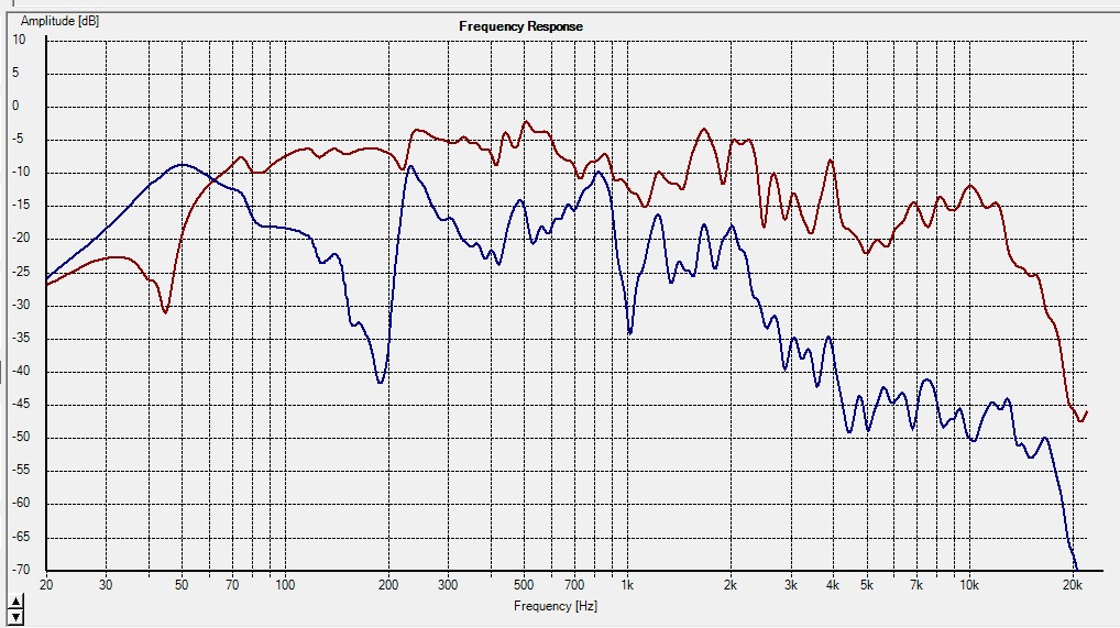

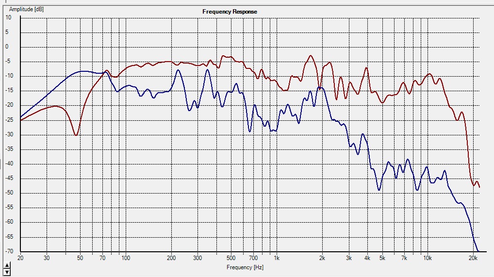

So regarding port position, a friend of mine who has helped me in designing these speakers (ionutgaga) made some tests a while ago.
He used two speakers that were almost identical but one had it's ports under the midbas, at the lowest end of the enclosure, and the other had it's ports between the midbas and the driver, in the middle of the enclosure. Ports sizes were almost identical.
Then he measured both the drivers and ports and got these results:
The one on the left is the one with the ports under the midbas.
ICG
Disabled Account
Joined 2007
I know similar measurements and I could almost swear the measurements are just the opposite. Are you absolutely sure they aren't switched? The cancelling unter angle at 200 are extremly typical for dual or very large ports beside the midrange driver because of interferences.
