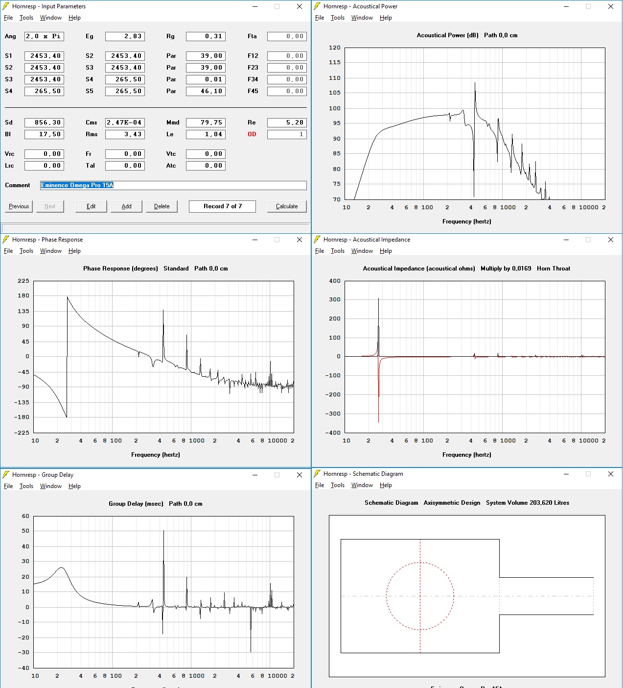

Here is a 200 liter box for you. Standard "K56" thing, as it was recently dubbed.
It does sim well in my 129 liter boxes as well, but you get a more rolled-off low end, you do gain a lower group delay of 23,5msec at 16hz though. Should have port output to 16hz in-room, though tuning frequency is around 26-27hz. Particle velocity of port at 28,3v/18hz is 16,6ms

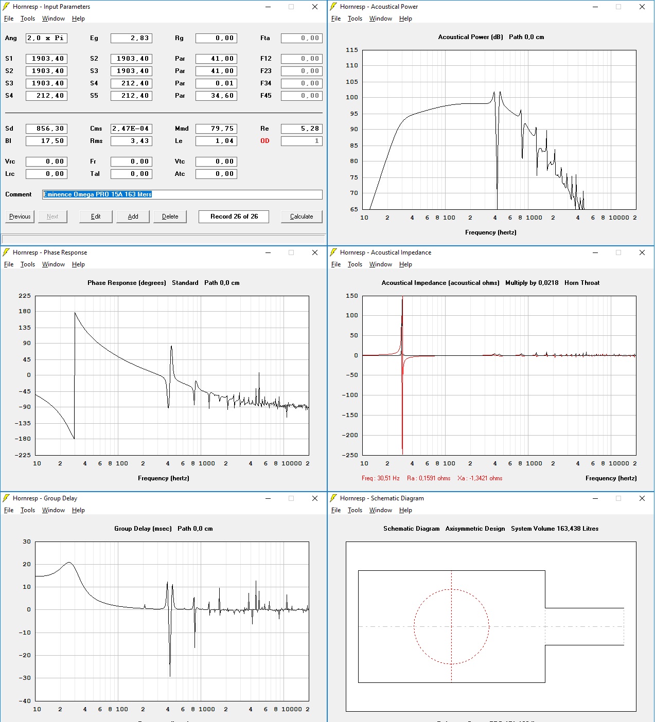

I stand corrected.
91,6cm height x 38,7cm depth x 58,7cm width, external dimensions, actually works out just fine. My bad.
But it's 163 liters internal volume, not 200 liters. Tuning frequency of 30 hz like you suggested, not much happening below 25hz probably.
Edit:
If you fudge the numbers in most directions 0-3cm, it will be ok, you just affect tuning frequency, less low end.
Edit:

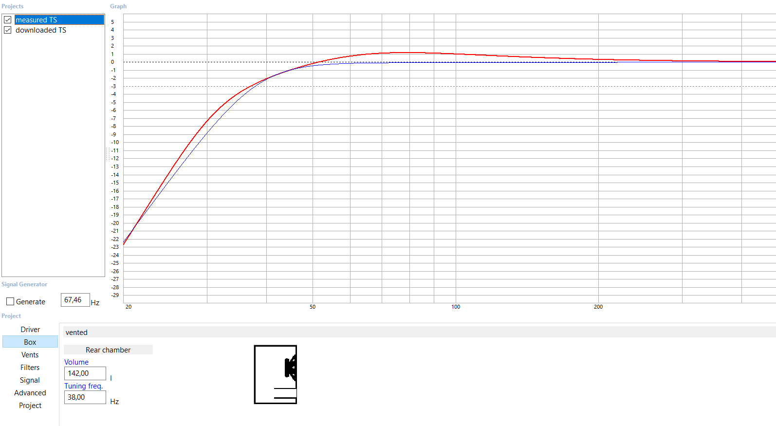

Wonder which would likely sound better at low volume between the Faital 15FH520 and the Faital 15PR400

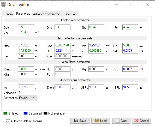

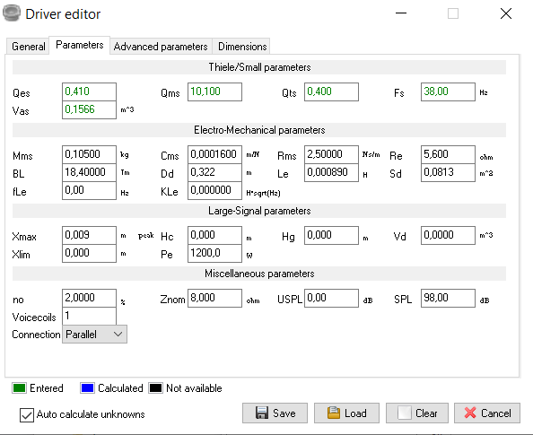

I couldn't measure same TS specs for 15fh520 at home as in the specsheet. Either it is the driver or my measurement that failed to deliver, but I suspect it is the driver as got good TS parameters measured for some other drivers I had. From the measured parameters I'd need much bigger enclosure than with factory parameters for similar response. If you use the driver in undersized box this doesn't matter much as you'd compensate with EQ anyway and the difference is not too big.
As there are a lot more users for 15pr400 and haven't seen such claims, or measured TS parameters for that matter, I'm not sure what it is. If this is something typical to faital pro to have false parameters in spec sheet or just poor quality control or what gives. I remember seeting measured TS parameters by TG and remember them being close to specsheet but can't currently find where those were published...
Anyway, these kick hard, perhaps don't go as low as the 15pr400 but for maximum output these are stronger I think. Max output is never needed in home use though, so.
Attached are the parameters and graphs for both in same size ported 142 liter enclosure with 38Hz tuning.
thx! you use the 15FH520 or 15PR400?I couldn't measure same TS specs for 15fh520 at home as in the specsheet. Either it is the driver or my measurement that failed to deliver, but I suspect it is the driver as got good TS parameters measured for some other drivers I had. From the measured parameters I'd need much bigger enclosure than with factory parameters for similar response. If you use the driver in undersized box this doesn't matter much as you'd compensate with EQ anyway and the difference is not too big.
