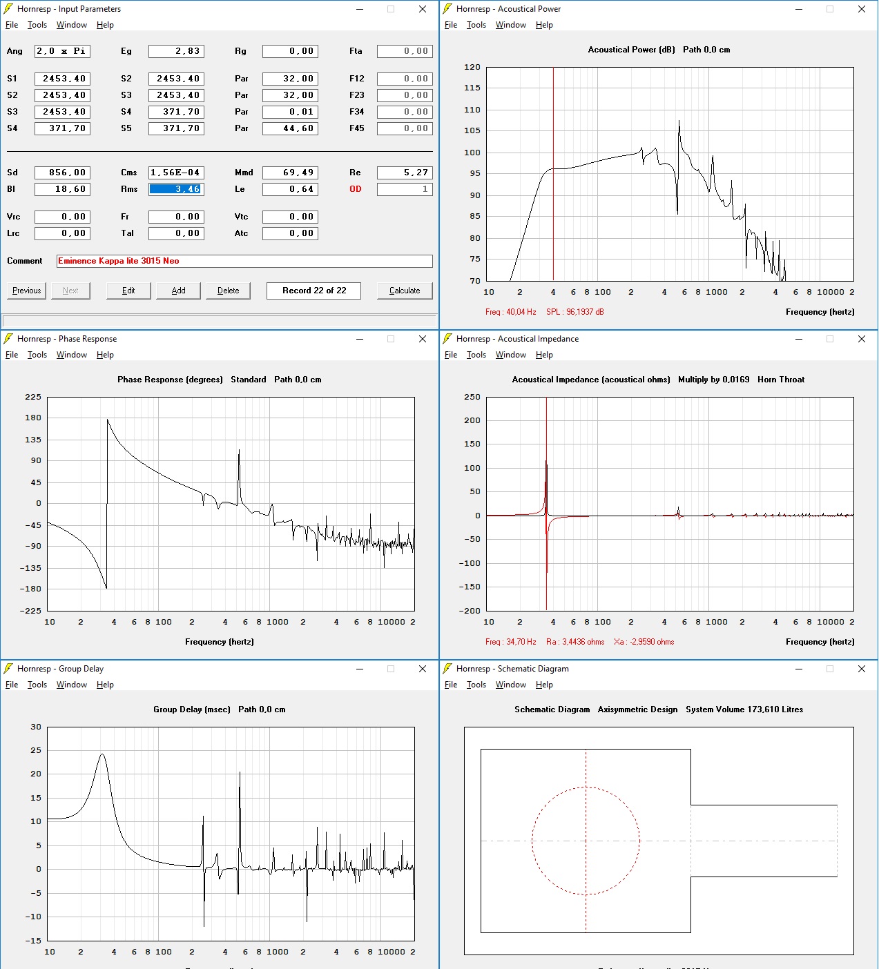

- 15'' hi-efficiency woofer that reach F3 40Hz in 150L
