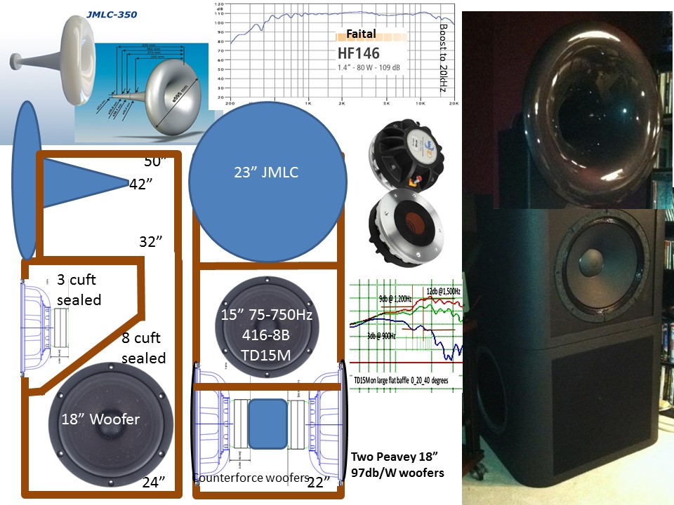

The Faital HF146 has a Ketone polymer dome, plus a new shorter phase plug, which produce a smoother high frequency response than the titanium dome on the Faital HF140. Compare the SPL graphs, and the Impedance graphs for resonance bumps. The Faital LTH142 is a well reviewed aluminum tractrix horn which perfectly matches the exit angle of Faital compression drivers.
So you have 1.4" CD choices for an all Faital system. See my post #5 for a few cabinet shapes.
With DSP and Bi-Amps for the woofer and tweeter you do not need to put a passive attenuator on the 109db SPL compression driver, but you might find it desirable to balance the large 109db vs 97db difference in efficiency - the large difference in low listening level amplifier power. You will want to study crossover options for the HF146/HF140 compression driver to understand why some designs use resistor L-pads and some designs use multi-tap transformers for attenuation. The HF CD will also require treble boost at 15Khz to get a flat, extended SPL.
Very true Mleod, thats why Im after titanium. That 3000e is above my skill level, unfortunately.
Im at a point right now that Im not sure what to do, so im going to hopefully start construction on the cabinet next week. I have abandoned the JBL L300 look. I have found that the slop of the front baffle can affect the response, dont need to add any complications. I still want to keep the front baffle wide as to minimize defraction especially at crossover region.

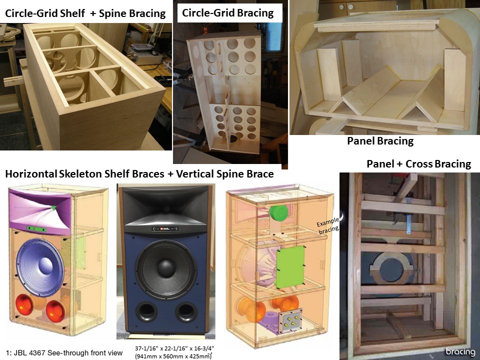

BRACE YOURSELF!!
-For your 2-way cabinet, two horizontal shelf braces plus one vertical brace should work well.
-For the JBL 4367 cabinet, the top shelf brace also supports the CD motor and the bottom shelf brace also supports the woofer motor.
-For DIY, low cost circle cutters have made hole-grid arrays more popular than custom cut frame braces.
-Old school used 1" x 1" hard wood strips for top-to-bottom panel bracing plus modest cross bracing. Still popular for DIY = simple + modest cost + high air flow.

Cant agree more it will be heavily braced! I have 3/4" MDF/hardwood for the outside and will add 2x4'S for bracing because I have a lot of them left from refinishing a basement, so Ill be using a lot of them, with also keeping in mind air travel and volume of course. I'm going to try and buy a router so I can round edges and countersink. I will also offset the tweeter and mid if used from the woofer. Felt was brought up some time ago and will experiment with that to help reduce diffraction after its built.
