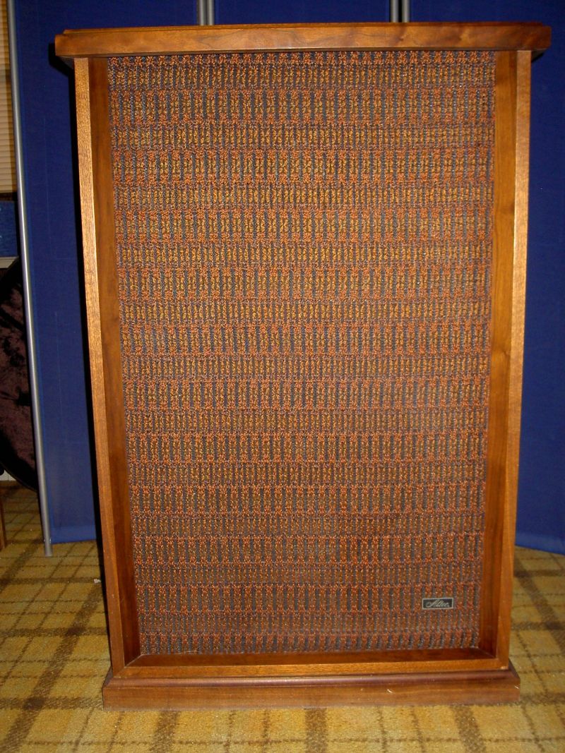

Hi Recently refurbed a pair of Altec lansing enclosures. They are 2 way just over 7 cubic foot vented ones. I used the 15 inch Greap Plains Audio 416-8 (alnico version) with a Radian 475PB driver on a Seos 15 inch wave guide. Passive second order crossover at 1650HZ. Padded down on the Radian about 12 db. The combination is about 96 db/w sensitivity and really nice sounding. The GPA is an exceptional woofer wit very flat response from 30-3K. I actually measured it flat to 4500. The enclosures are a variation for home use based on the Voice of the Theater systems. Great sound, able to do bot high and low power well. Beware the GPAs are not cheap.

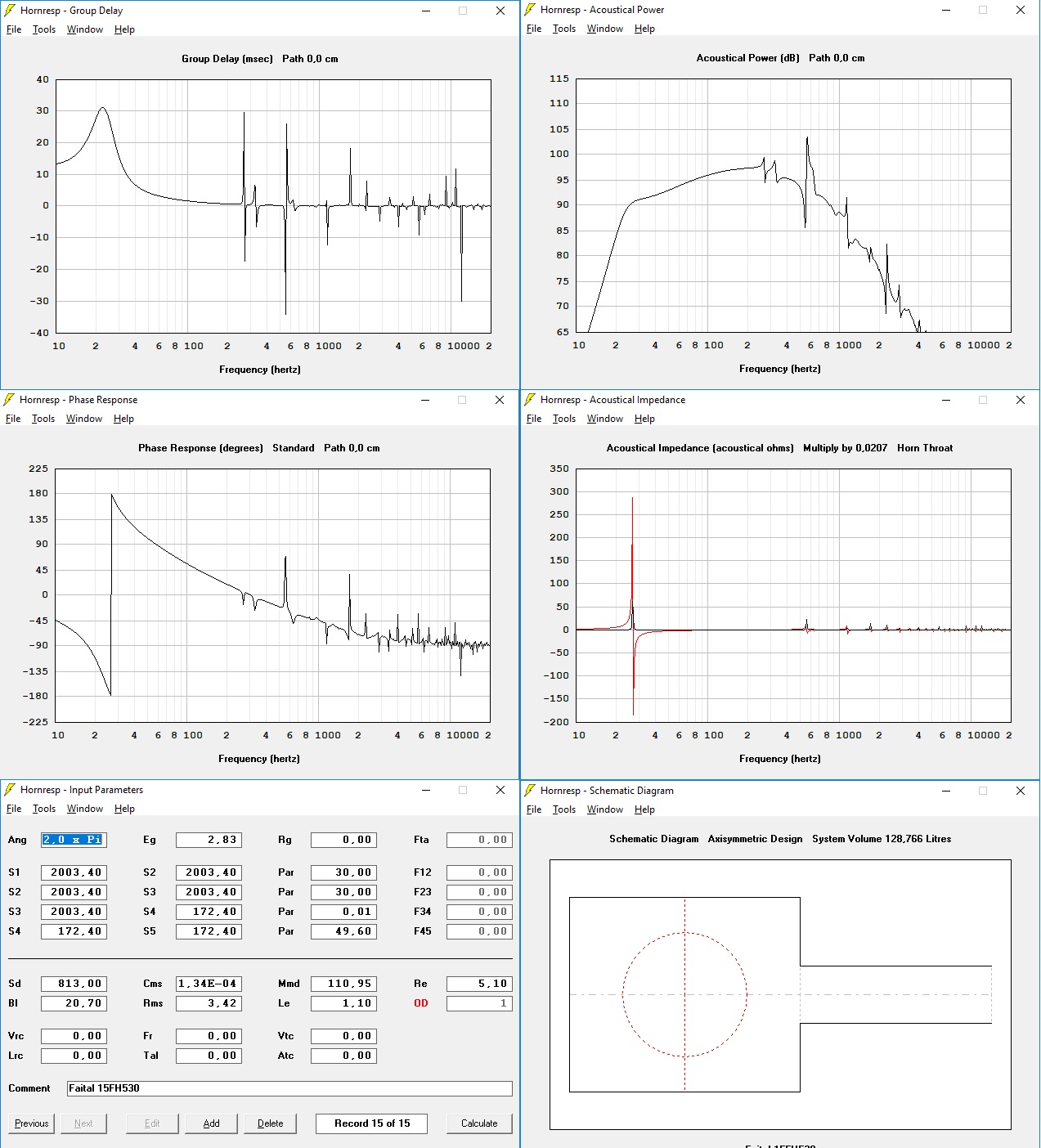

I simulated the 15FH530 in WinISD. I like 73L @ 44Hz for a compact solution. f3 is ~50Hz and f10 is 35Hz. Room gain will prop up these figures. A larger and lower-reaching solution could be a 3dB bass shelft, which would be 165L @ 33Hz. The -3dB (f3) shelf would "hold" to ~36Hz and f10 would be ~26Hz, albeit with a steep slope and you'd lose some "punch" from 50Hz-200Hz compared to the previous QB3 solution. Of course, you can correct this almost any way you want with DSP, as long as you have the amplifier power to back it up. With its generous 9.25mm Xmax, this driver will play stupid loud in any configuration in a domestic setting. Even sealed would be an option, with f3~83Hz at Qtc~0.7 in a very compact 42L box. You could run a Linkwitz transform to have any f3/f10 you want, once again, if you have the amplifier power for it and can afford the reduction in max SPL.

Do not know if you're interested, but just ran the Faital 15HF530 through hornresp, simulates very well in the boxes I am currently using, it's a drop-in replacement for my current drivers, sligthly better power response on paper, but also slightly worse group delay.
If you feed it 280watts of power (38 volts, quite a lot!) you get 21msec particle velocity on the port at 27hz, run a 4th order HP at 20hz to ensure it does not go over 24msec at 24 hz (just below tuning). You will still reach 113db at 28hz, more if you believe in "room gain". I'll say that most likely you can just forget the filter, and get in-room response to at probably 20hz or lower, but sound will be strong and good from 25hz up.

So for the 15" I got a VB of 4.1 cubic feet, FB of 36hz and that gives me a F3 of 45hz. Not bad really. I see what your saying KaffiMann. Ill probably go with this size enclosure and play with the DSP a bit.
