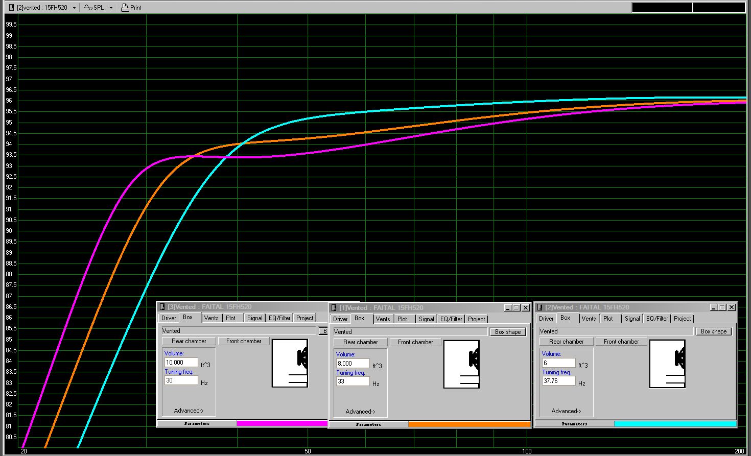

The Faital 15FH520 is a good 15" woofer for a 2-way. I attached SPL plots for ported cabinet volumes of 6-8-10cuft you can review.
With an 800Hz crossover point, you can use your original 1.4" CD choice, the Eminence N314T-8, with a horn like the Faital LTH142 Tractrix for 60H x 50V polar pattern, or a physically larger horn like the SEOS-24 for a 90H x 40V polar pattern.
If you decide to EXPERIMENT and push the 15FH520 up to a 900-1kHz crossover point in order to get high frequency extension over 18kHz, the recommended 1" BMS 4550 CD is probably your best choice with a physically larger horn like the SEOS-18 for a 90H x 40V polar pattern. The 23" diameter JMLC-350 horn has STYLE. You will need steep LR4/LR4 crossover circuits to attempt a 900-1kHz crossover. You can experiment with a smaller horn like the Faital LTH102 Tractrix for 60H x 50V polar pattern, but I suspect you will be disappointed with the abrupt polar pattern shift.

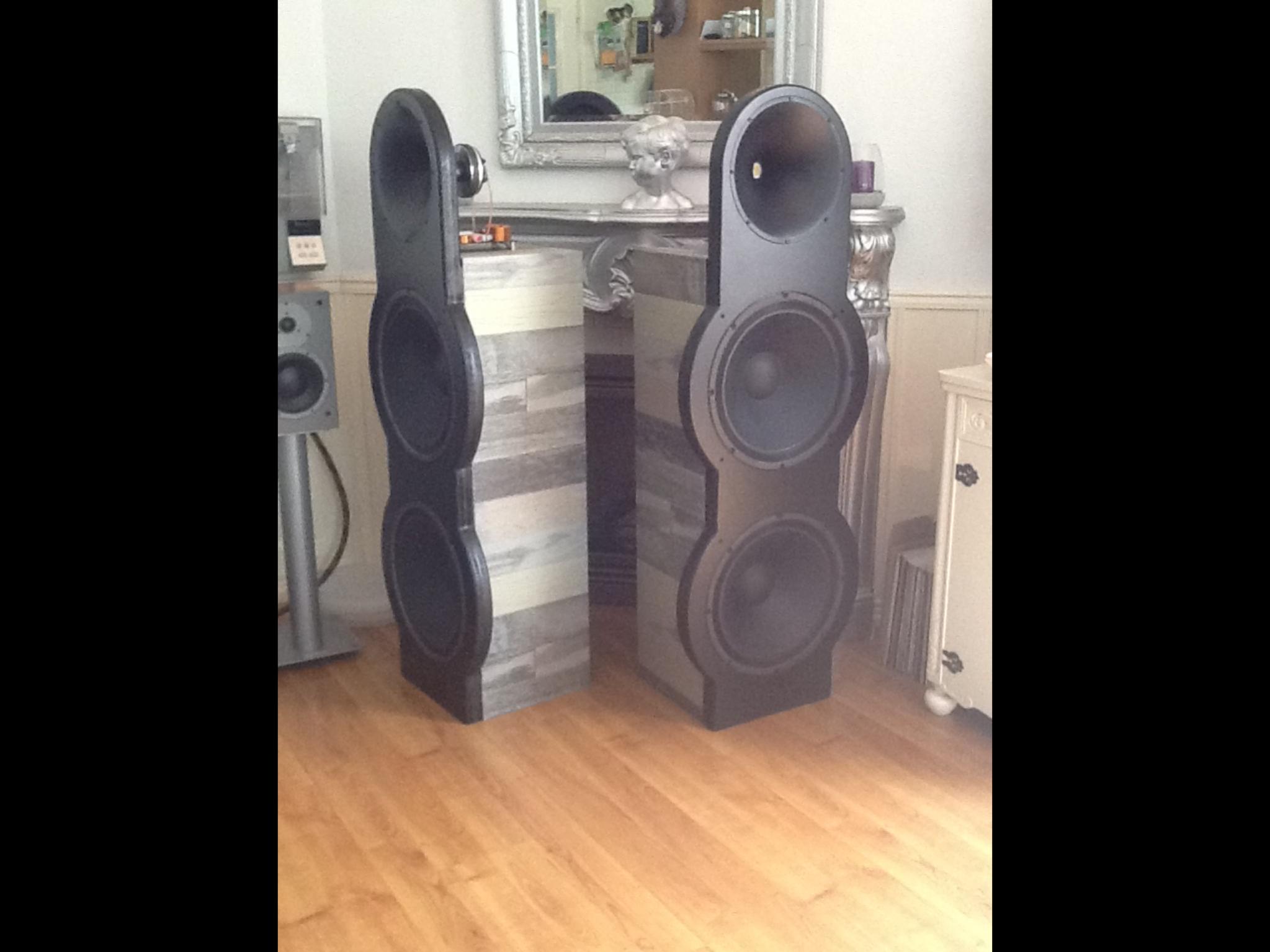

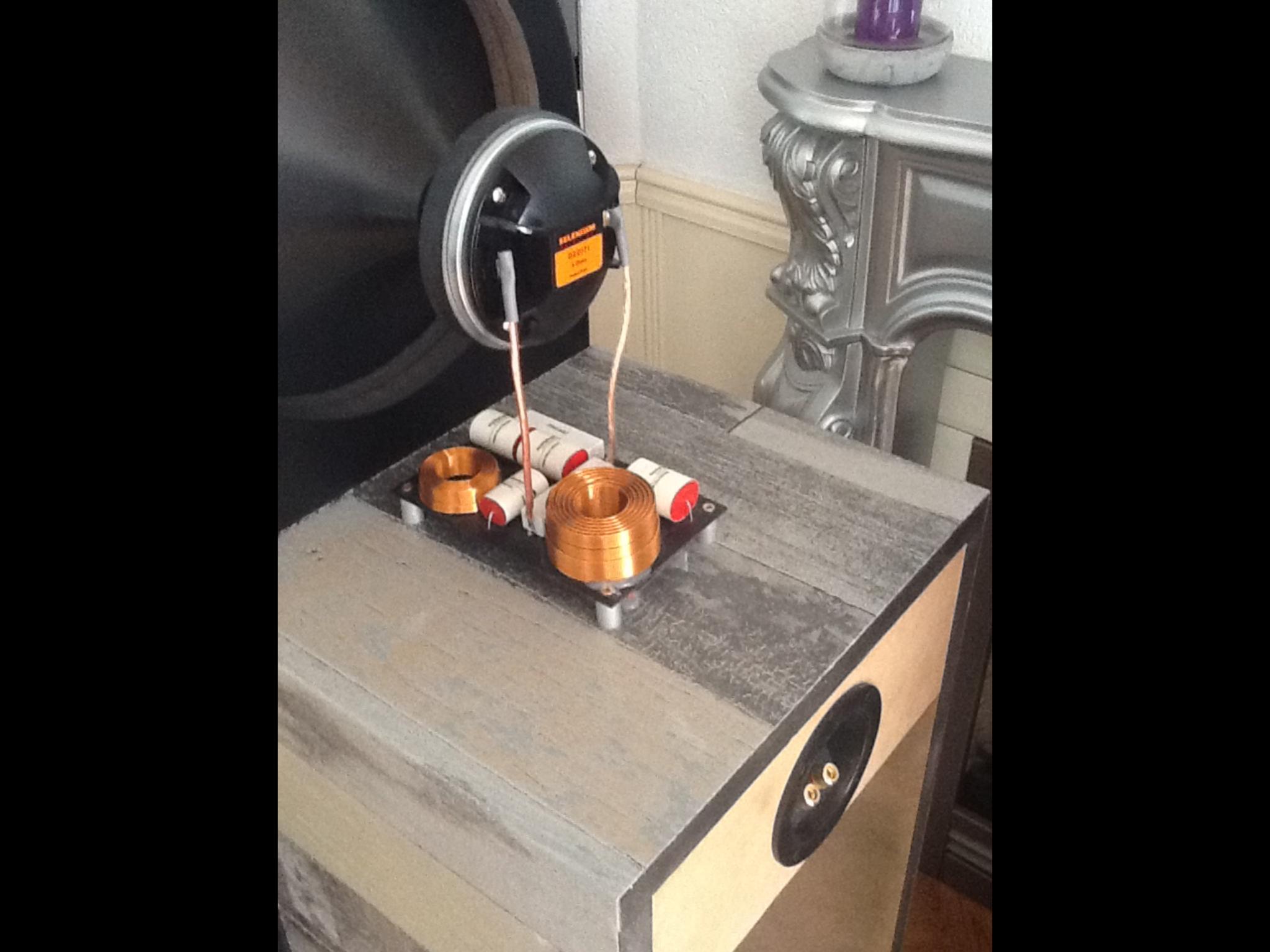

I have build 2 x eminence alpha15" with selenium d220ti crossed on 1270hz for my daughter. Very dynamic luidspeaker and not expensive to build.
