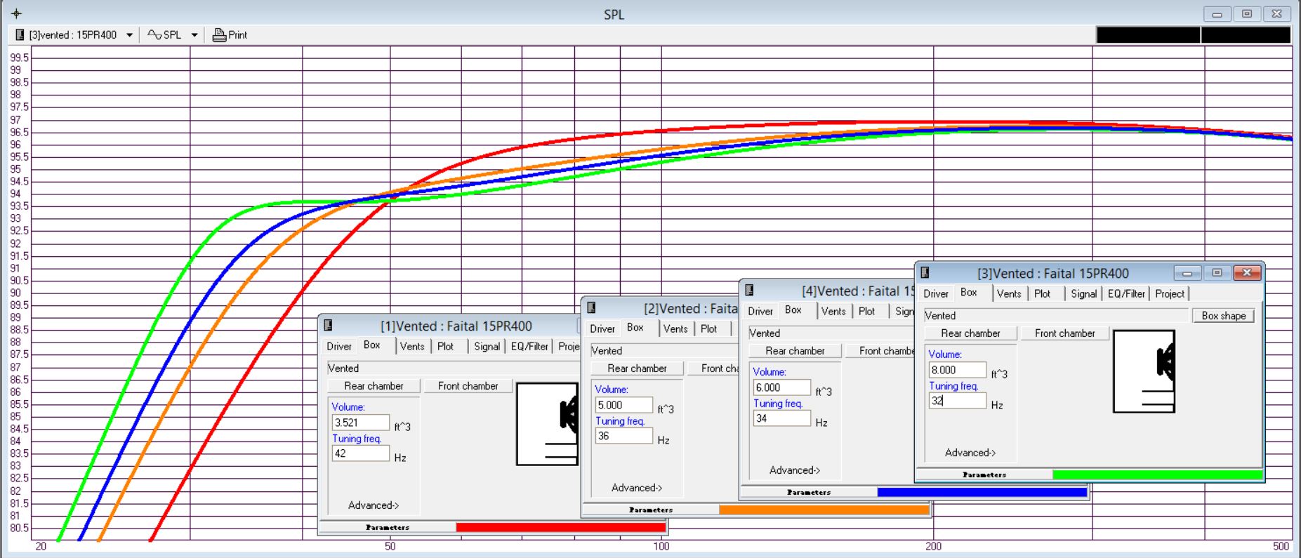

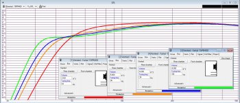

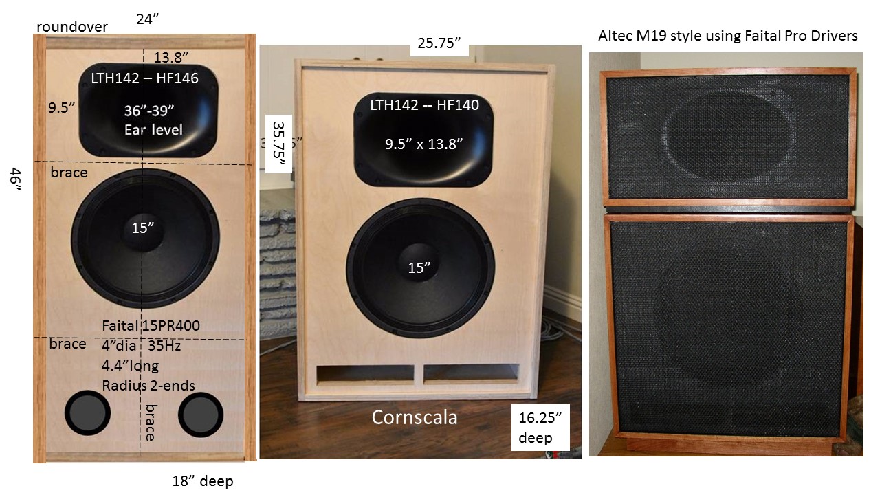

The Faital Pro HF146 compression driver(1.4") and LTH142 Tractrix horn are worth your review, as is the Faital 15PR400 woofer. You will find a few threads with crossovers and positive reviews.
----$660--------Focal T-M (1.4" CD + 15")
FaitalPro 15PR400 $260
FaitalPro HF146 1.4" Neo Compression Driver Plastic dome $250
FaitalPRO LTH142 1.4" 60 x 50 Elliptical Tractrix Horn 4-Bolt. $60
custom BW3 - LR4 crossover ~ $100
How low does that woofer go and what sensitivity? That box looks small. Never mind the picture didnt load all the way I see it.

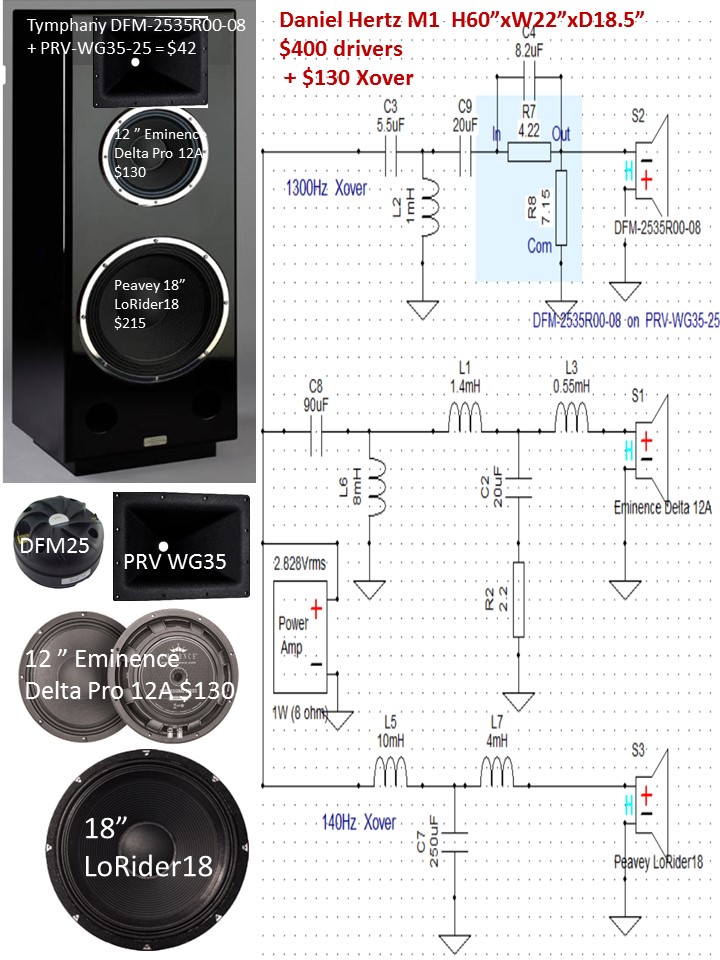

You could build a 3-way (1" CD + 12" midbass + 18" woofer) for the JBL 4345 cabinet using $400 in well reviewed low cost drivers, and ~$160 crossover.
1" DFM-2535R-08 on PRV-WG35-25 = $55
12 ” Eminence Delta Pro 12A $130
18” Peavey LoRider18 $215
I thought about a 3-way but with a 15" 8" then the CD so I could match the speaker more. I think thats the sizes they used but it just got real expensive for what I wanted. I am also a fan of keeping the crossover frequency away from the 2khz region because of my lack of experience with this making me think a 2 way is safe and less to go wrong. I think the 1khz region would be better for the crossover dip.

For $500 you can purchase the drivers and medium-grade crossover parts for a 18x12x1 3-way. Modern controlled directivity horns benefit more from putting the tweeter horn at ear level than older diffraction lens or multi-segment horns. Cabinets which fit a 60"x60" sheet of baltic birch ply, or 48"x96" sheet of cabinet ply can keep you in budget, 2-sheets/cabinet. Taper the rear sealed volume in back of the midrange to reduce resonances with modest stuffing. Shallow 1" waveguides can provide close time alignment with a 12" midbass.
