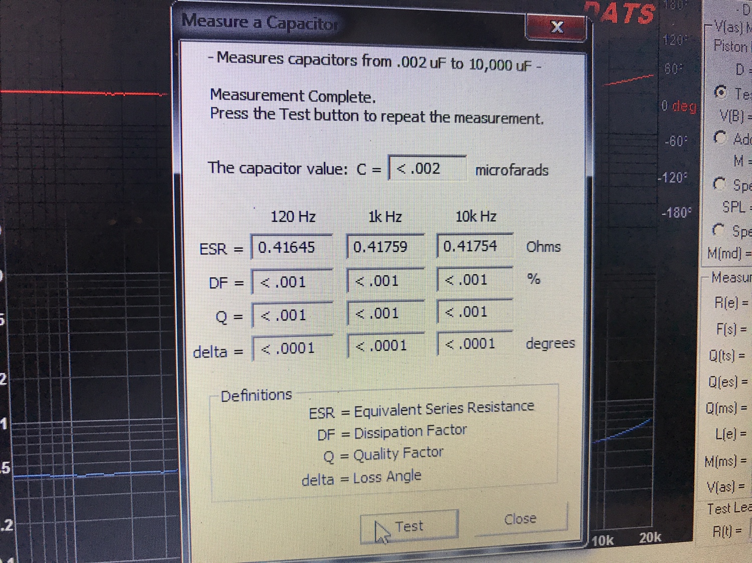

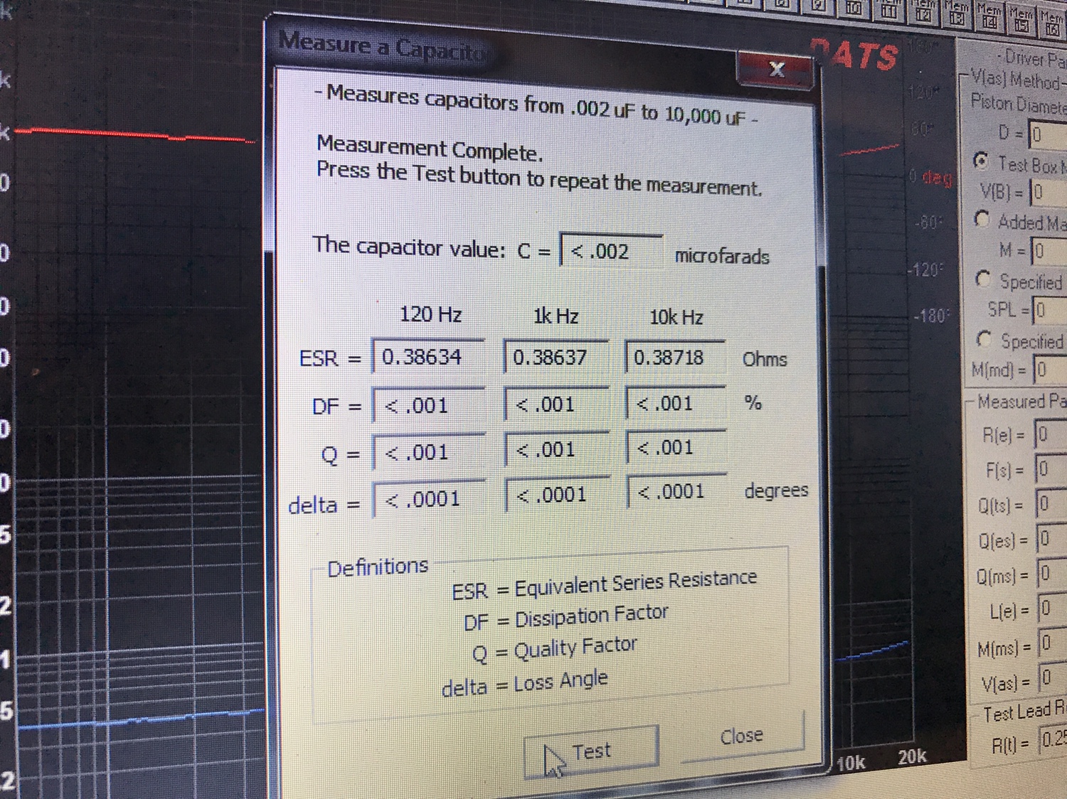

Btw, twisting your cables this way might add some capacitance to the cables
I've never considered it would as the twisting is quite minimal, but since you brought it up it piqued my interest...
See below
The longest wire I made...
And the test leads clipped together.
As you can see no capacitance, but I keep hearing about this from people on FB, definitely a myth that needs to be debunked.

So exactly what is the problem with a bit of capacitance in loudspeaker cables? Twisted leads will never be a problem unless you run old 800 Ohm speakers with current output amps.
Inductance is more of a problem, especially to some tubes amps.
//Anders
Sorry if I came on a bit hard about the cable issue...
It's just that I have heard this claim many times and it is just wrong. A normal twisted pair may have 100pF/m capacitance, resulting in 1nF for a 10m run of cable. This will never offset a passive XO.
Let's go back to the more interesting horn topic 🙂
//Anders
