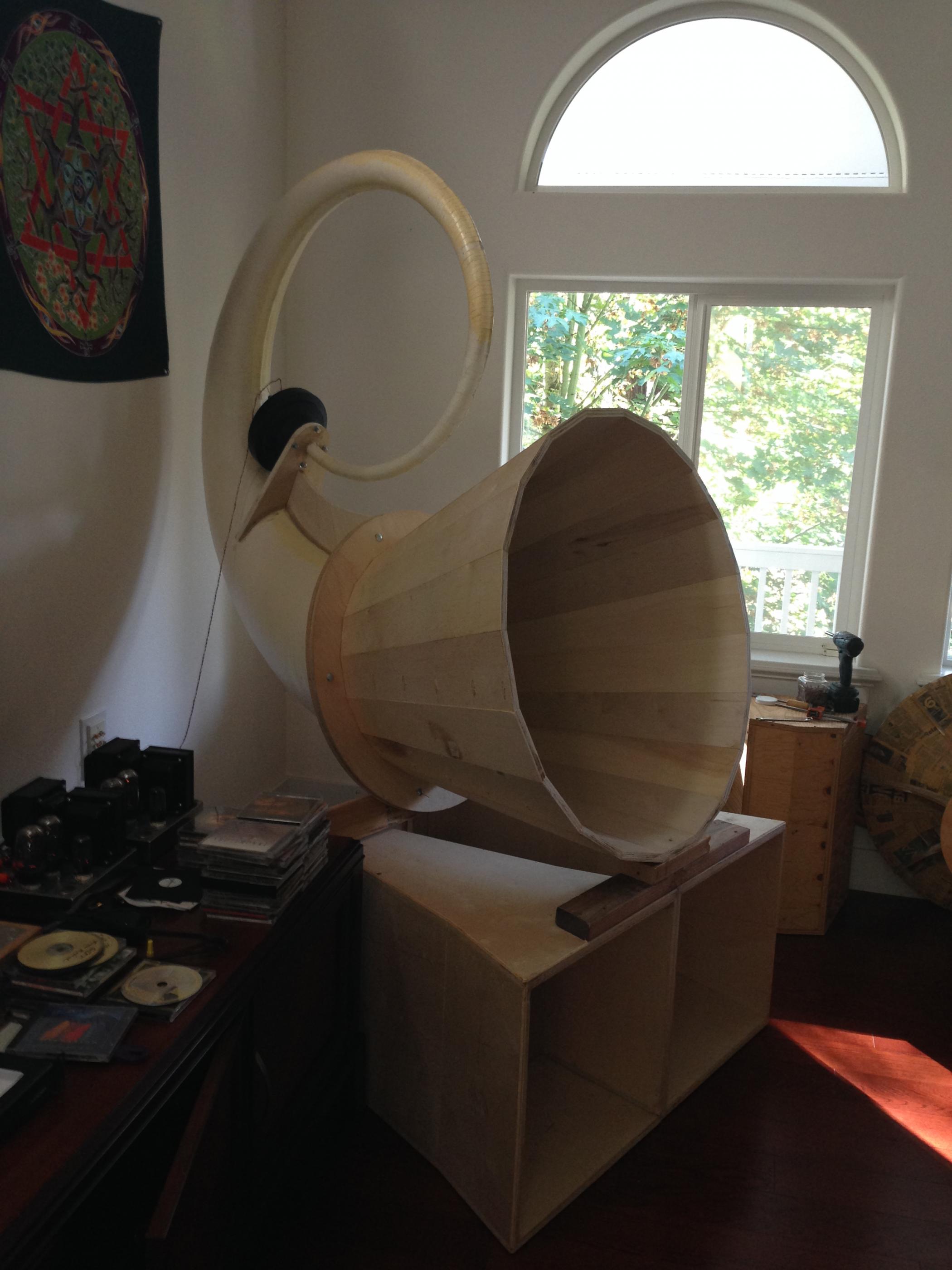

Hi John, Jennifer here....I have been watching this thread with interest. You have seen my 18" JBLs and we both know they just gonna not do the speed and impact thing right, when going up to blend into my 2" 2446 driven upper horns. Though the system will not likely be actually built until next year, I think I am going to have to think seriously about these mid bass horns to bring the energy needed under the tops, and above the bottoms, as forcing that big 18" will have some deficits..
to the rest of you, John knows about the project I'm cooking up....to fill you in its going to be a dedicated TV sound system, Left Center Right. Because its movies and not a full time music system, I am going to be using stock 2446 2" compression drivers that I was able to get at the right price with 2365 horns. No need for Truextant Be in these for old movies and TV. Horns are JBL Don Keele designed 60 x 40 dispersion bi-radials from the previous generation pro-cinema series. As per John's advice, I am layering the fiberglass with paper, glue, and joint compound, as this will deaden out the glass "ring". In the same deal I got a set of 3, 2241 18" drivers....There are great from the mid 30s up into the hundreds with slam and impact, but expecting them to blend into to horn at 500 is taking it a bit far. The factory did these as 2 way for 20 plus years in their cinema systems, but that 250 600 octave was always lacking just a touch of speed and impact in them... One of these mid bass horns with be PERFECT as a 'go between' to make a 3 way.
I HAVE been working on improving the frequency response of the upper horn/driver...Once that is done I will start thinking about bass enclosures, and looking for drivers that will work with this mid-b horn... This is a back-burner project, so please don't ask for photos yet....I'm still getting materials to start fixing the horns with paper layers, and right in the thick of making network experiments! Long way to go!!!
For a music system, nothing in my listening experience has been finer than John Inlow's paper horns...Just VERY simply beautiful music in his listening room, ....after this TV system is up and running, I AM going to do a pair! Honestly, I got spoiled hearing John's horns and must own some before leaving this Earth for whatever celestial music there is elsewhere...

That's a awfully small horn for bass. 🙂
Ask John to show you his approach to BASS HORN.....
they will knock your socks off...

The size tradeoff is certainly one I'm accounting for, especially in light of the wife's view.
Sounds like the horn has some coloration you aren't used to. And sounds like the gain in transient speed is there but maybe not worth it based on other tradeoffs.
Yea, I'm struggling frankly with the trade off, if I was limited to a 10-watt tube amp then the horn would be a no brainer. I'm going to build them just to say I did and really spend some time with them, afterall this is a learning journey for me as much as anything.
BTW, why did you opt for a vented box for the direct radiator? Isn't sealed going to have better speed? FWIW, my drafted design includes double 10" per side in sealed boxes, 80 to 500Hz or thereabouts. Beyma 10G40.
A block off plate is easy to do, the issue was in the modeling that the sealed box barely went below 150hz.
Are you planning to continue to listen to the mid bass horns and tweak to see if you end up liking them better?

Hi Javad. I'm glad you're building a stereo pair to compliment the Radian horns. Perhaps the next mid bass horn will be fabricated to exact specs and perhaps it will measure (or sound) different than the first horn--who knows? You might be in for a treat. I can tell you that the mid bass is for system tone and snap/punch. It's the 450 hz high frequency horn that carries the brunt of the frequency load and makes those mid bass horns shine.
Best of luck, and may the audio gods be with you in your quest for knowledge and nirvana. 😀

The horn sub is up on the front wall loaded with JBL 2242 - the horn splits to two corner loaded paths each 21 feet long then into thr concrete corners. There is also a rear corner loaded BR sub tuned low (shelved and delayed) with twin JBL 2242. The bass is twelve 15's.
