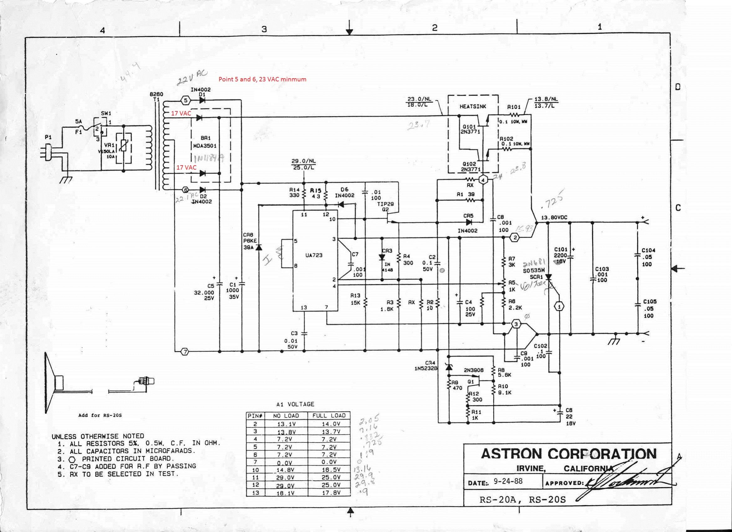

Post 1
"AC power entry: TE Connectivity filtered module."
Waste of time and money. If it was needed the internet would be flooded with Astron power supply mods with an input filter.
"Transformer: Antek 1500VA 17V (they are building this one for me, as it is not a common size)"
Throw it out. Get the right transformer. With a single winding going in to a full wave bridge your secondary ac current is 1.8 x the DC current. 80A x 1.8 = 144A. The losses are 1.4vdc two diode drops x 144A = 202W for the bridge.
With two winding's and a center tap only two diodes are needed. your secondary ac current is 1.2 x the DC current. 80A x 1.2 = 96A. The losses are .7vdc x 96A = 67W per diode = 134W.
Look at the Astron schematic (see my red text on transformer). There is a center tap and two outer winding's. The first winding is 17vac from the center tap and after that winding there is a 22vac winding. You will need a volt or two more say 23 or 24 vac as i will explain later.
"Bridge Rectifier: IXYS 160 AMP, 1200 V. Max surge = 2800 Amps, Vf = 1.43, power dissipation = 300W at 25C, screw mounting"
No need for this part, get two diodes.
"Filter Caps: Vishay 0.082F / 50V (quantity 2) for a total of 0.164F filtering."
Your power supply
V = dt I/C
.00833 S 80A/.164F = 4V pp ripple
Astron
V = dt I/C
.00833 S 35A/.064F = 4.6V pp ripple
This is about the only place your money would have made a difference and you ended up about the same as the Astron.
"Pass Transistors: 2N5686G (quantity 11, with one used as the Driver). 50 AMP / 80V"
Good transistors.
"Current-balancing resistors: Vishay 12.5W 1% - 0.047 Ohms."
Good resistor wattage, wrong value. The Cs input on the LM723 needs about .7 volts to function. .7 VDC / 8A = 0.0875 ohms. 8A x .7 VDC = 5.6 W.
The 8A is assuming 10 transistors and we already discovered that 10 transistors does not divide out to 4 heat sinks. Not that it matters because as you have been told several times your heat sink scheme will not work.
My opinion, throw the case out and start over. The case is completely wrong for what you want to do. It was made for a stereo amplifier, one amp on each side of the case and separate heat sinks for each amp. How are you going to use this case? Are you going to run wires from both sides to your circuit board. If the wires are dressed out neatly along the walls then you will have 1 to 2 feet of wiring per transistor! Will that inductance effect operation? Not to mention just a sloppy build. Find a case with a big back panel all heat sink and mount the transistors properly. You will need a machine shop to mill out the heat sink, good thing you have lots of money. While you are at it have the machine shop put holes for aluminum hex extensions on the heat sink and mount a plexiglass panel 4 or 5 inches from the heat sink. Then put 2 or 3 muffin fans on the plexy blowing on the heat sink fins. Now you will have a real piece of equipment.
Back to the 23 VAC winding's. The reason they are used is to raise the LM723 output voltage to the point were it can turn the power transistors on. The LM723 is referenced to 24 VDC gnd. For it to turn on the transistor it has to be greater voltage than all of this. The output of the LM723 is 3 volts less than the input. The output of the LM723 has to go through 3 diode drops ( one darlington driver and the power transistor) .7V x 3 = 2.1V plus 3 volts = 5.1 volts DC you are short of to turn on the transistor. This is why you need 23 VAC minimum for aux winding. 23 VAC x 1.414 = 32.5 VDC - diode drop .7 VDC = 31.8 VDC - 24vdc = 7.8 VDC. Now you have 2.7 volts to spare and some room for the darlington base resistor to drop some voltage.
OK, what about this darlington i keep talking about. Your existing driver will burn the LM723 up the first time you try to use it. Ten transistors Min hFE 15. 8A each transistor / Min hFE 15 = .533A minimum base current. .533A x 10 = 5.33A minimum driver current / your current transistor choice 15 hfE min = 355 mA from a LM723 rated at 150 mA max. The 411 on the internet says this chip likes to burn up at 150 mA. I did a quick check on one Astron schematic and found they run 100 mA. So you should not exceed this either. So 5.33A minimum driver current / .1 A max from LM723 = You need min hfE of 54. I did not see a regular power transistor with a hfE min above 15. The darlington takes current to drive also, but i am just going to bump the 5.33A to 6A and call it even. I think the worst case voltage drop across the darlington would be the difference of the 2 power supply's, 7.8 VDC. So 7.8 VDC x 6A = 47 watts dissipation. This one looks OK, DigiKey MJ11012GOS-ND, min hfE 200. Your LM723 will only have to supply 6A drive / 200 min hfE = 30 mA.
Back to the transformer when you use a center tap rectifier you have 2 winding's supplying the current so each winding is rated for 1/2 the current.
The main 17 volt has to supply 96 A AC for continuous operation, i am not sure how to de-rate for lower duty cycles. 96A / 2 = 48A per winding.
The 23 VAC winding's has to supply 6A DC min so 6A x 1.2 = 7.2A AC from transformer so call it 4A per winding for a total of 8A.

Also i forgot to post the sch i talked about in my last post.
hi Powerbob it's worse than you figured
the centertap transformer each 1/2 winding has to supply the full voltage minus only one diode drop. The other winding supports the opposite half cycle. The typical current crest factor is reduced to 1.2 from increased copper losses. A good custom XFMR will devote more secondary copper bringing 1.2 back up closer to ~1.5. Also a good rectifier will be closer to 1.1V drop not 0.7V.
The full bridge (single winding) there are a full 2 diodes drops for each half cycle, use normal crest factors.
this is a good tutorial Linear Power Supply Design
your drawing> use the 70A Astron in the thread not the RS20A to compare.
the big problem is that naive users assume 70A model is seventy amps output\
did Astron increase copper in their XFMR? nope because that would mean the EI core would grow to next size up.

There are four 1N1184A devices (studs) mounted vertically on the rear panel of my VS-70M. They are wired in parallel. What am I not understanding?
a lot ( IDK hacked repairs /)
( there are 2X 50A bridges wired together like you agreed to earlier)
you know what I told you before I don't agree with Astrons cheap build mentality either, but they can be easily be improved upon.
It doesn't take much to ruin a good design > for example using a unsealed pot for volt adjustment can result in total flame outs destroyed OP section and melted wires. This is what happens when accounting management is given full reign.
but YOU on the other hand seem happy to throw the baby out with the bath water.
