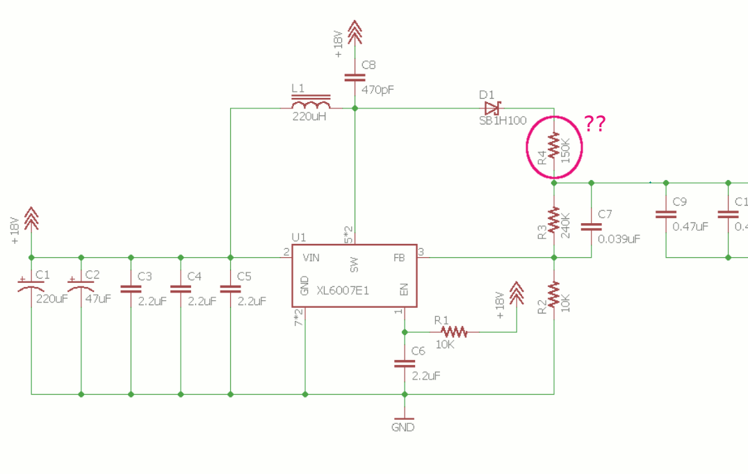

Joyo BantAmp 12AX7 Tube 18V DC Power Supply Schematic
So the Bantamp amps by Joyo only run 50V on the tube. We can get +/- 24V boost supplies from China for a couple of bucks.

Surely there isn't really a 150k resistor in series with the 50-volt B+ rail?
I'm guessing the B+ rail actually connects to the right end of the diode?

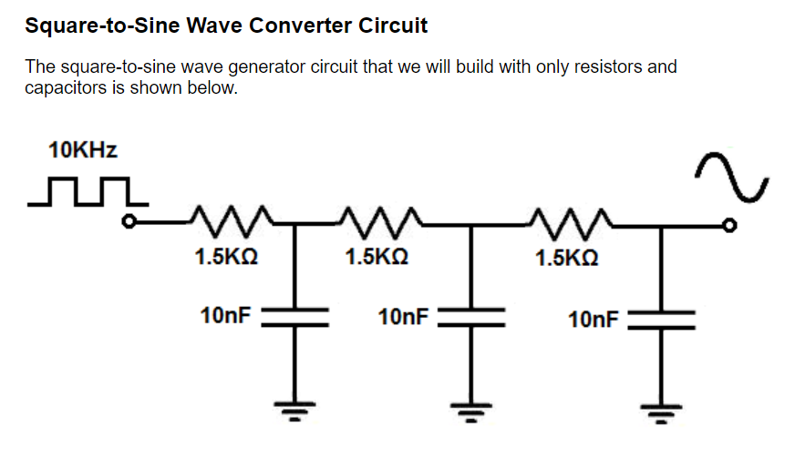

Many old tube amps have rather small filter caps which are also, well....old. They might work fine when plugged into clean wall power, but may buzz like crazy when fed the "modified sine wave" that these small inverters make. It's really a square wave with some dead time so that the total heat energy is similar to a sine wave. It contains LOTS of nasty harmonics well into the audio range.
Do you think the modified sine wave could be cleaned up by some circuitry? The attached is a base schematic for something I was playing with, it converts a square wave coming from of a 555 timer at 6V 10Khz to a sine wave and it creates a very good sine wave. You would have to play with the values of the components. For me it did however cut the output voltage considerably in simulation. I actually modified it to run at 1Mhz. The question is can such a circuit really work on 120VAC 60Hz modified sine wave, under the load of the tube amp and if so what would the output voltage be? I was only looking at it for use as a sine wave oscillator. You could always build your own inverter instead. Battery --> regulator circuit --> oscillator --> Step up Transformer.
That's the catch! Each of those big series resistors would eat up a lot of the available power, and drop a lot of the available voltage, so you wouldn't get much at the output of the filter....it did however cut the output voltage considerably in simulation...
As long as there is no attempt to draw any significant current out of the filter, it will work for the purpose it was originally designed for - to filter out most of the harmonics from a square wave signal generator, leaving something close to a sine wave.

You would have issues trying to install a filter like this on the AC line voltage input to the existing amp for two reasons. The currents involved would require rather small resistor values. This puts a good deal of capacitance on the output of the inverter, which may not like it.
The inverters in question take 12 volts and boost it up into the 160 volt range with 2 mosfets and a transformer, then rectify it into 160 volts of DC. The DC is then chopped up into a "modified AC sine wave" with a 4 mosfet H bridge. The "chopper" circuit needs fast rise and fall times (guaranteeing lots of harmonics) to get by with minimal, or no heatsinking. Adding a capacitive load to these things usually makes smoke, melted fets, or just instant deadness.
So what does the Dumm Blond do after he smokes an inverter? He cuts out the dead fets, and taps the raw 160 VDC supply to run the tube amp B+, done! You can get over 300 volts from a European spec 240 volt inverter.
A filter like you show could be used to clean up the DC supply inside the amp, but the OP has an existing vintage amp that he is probably not going to experiment on. It has been my experience that once that nasty waveform gets near the amp, you can't clean it up. I have been using a 700 watt inverter and a boat battery for outdoor sales and such and I find that it will put out a strong enough buzz that it can be picked up on an AM transistor radio from 50 feet away.

The poster took the values off the board, could be a typo or read the value wrong. I would not use it anyway, was more interested in the tube section. Those Bantamp amps sounded good enough to me that I was curious about how they designed their amp. I found a RF test report online, posted the link in another forum.

Further on the Joyo.
their circuits are generally -> op-amp the signal -> feed into 12AX7 tube -> do some tone shaping -> go into solid state power amp, which in the case of the Zombie is a TPA3118. So, how are they getting the voltages to drive a 12AX7? A nice SOIC-8 boost chip: XL6007E1.
Quote
Does the rest of the circuit have any other hard clipping elements in it?From just the pure elements of the power supply setup, no. But there did appear to be a set of diodes in there, but without really going into it hard, I couldn't tell if it were hard clipping of soft clipping. There appeared to be several TL072 surface mount opamps, and the diodes were close to them.
Actually, I noticed a flub in my schematic and made me a JLCPCB version of, so I know it works now. Here is the corrected schematic
I drew the 50V rail on the wrong part. This schematic has it corrected and I built a PCB to verify it.
