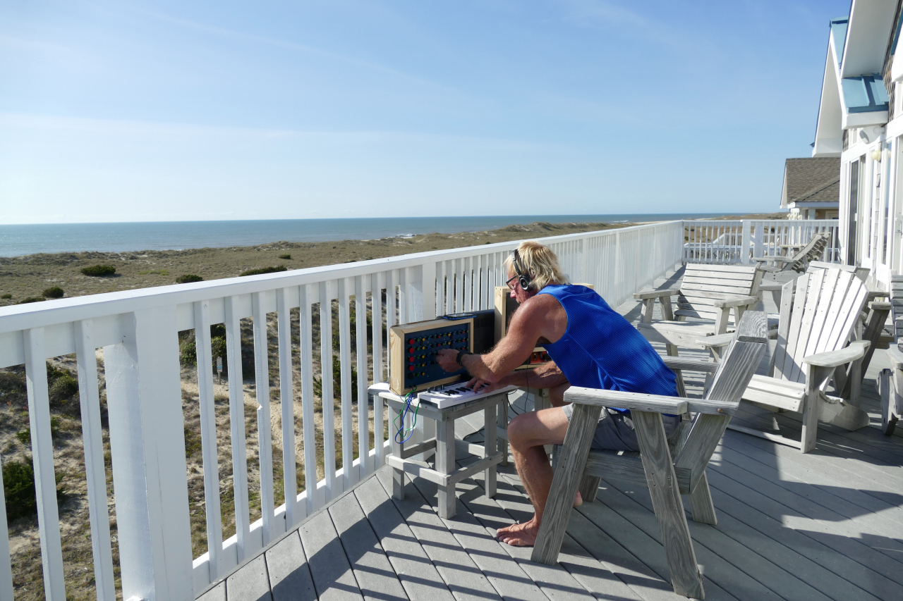

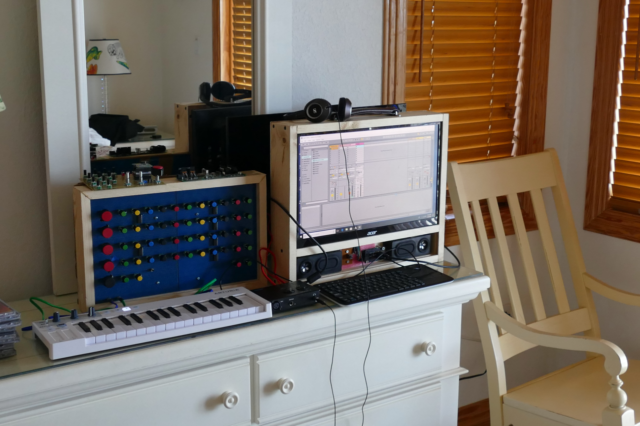

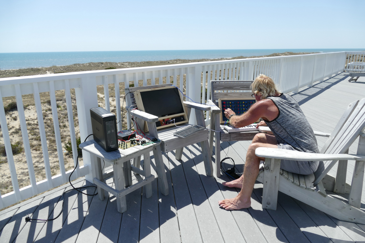

When I took my DIY synthesizer, a PC with 19 inch screen, and several small USB powered gizmos to a rental house on the outer banks of North Carolina I brought along a "pure sine wave" UPS. That "box" PC probably consumed about the same power as the old Gibson, about 100 watts at idle with the brightness cranked up full. It would run everything for about three hours between recharges. These are kinda heavy, but don't occupy too much space.
It can be seen on the left with it's power plug trying to absorb energy from the sun in the first picture. The same setup was used indoors with the UPS on the floor being charged.
The wind was too strong for some synth's on the Atlantic shore jamming. There were only a couple days where I could walk to the water without getting sandblasted. Not good for the electronics....or me.
