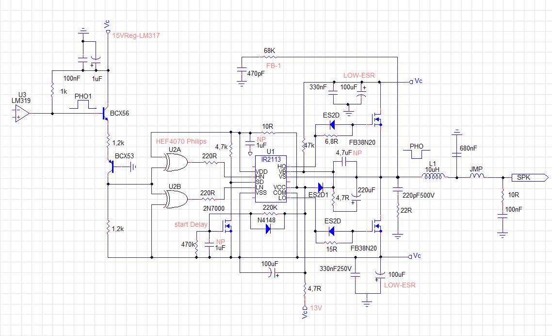

+/-12V 5A, 100W filterless class D
The intended circuit looks like this. Does anyone see any problems? Power supply is well capable of 5A.

30V peak is actually a little more than 100W into 4 ohms. Prms=Vpeak^2/(2*R)=112.5 W. If somebody doesn't know these elementary calculations, then I suggest him not to build any amplifiers.
But for those who are capable of designing something (and have good soldering skill), I recommend TAS5162 or similar power stage for this power level.
As I said, if somebody can't answer to this trivial question, I don't recommend him to build anything. I think Mathematics of elementary school is a neccessary knowledge. Or at least a minimal common sense.

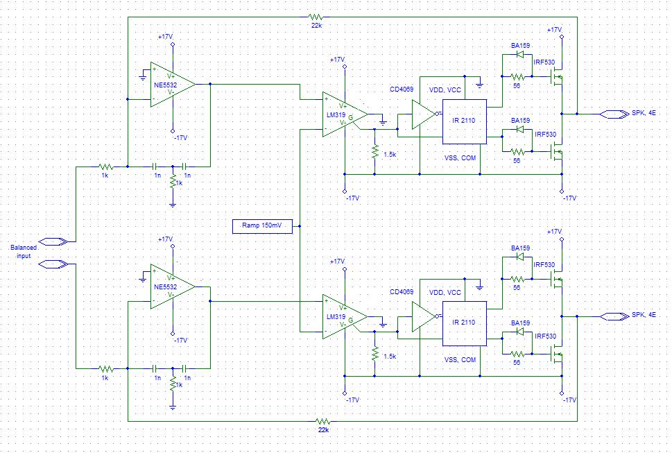

In your schematic the LM319 limits the power supply to +/-18 V, you can't use more.
TAS5162 doesnt seem to be available in around here. So i prefer to go discrete.
IR2110 and other controllers are supposed to be inverter spare parts and are easily available.
