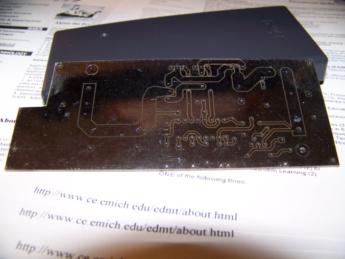

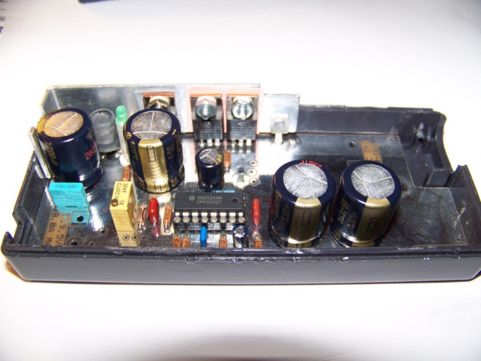

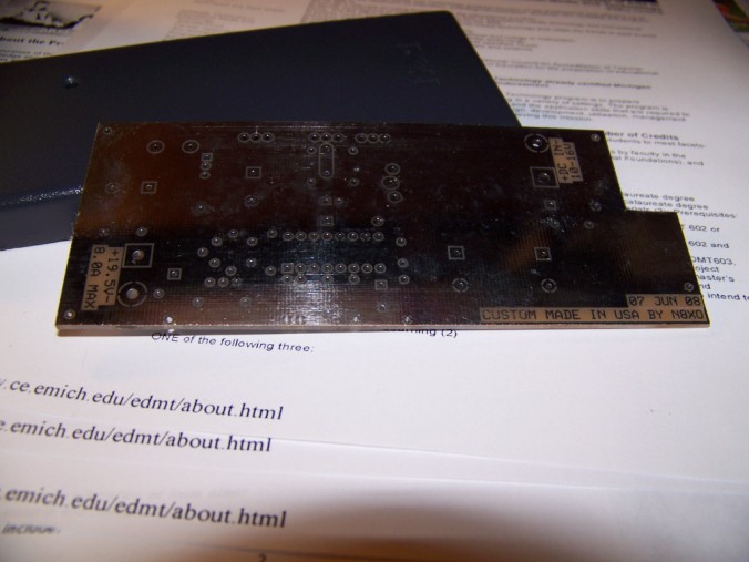

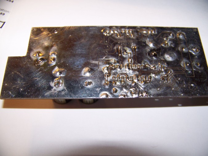

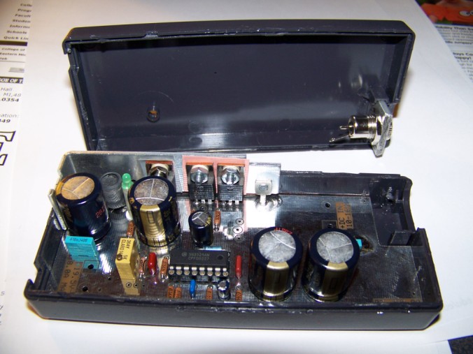

New 12-19V Boost
All:
Here are a few pics of my new 12V to 19V DC-DC Uppie I am doing for a laptop. I gutted several old Dell PA-1 & PA-2 AC-DC Laptop powerr supplies and re-did them with the aforementioned 2-F topology. Since making my own pc Boards is a royal pain in the a$$, I decided to do them in Express PCB, and have Them professionally done. Double-sided, plated through, but no silk-screening, and no solder mask (who needs 'em anyway?). 6 boards for a little over US $110.00. Can't wait to finish them in time for Field Day.
Comments, Please.

Hi Steve
Nice work as always, PCB looks like DIY, without silk and solder mask, I always like plated holes, makes life more easy. Is that heatsink big enough? Will you take one more pic when finnished? Maybe take output ripple at full output? Anyway look great and I hope it works that way to

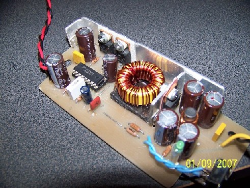

Actually, this won't work as a boost converter if your earlier explanation still is true (wound like a push pull transformer). It is actually a forward converter.
Think of what happens with the voltage on the other side of the primary when one side switches to ground. For 12V input the other side tries to go to 24V. But still - there is leakage inductance so regulation will still work just as in a half-bridge or push-pull without output inductor. The ripple current will be quite large though and it won't scale well. The core used should be ferrite for best performance. And you could add a filter inductor after the diodes if you want to be able to drive it in continous mode. Output voltage is limited between Vin and Vin*2.
Actually, it DOES work. This is the second such supply. The best description of the circuit would be a 2-F interleaved flyback. It is ~90-95% efficient, and is based on several related designs already available. Original idea came from N8XJK's booster appearing in Nov '04 QST. Other idea came from ST App Note for a new 2-channel PWM chip for just this purpose. My twist on this was to wind both inductors on the same toroid core in anti-parallel. Their common point goes to +Vin (~10-16VDC), and each end goes to the Source-Cathode junction of a pair of MTP75N06s and an MBR2545CT Schottky diode. V(flyback) is limited to 19V by clamping action.
Here is a pic of the original working model.
I didn't say it doesn't work - just that it isn't a flyback any more. 🙂
"My twist on this was to wind both inductors on the same toroid core in anti-parallel."
That is a big difference! When one transistor is on the other end will spring up to 24V. Leakage inductance limits the voltage/current though. So it does work, but not much as a boost converter. Stored energy in the core will go to the output but most will be delivered in forward mode.
If the cores are separate it will work as a boost though.
