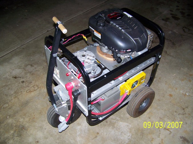

Here are some pics of the Gen-Set.
1) Finished Gen-set

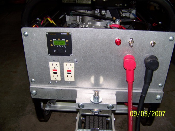

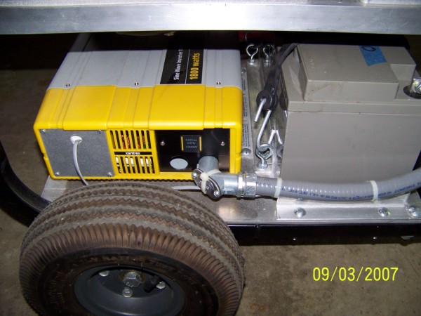

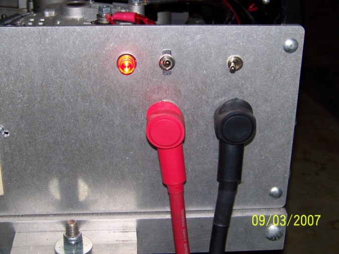

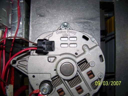

3) DC Output Posts and alternator light (kinda low-tech, but it works!) The left switch is the alternator field's on/off switch, and the right switch starts, stops, and runs the engine. The inverter can be switched on and off independently of the alternator and engine, thus yielding totally silent power (minus the inverter fan's noise).

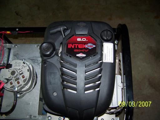

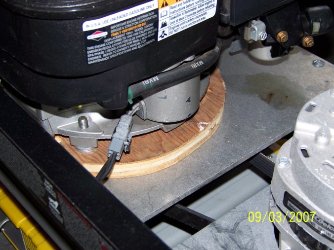

6) The Engine: a Briggs & Stratton 6HP OHV vertical-shaft with electric- and pull-start. It has a 0.5A "alternator" coil to recharge the starter battery. Of course it is disconnected in favor of the slightly higher-output Delco. 😀
