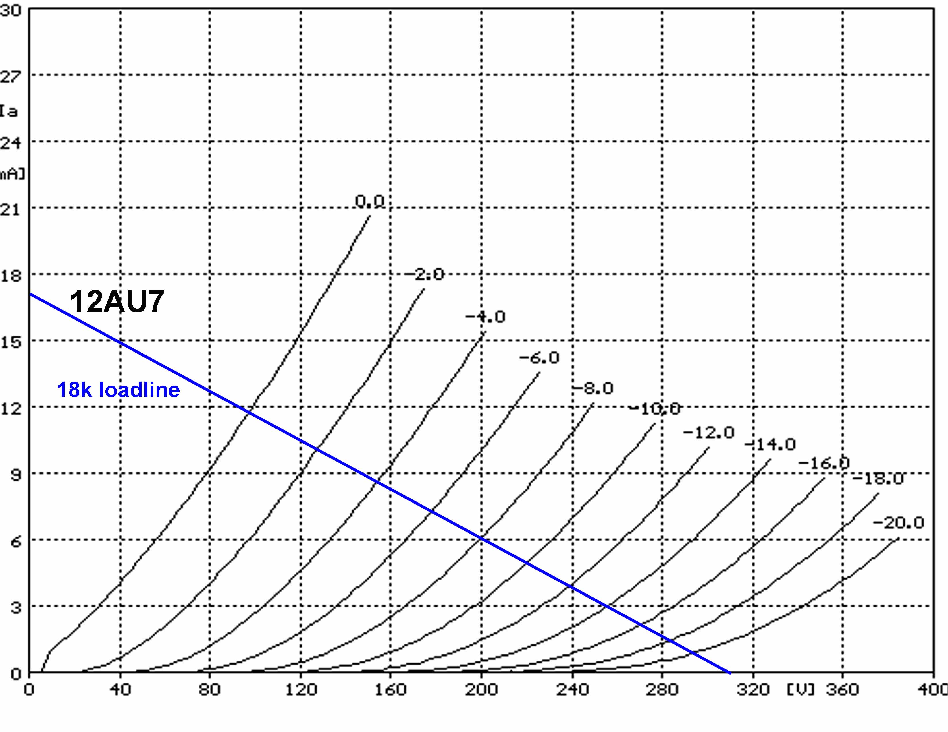

The circuit can work if calculated properly. I'm going to ignore the handwritten numbers and assume the input tube is a single, not 2 paralleled sections.
With 420V PSU and 195V at the plate (as you said in previous post), the input tube is drawing roughly (420-195)/(15k+18k) = 6.8mA. The B+ to the tube is 420-(6.8 x 15k) = 318V. With the resistors shown in the cathode, the tube is biased at (6.8 x 1.38) =-9.4V.
See the load line attached. The operating point we just determined doesn't quite exist on that plot, but it's in the ballpark with differences in tubes, etc. And it's not a bad operating point for that tube, although I would have chosen a larger plate load and lower bias. But it should work as is.
If any of the above assumptions are not what you have in there, just use the calcs I gave to figure out what you have.
There is no need to parallel the input tube for more current (why do you want more current?), you can draw all the current you want through one section. Personally I don't see much advantage to currents much higher than 7mA, in fact I run mine usually at less.

Thanks for the help, dgta.
I confess these were the first tube amps I'd worked on. It was a steep learning curve. I've since built a pair of Dynaco Mark III's and an 8b. The Mark III's sounded better, and the 8b MUCH better. That's when I decided to go back to the VI's.
Some things you should know. My actual b+ is 535. I inserted a 5.6k 5watt resistor upstream of the schematic which gave me 413 volts. Aping your math at 6.6ma and 195 volts the load line gives an operating point closer to -8 volts, (which is what I measured from the grid to cathode).
As for the paralleled tube that wasn't my idea, it was the strategy of the man who gave me the circuit. I can cut the connections to the second triode very easily. Do you think that might help?
As for the circuit. Since I'm willing to build a new driver circuit. Is there one you might suggest? I would rather stay with a non-regulated circuit that is without PCBs or transistors. I just don't know enough about them yet. I have a pair of Tom Christiansens Maida PCb boards, so I'll get there.
And if I haven't run out of questions where did the 1.38 in your calculations come from?

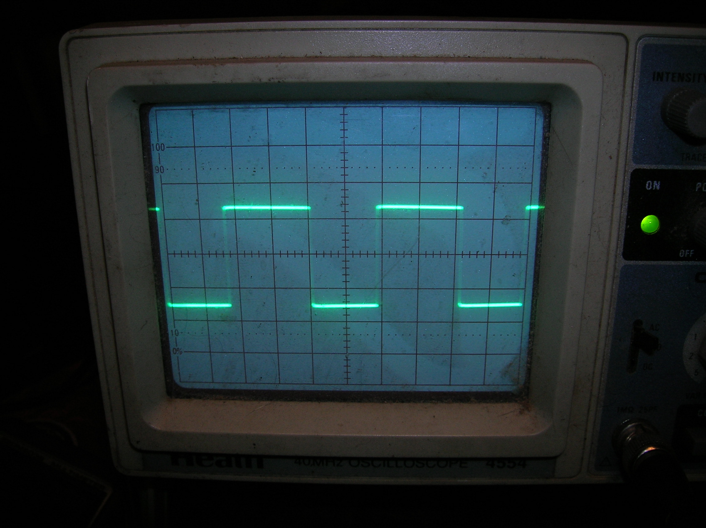

Oh, and one other thing. I checked to make sure it wasn't frequency related. from 20 to 20k I didn't find any ringing or oscillation. So it seems the harshness might be the product of the circuit itself, or bad tubes?
Nothing wrong with 8V. But measure cathode to ground when possible, to avoid loading a high Z circuit. Unless you are sure the voltmeter has at least 10M impedance. It's the same voltage.

If you can't calculate the global feedback, measure it. Measure the overall gain (input to speaker terminals) with and without feedback.
Once you have those 2 numbers, you can use an on-line calculator to get the dB number from the ratio.
I cut the feedback a little and got the center back. I would no longer characterize the sound as harsh, but still a little too bright.
With an input of .007 volts at 1k without feedback I got 4.04 volts output. With the feedback in place I have .93 volts output.
