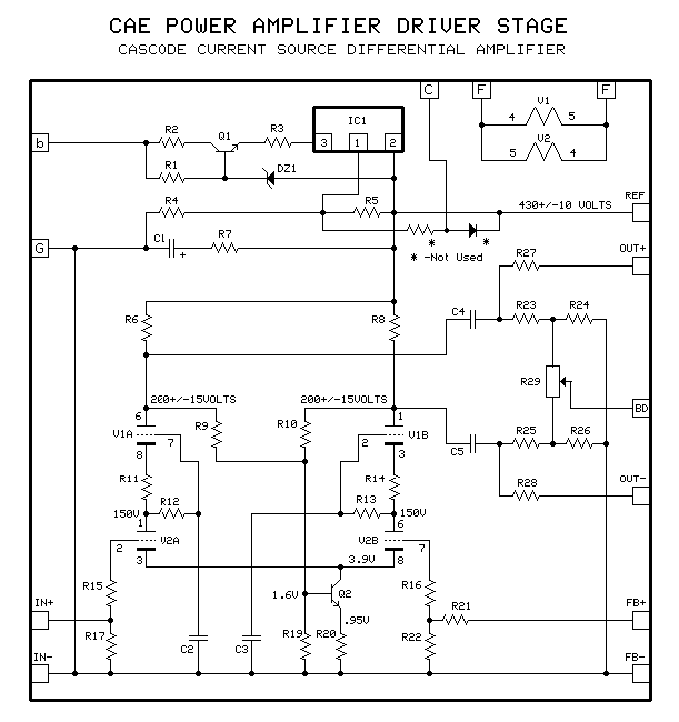

I cut the feedback a little and got the center back. I would no longer characterize the sound as harsh, but still a little too bright.
With an input of .007 volts at 1k without feedback I got 4.04 volts output. With the feedback in place I have .93 volts output.
I don't know if you are familiar with this music but with Aimee Mann its too bright. With Tori Amos it seems much better. I'm going to try some acoustic jazz and then a little night music next.
My Friend Rob at Tube Depot thinks the Solen's might be a bit bright. Not as bright as the orange drops though. He recommended metalized polyester. Specifically Mallory 150 series. Any recommendations there?
Kevin
So open loop gain is 55dB and closed loop gain 42dB, which means 13dB of NFB. 42dB gain is a bit high, perhaps you should increase the NFB either locally, globally, or both? 30dB is the norm for a pwr amp.
Your square wave looks just a tad fast, hinting towards a slightly bright sound. Perhaps you should tweak the coupling cap values before cap types?
SemperFi,
Yes! The amps are too bright. When you say too fast do you mean that the horizontal part of the square wave is too short? I've been playing with the feedback trying to warm the amps up and it didn't work. I was thinking about the cap values today. The original caps between preamp and phase splitter were .1uf orange drops. Too bright. I changed to .12uf Solens. The coupling caps between the phase splitter and outputs are .33uf Solens.
So would the cap values need to be larger? Like .22uf first and .47uf final? When I get the brightness fixed then I can tweak the feed back.
Thanks very much, Kevin

I think the difference between the orange drops and the Solens was more the value than the manufacturer. .1uf to .12. I have some Mallory 150 .22uf caps. And the original Mallory .47uf caps from the Mark VI boards. I'll try those tonight.
Kevin
