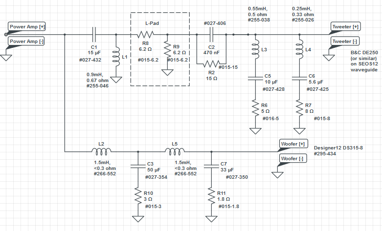

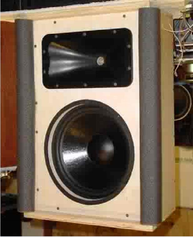

if it turned out like a "big Dynaco A25" - then that would be nice - you could even use an aperiodic vent. Maybe a mild notch filter on the mid-tweeter
Consider... a 12" Econowave.
The $75 Dayton DS315-8 has been used in a few econowave designs with the $10 PRV WG35-25-B or $13 Dayton SEOS12 waveguide and the $100 B&C DE250-8 1" Polyimide compression driver.
--The "expensive" $100 B&C DE250-8 has great sound with a wide range of proven crossover circuits to justify the cost.
--The $40 Dayton D250P-8 1" Polyimide Compression (2-bolt & screw)Horn Driver will work in the econowave crossovers, but you will get a "rougher" sound.
