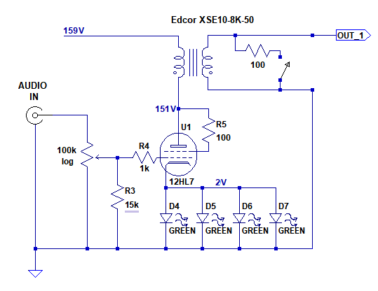

I changed the grid leak resistors from 100k to 15k, installed from the pot wiper to ground.
I've attached a schematic of how it's wired up. R3, which was originally 100k, is now 15k.
With the 15k resistor in place, the change in sound is dramatic. The amp is now noticeably brighter. However, I'm sure the bass response is still all there. (Since the source impedance is 500 ohms, I wouldn't expect to lose the bass into an approx. 13k ohm load.) In the end, this sounds far better with the 15k ohm grid leak. Actually, the amp sounds great now. I'm very happy with it.
The taper of the pot is now pretty weird. The volume goes up very slowly as you turn it up, then suddenly around 2 o'clock it finally starts to get loud, getting much louder between 2 and 3 o'clock, then from 3 to 5 o'clock going smoothly up to full blast. Anything below 12 o'clock is pretty quiet, and there's hardly any difference in level between about 9 o'clock and 11 o'clock. I'll try putting an additional 15k resistor from the pot's top contact to its wiper. We'll see how that works.
I think this experiment proves that the 12HL7-triode's Cinput is high enough that using a 100k volume pot causes an audible rolloff in the high frequency end. Even with my battered hearing I immediately heard the difference. The 12HL7-triode's Cinput must be at least 200pF, and is likely higher than that.

I've updated the little beast. It had a subtle problem. I think that as the amp was left on for more than a few hours, the 12HL7s must have begun to draw grid current or something. The amp would begin to sound very 'dark', especially through my Fostex T50RP headphones (50 ohm, planar magnetic), which tend towards 'dark' by themselves. It got to be too much. So...
I figured I had the 12HL7-triodes biased too hot with -2V Eg, using four green LEDs paralleled per side. The 12HL7-triodes were drawing about 50mA each, with about 145V on their plates.
I replaced the cathode LEDs with 82 ohm resistors bypassed with Nichicon MUSE 470uF 25V caps. The Ip went down from 50mA to 40mA. I raised the plate voltage up to about 165V. The grid bias is now about -3.3V (+3.3V at the cathodes). The 12HL7 plate+screen dissipation is now about 6.4W, down from a little more than 7W.
Now the character of the amp's sound doesn't change after running for several hours. Lesson learned about these high-gm RF pentodes: Give them enough grid bias.
I did notice the Fostex headphones still sound too boomy in the bass with orchestral music (I listened to some Berg and Webern last night, which was fun). I'm going to replace the 470uF cathode bypass caps with 1000uF (also Nichicon MUSE), and increase to 1500uF if I have to (do I have to?).
Replacing the 470uF cathode bypass caps with 1000uF tightened up the bass nicely. Those DG Berg and Webern recordings still sound quite plump, but in better control. I'm sold on this, at least for now.
I also tried experimenting with an 0.1uF 400V film RF bypass cap from the B+ tab on each output transformer primary to signal ground at the tubes' cathodes. It made the output sound brighter, for sure. (Why?) Maybe I'll reduce the value to 0.01uF and see if I like that better.

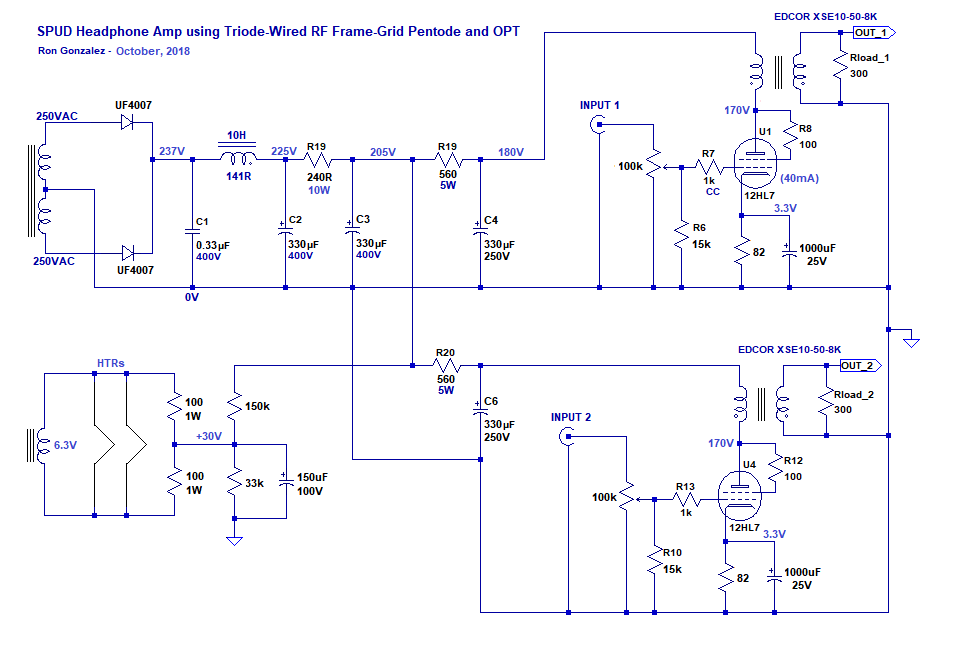

Schematic of latest revision. Just in case anyone's interested.
Lower plate current: down to 40mA from 55mA.
Higher plate voltage: up to 170V from 145V.
Green LEDs for cathode bias changed to a cathode resistor with bypass cap (Rk = 82R, Ck = 1000uF).
The grid bias voltage was changed from -2V (using green LEDs) to -3.3V.
The result of the above changes is:
- Better balance between channels even with somewhat mismatched tubes.
- An overall more 'relaxed' sound.
- Also, the tendency of the amp's sound to get 'dark' after hours of use is gone. The tonal balance doesn't change after initial warm-up.
I like this version much better. Perhaps I was hearing grid current effects with the LED cathode bias of only -2V. Or perhaps drawing 55mA through the little Edcor transformers was causing them to saturate. At any rate, this version seems better behaved.
