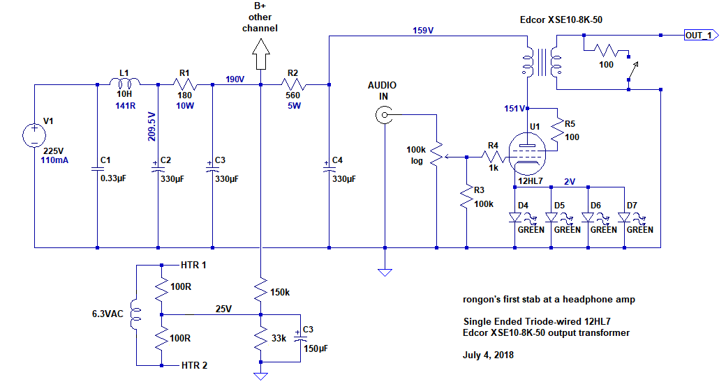

Last night I installed some nice enamel-coated 100R 5W wirewound resistors across the OPT secondaries (from 50 ohm tap to Common). The idea is to smooth out the impedance wobbles of my Sennheiser HD650 cans, and to bring the HD650's 310 to 500 ohm impedance down closer to the nominal 50 ohm impedance of the OPT secondary.
The strangest thing happened. The resulting sound from the HD650 is improved quite a bit. It was really damned good. Now there's enough bass. While still a tad bright sounding, the tonal balance is quite good. Apparently the 100R across the secondary does help optimize the OPT for that load, and I enjoyed the sound very much.
But when I connected my other headphones, 50 ohm Fostex T50RP, I noticed they now sounded dark with overactive midbass (in the 100Hz region maybe) and rolled off highs. They didn't sound like this without that 100R resistor.
Any idea what's happening here?
I'm thinking of mounting a DPDT switch near the output jack so I can switch in/out those 100R resistors.
Adding the 100R resistors reduced the gain a bit, but the amp's gain is still adequate. With the Fostex cans, which aren't very sensitive, turning the amp up all the way results in a sound that's still subjectively clean-sounding, but would make me well and truly deaf if I listened that loud.
Well I would assume it's having the same effect on the Fostex headphones as it has on the HD650s, but the Fostex headphones are already at around the right impedance. If we do a simple parallel resistance calculation, you're at around 33.33 ohms.

I am guessing they are just dark headphones. Look at the db vs frequency, it's highest is 100Hz and the midband is -10db down. Frequency looks flat out to 10k so I don't know if there is some sort of compensation built in?
The 12HL7 has an impedance of 1.3k, so the reflected back impedance of a 33 ohm load would be ~5k which is adequate for loading a triode. Maybe the distortion has changed or something where the sound at low frequencies is now more distorted? The 100 ohm resistor value is a tradeoff, ideally with the 50 ohm headphones you don't want it there so maybe make it switched? That way there with the 50 ohm headphones you can take the resistor out of circuit but with the 300 ohm headphones switch it back in to smooth things out.
That all makes a lot of sense. The T50RP are 'dark' sounding headphones, but usually in a 'good' way (as in 'mellow sounding' as opposed to 'muffled'). Did you notice that its impedance curve is ruler-flat at about 52 ohms?
I think I will put in that switch. I have some suitable mini-toggles on hand. It could be that the 100R across the secondary is making these 50 ohm headphones unhappy, but might do nice things for some 32 ohm headphones that sound too harsh/zippy. A tone control of sorts. Definitely worth trying.
Thanks for your input on this.
Oh, thanks. I don't think this amp can make 1W out into 50 ohms. I haven't measured it yet, but I calculate that with -2V grid bias, triode mu of about 30, and OPT stepdown ratio of about 12.5:1, that the most voltage swing I could possibly get at the output would be in the vicinity of 3V rms (2V pk input * 30x gain = 60V pk into the OPT primary, then 12.5:1 stepdown ratio = 60/12.5 = 4.8V pk = 3.4V rms). That equates to 230mW into 50 ohms, or 38mW into 300 ohms.
I agree that is plenty. On this amp, turning the volume all the way up when fed by a DAC with fixed level output results in a very loud but still subjectively clean sound from the headphones. That's louder than I'd ever want to listen, so I figure the gain and available headroom are at a spot where it's good enough for my purposes.

I wired in that switch with 100 ohm resistors. In doing so, I forgot which way is with the 100 ohms in, and which way is out of circuit. So I have to rely on my ears to tell me which is which. Well...
I think I can just barely tell the difference with the amp driving the 60-ohm Fostex cans (the dark sounding ones). The bass sounds a bit looser and more boomy one way. But it's very subtle.
Switching to the 300-ohm Sennheiser cans, the difference is a bit more apparent, but more subtle than I thought it would be. I can definitely hear one switch position is 'softer' sounding than the other. Just the slightest bit different.
I think that means your idea of putting those 100 ohm resistors across the secondary certainly does no harm, and may be doing some good (smoothing out impedance variations in the load).

12HG7 or 12GN7 are pin-compatible with 50% more transconductance - worth a try if you come across some. I didn't find a detailed data sheet with a quick web search, though.
BTW, 1.3K plate resistance will transform to about 10 Ohms output impedance, so no surprise that 100 Ohm load has limited effect. A good article on the interaction of headphone and source impedance here: NwAvGuy: Headphone & Amp Impedance

I was shying away from 12GN7 as I thought that the higher the gm, the higher the possibility of problems with microphonic noises. Of the three, 12GN7 has the lowest rp, but 12HL7 is really close. 12HG7 has slightly higher rp than either of the others.
I should try a pair of 12GN7A to see if the slightly higher triode mu makes an audible difference.

If the OPT's turns ratio is 12.6:1 (8k:50 ohms, or roughly 160:1 impedance ratio), then wouldn't it apply that same 160X transformation to the 12HL7's plate resistance? If so, then 1300 ohms/160 = Zout of 8.125 ohms. Maybe more like 10 ohms after transformer losses, lower than expected tube gm, etc.
So now I can understand why the Fostex cans with their roughly 55 ohm impedance sound slightly more woolly and loose when run from the 12HL7 amp than when run from my Objective2 amp with its Zout of roughly 0.5 ohm.
On the other hand, it's pretty easy to understand how the HD650 cans would sound fine through either amp. Their roughly 350 ohm impedance is a full 30x the 12HL7 amp's Zout. That might be beyond the law of diminishing returns as far as damping factor goes.
