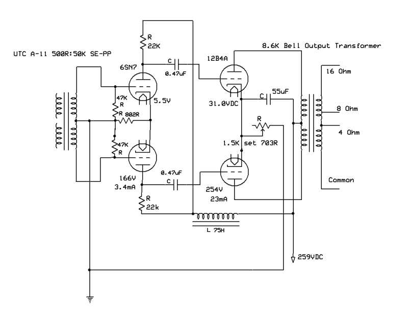

I have a 6SN7-12B4A PP amp on the breadboard at the moment and I am thinking about committing it to a more permanent form with a second channel (wow, stereo). Would anyone care to suggest alternatives to the scheme attached before I take that step?
Thanks,
Michael

Looks interesting 🙂 What will you drive it with?
BTW, before any (other 😉 ) smart **** points it out, it looks as if you've omitted the grid leaks. Also, is the choke the only decoupling?

I can't see any glaring mistakes...so
I would go right ahead and build the second channel and listen to it for a while....a real while like a month or two.
You can ofcourse change a thing or two...BUT I like your schematic a lot (and choice of tubes). Simple PP with a transformer doing the splitting early on..Wonderfully simple for a PP.
You can always apply the suggestions that may pop up later! Like a CCS or VR shunt reg PSU, grid stoppers...bla, bla bla. or WHATEVER...but they will remain suggestions..
Right now you have a gem in the making as far as I am concerned...
I am as always curious what people will suggest though.

Drive and grid leaks
Drive is a worthy question. I don't know yet. On the breadboard I am taking my musical input from the headphone jacks of an old Sony onebox amp/cd. May be a problem driving it with a CD player? Suggestions welcomed.
I did omit the gridleaks on the 12B4A, they are 470k.

Driving it...
You'll need something that will be happy with that 500ohm (very low) input impedance. Of course a headphone stage will do, or there are some valve preamps with very low output Z (but don't ask me to name one 🙄 )

Where's the driver's PS bypass cap? 😱 Sure, it's balanced, but gee, it'd be 20 times more effective at keeping signal balance if you put the choke in the 6SN7's cathode circuit. As-is, you'll get nastified distortion for small imbalances!
Speaking of balance, the cathode bypass on the 12B4s is unnecessary if they are class A. (If class AB, you'll need a fixed bias supply instead. And I would recommend AB, given the low power handling of this tube.)

Hi Tim,
By PS cap do you mean a cap between the 75H choke and the plate resistors? I tried a 25uF polypro/oil there, both as connected to star ground and to the cathode of the 6SN7 above the Rk. Sort of empirical design method. Anyway, 2nd harmonic voltage increased from 16mV to 56mV and 28mV respectively with 8.2V output into a 16 ohm load. Third harmonic voltage increased from 46mV to 173mV and 116mV. Other orders were less affected.
Another schematic omission- I have a 50R pot between Rk and the cathodes on the 6SN7. Balancing it has a large effect on second harmonic. I tried without the 75H choke and with a 15H choke in the cathode load of the 6SN7. Both led to higher distortion, although I may have made mistakes in the implementation. I thought a choke in the cathode should be very effective? I also tried the 15H choke in the cathode load of the 12B4. Same result.
I thought I was running Class A. I get something around 4W before distortion starts climbing. When I inadvertantly connected the 55uF cap to the star ground while rearranging the circuit I had a 300% increase in distortion levels. It took me awhile to figure out what the heck was wrong with my setup.

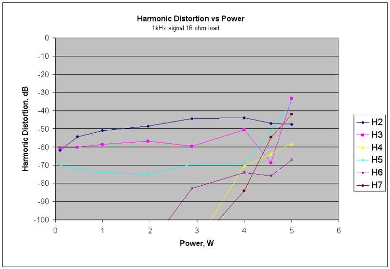

Here is a distortion profile of the current setup. I don't really know if this is "good" or not, but it is fun to measure while trying to think of other circuit changes to try.
Michael
Michael

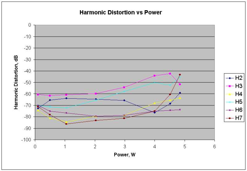

I decided to retry a 15H choke in the cathode circuit of the 6SN7 this morning. To reminimize distortion I had to raise the total Rk to 2118 from 740 (both plus the 50 ohm balance pot). This changed the bias voltage to 8.2 from 5.6 volts. There was a significant increase in 2nd at all power levels, a decrease in 3rd at higher power levels and a decrease in 5th until clipping. Any comments on the reasons for these changes?
Haven't listened to it yet because it's too early in the morning.
Michael

new schematic
Tim,
Here's the schematic as built. May still contain omissions or errors, but I think it's right. I have to say that there is no doubt, distortion increased greatly when I removed the cap on the 12B4 cathode. Why I am unsure.
Adding the choke to the cathodes of the 6SN7 required a major revamp in operating point, as seen from the voltages and current on the new schematic, to reminimize distortion. Any thoughts as to why?
I have listened (quietly as I live in an apt) to a couple of CDs now. Not sure if there is any noticable change, but seldom play at the volume levels where the major changes took place, except the general increase in 2nd that is.
Michael

For a fair comparison the operating points should be the exact same. BTW I don't know anyone who designs experimentally based on measured distortion - it's not like you're trying to get an exact figure. Just because distortion is low doesn't mean it's working right. (But that statement just doesn't sound right
The only modification necessary should be to subtract the choke's DCR from the 6SN7 bias. The original shows 802R, while your choke measured 703, so a 100 ohm resistor in series should bring it up good.
Uhm...hmm your 6SN7s are biased so far off, plate is only 211V? Yikes! You get far less distortion when it's down around 1/3 to 1/2 times supply voltage (which in this case is around 250V). No wonder it's so distorted, you *barely* have enough headroom to drive the 12B4s.
Aside from that, I wouldn't doubt it if the plate choke is causing the trouble - I'd replace it with a 1 to 4.7k resistor of adequate wattage and bypass it to ground.
Tim
