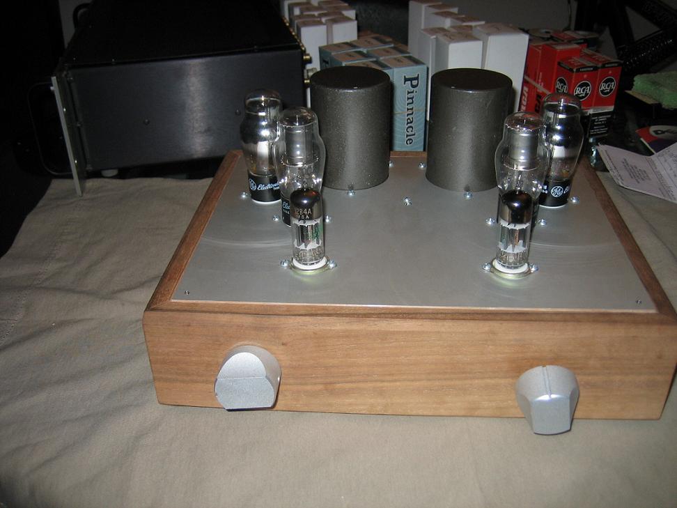

Bryan said:I think I am loosing my mind!
This project is pretty much finished, and now that I am listening, it seems that the bass is a little off....
Attached is the current schematic as it is now built.
Both chassis are done, and looking good. The sound seems a little flat in the lower end. The only changes I've made from the breadboard are removing the cathode bypass, adding in a DACT 50K attenuated pot, and I've changed the output coupling cap to a 2mF Mundorf Silver. I seem to be loosing bass response somehere. Am I missing something obvious, or could this simply be a matter of waiting for new parts to "burn in?"
I am driving my ARC VT100 MK II with an input impedance of 100K.
Any thoughts?
if doubling of 2uF doesn't help-try to temporary substitute CCS with plain resistor,then compare sound hehe,or just bass ;
good CCS is not necessary good for all stages , or all tubes.....
I have built most of the published 12b4 linetage on this forum. The only one that works is Brett's: that preamp has bass, highs, mids, the lot... I don't even have the luxury of using a CCS.
I don't think putting a 2mf coupling cap will do the trick (just my 2... )
BTW, I am using the ordinary 12B4 without the A suffix. They are not noisy as some people may suggest...microphonic, yes, only if you tap them.

OK, so I figured out the problem... I was using my mp3 as a source during the test. I know, I know....
Once I put the pre back into the chain, I was AMAZED. This thing sounds better than anything I have ever heard... Seriously. From top to bottom, the sound is GREAT. This is with only about 1 hour of play time on the finished version, so I imagine it will sound even better with a few days use...

Sorry about the delay, but things have been busy wioth Grad School, the holidays, and the family. Too much **** to do, and not enough time!
Anyway, here is the PS Schematic as promised. I will try to get the Audio Schematic up this weekend. The only other components are the timer relay mute, which keeps the output shorted for about 30 seconds and then instantly mutes the output when I power off the pre-amp. The B+ supply has enough reserve to maintain voltage during the .5 seconds it takes for the mute to activate, so no bumbs and thumos on the output! As mentioned earlier in the thread, the 12B4As use regulated DC, with one regulator sharing the load of both tubes. This is the only spot where things are not completely dual mono...

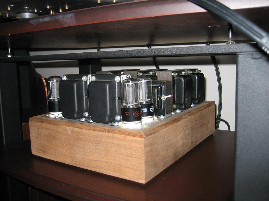

Sunrise, Thanks for the comment! I am enjoying it more each time I power her up. The sound has come together quite nicely in the past couple days, and she is sounding very very good!
Mark,
That's per channel, probably not including the 12VAC fillament transformer for the 12AX4s.... I think you could get away with 6AX4s and use the secondary on the 369EX if you wanted...
When I biult the preamp, I wanted to do an "all out, cost no issue" design. The total product was VERY expensive, with boutique parts like rikens, DACT attenuator, surgical solid silver teflon insulated wire, and Mundorf caps. I built it over a long period, so the daily cost was little when I consider that the build lasted such a long time, and the knowledge I gained was worth every penny... Hopefully now I won't need another pre for a LONG LONG time.
