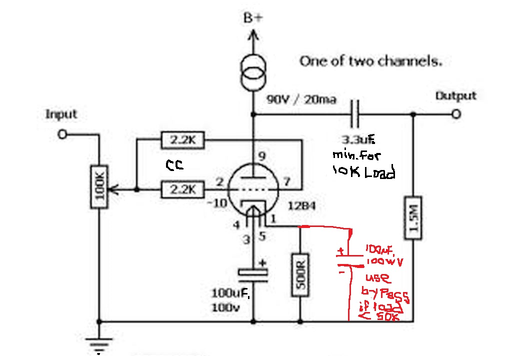

The cathode resistor will not reduce gain with a CCS anode load, but it will still increase output impedance.
Right. So is there degeneration? If not, you can just bypass the cathode to avoid high Zout and it will make no difference.
But is Zout is calculated the same way when you have an rk that's really a fixed voltage source? I've got to think about that one.
Yes.
Rk is not a fixed voltage source. It is a resistance with a nearly fixed current through it. It is the resistance which matters, not the fixed current. Bypassing the cathode resistor would have almost no effect on gain, probably little effect on distortion, and a big effect on output impedance.
The discussion has prompted me to revise the 12B4 preamp, slightly.
FWIW, I recommend a 4.7 μF. MKP bypassed by a 0.33 μF. PPFX MultiCap as the O/P coupler. Those with "deep pockets" are (of course) free to use Mundorf or other "boutique" stuff.
When a cathode resistor bypass cap. is used, Nichicon KZ series seems obvious to me. Anyone with "Silmic", "Cerafine", or "BlackGate" on hand can, naturally, use their stock.
BTW, the CCS used depends on how awkward the downstream load is. When driving the nasty 10 Kohm IHF "standard", a cascode (FET or BJT) CCS is appropriate. Less problematic loads are "good to go" with a 10M45S CCS.

Hi Eli,
I was planning on using the cascode MOSFET design but I also would like to incorporate the bypass cap if it reduces Zo and does not affect gain. I would like Zo as low as I can as I don't know what the preamp will be driving in the future.
How much is the bypass reducing Zo by?
If Zo is 4K when unbypassed what is Zo when Rk is bypassed?

Under the circumstances described, the O/P impedance reduces to approx. RP. I "make" that value to be about 1100 Ω. That's anything but shabby, for a common cathode circuit block. While not quite 1:10 for the fugly 10 Kohm IHF "standard", 1100 Ω is certainly adequate. Also, the 20 mA. IB allows for a good bit of cable capacitance to be handled.

1. It's the pseudo dual mono mentality. The "iron" PSU is pseudo dual mono, too. Channel separation can only benefit.

The gain will be the same as the conventional ccs output (your loadline is still essentially horizontal). Output impedance is approx 1/gm of the mosfet.
Not sure what you mean in regards to the loadline. The plate voltage is 90V and plate current is 20mA which gives a nice slope, not horizontal.
If the output impedance is so low and the gain is still the same why isn't everyone employing this on their CCS plate driven stages?
This is my MOSFET http://ixdev.ixys.com/DataSheet/DS100182A(IXTY-TA-TP08N100D2).pdf
It lists Gm as 330-560 mS. So my Zo = 3-1.7 ohms? That can't be right.
I was assuming you were asking me to compare mu out gain to an example to conventional ccs gain. If you are using a resistor just draw the corresponding load line and determine delta Vp/delta Vg at you chosen operating point to determine gain. Then do the same for a horizontal load line and determine the ratio between the two to provide a comparison.
Using the 'mu follower' connection won't give you 1/gm output impedance. This is because the 'follower' is not a true follower but modified. This raises the output impedance; The important ratio is valve anode impedance vs. anode resistor (the resistor driving the 'follower'). If these have the same value then you get roughly 2/gm as output impedance. Could still be low, though.
