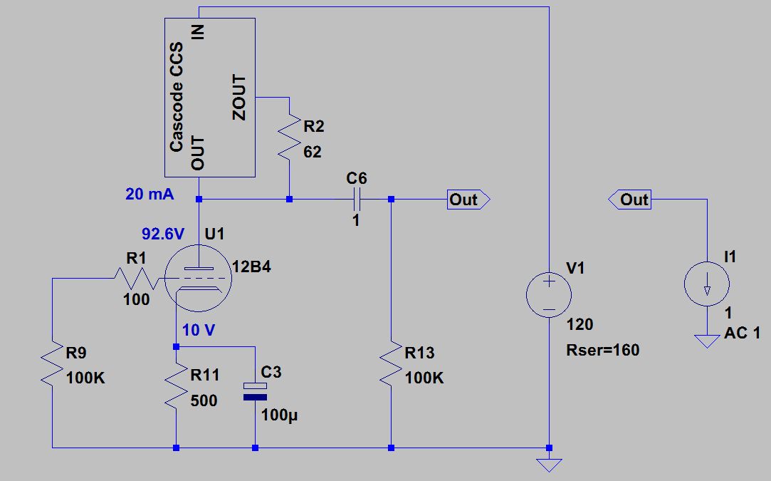

See my proposed schematic below
Questions:
1. What chokes/inductors are people using?
2. What PT secondary voltage are people using? From my calculations the design needs ~140V DC or higher for the B+. It seems a standard 120V AC secondary (or higher) would be good.
3. What do people like for biasing? 90V/20mA is going to be my starting point.
4. My output cap is 0.33uF with a 470K to ground. This creates a rolloff frequency of 1 Hz. Not sure why a 3.3uF and 1.5M are used on the original design.
5. What is the purpose of the 47nF “fudge factor” cap?
Thanks!

4. You need to take into account what it is connected to.
5. Raise the B+ voltage a bit.
4. My power amp has an input impedance of 68K. With the 470K pulldown resistor (ignoring the output impedance of the 12B4 as it is so low) this makes the equivalent input impedance 59K4. This is still adequate. I see your point though, if my poweramp had an input impedance of 1M it would be a different story.
5. I realize the 47nF cap is a filter cap. Is there anything else I am missing?

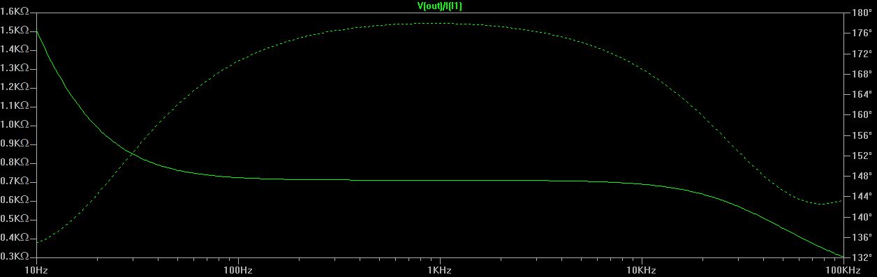

With cathode degeneration and a CCS load this preamp will have quite high output impedance so it will need a short output cable.
Both the mu and the plate resistance of the 12B4 are very low. The effects you describe have little impact, in this specific case.

12B4 has a mu around 6. A cathode resistor of 500R should give anode impedance around 4k. This is a bit high for a preamp output, but OK if short cables are used.

Since Rk is unbypassed Zo = Ra || (ra + Rk + μRk)12B4 has a mu around 6. A cathode resistor of 500R should give anode impedance around 4k. This is a bit high for a preamp output, but OK if short cables are used.
ra = 4K like you said, but what does Ra equal since Ra is the CCS?
Are you going to get degeneration with a CCS? With a good CCS I believe you won't. The CCS will force a constant voltage across the cathode R. In fact I don't believe you'll see any change if you bypass that resistor or replace it with LED bias.
The cathode resistor will not reduce gain with a CCS anode load, but it will still increase output impedance.
Ra is infinity (in theory) so Zo = ra + Rk + μRk i.e. 4k. If you want the cable alone to have an HF cutoff above 50kHz then you need cable capacitance plus amp input capacitance to be below around 750pF. Allow 250pF for the amp, then the cable must be less than 500pF. This could be 5m at 100pF/m. OK, not too serious a problem but it does assume that all capacitances are linear so HF rolloff is the only issue.ChrisM91 said:Since Rk is unbypassed Zo = Ra || (ra + Rk + μRk)
Isn't another issue that 4K is simple a high output impedance and will cause loses?The cathode resistor will not reduce gain with a CCS anode load, but it will still increase output impedance.
My poweramp has an input impedance of 68K. The 4K output impedance in conjunction with the 68K input impedance will cause a signal attenuation of 5.5%.
