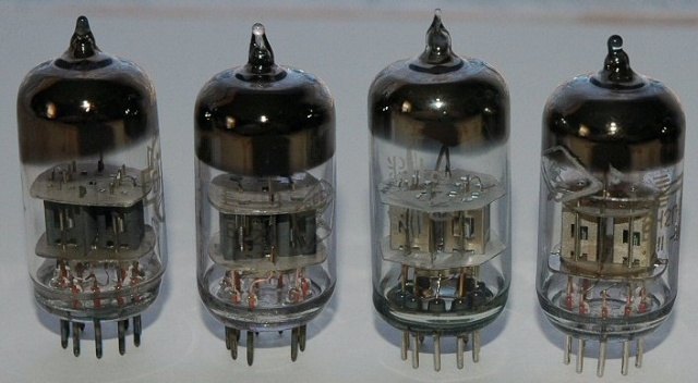

<<No single 12B4... has zero reaction into knocking the box its housed in.>>
You can't expect a tube to be silent if you tap the tube or even tap the box it's mounted on. Every tube with gain is going to have some response to vibration. The 12B4 is perhaps a bit more sensitive to vibration than average, but none of the ones I've tried has had problems like some 6DJ8, 12AX7, 6AQ5 or especially Type 27 samples that I've used in other preamps.

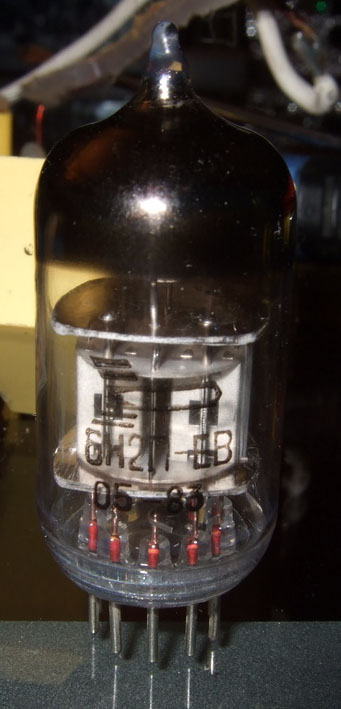

Salas said:My best so far is Russian 6N2PEV. Measured 83.5X gain in my Mu follower phono first stage, and I tap directly on its envelope with volume full up. Nothing!
I've wondered about using the Russian tubes. How do you compare these in quality of sound to the good USA 12AX7's or Euro ECC83s.
I did not feel any lack of transparency, but I have only used it in that phono and I haven't substituted 12AX7s or 83's there (would need some rewiring), so to know more. It has screen (pin9) between channels also and that helps in phono especially. Its only 6.3V for heaters (4,5). They will show 10-15% less mu than a strong 12AX7 in practice so there must be some care about level matching if comparing, among other considerations.

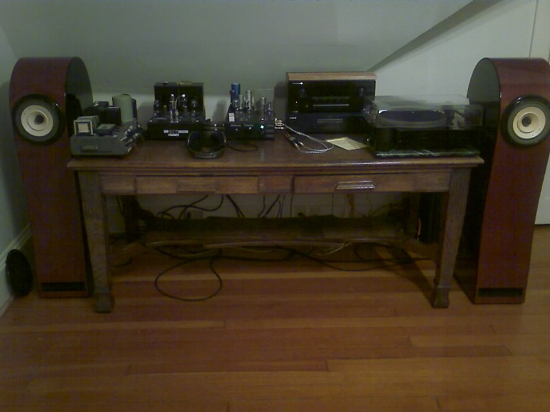

I'll answer questions in the reverse order, but to report to the group I just finished doing a listening test using my multi-(power)amp to drive Lowther PM2As. You can see the multi-amp on my web site. This pre-amp is truly awesome! Full on volume, I can't hear anything coming out of the super-efficient Lowthers. I thought at first there was something wrong with the hook up. Even running the 6DQ6B tubes, which require 23 volts P-P at the input to drive them, it rocks. [As an aside I really like the 6DQ6B--it sounds better in SE Pentode mode than either the 6V6 or 6L6.] Anyway, the only possible change would be to use ultra-grade chokes. I've got some on order from Hong Kong, but those will take about 3-4 months to arrive.
With respect to the power supply, give me a few days to complete proving the design and post it as an option. For this one I will have the power chokes available for sale, and I'm going to size it to a standard Hammond transformer #272BX. This is the best value transformer they make. It requires using a 2 diode rectifier and tying the 5.0v + 6.3V together for the DC heaters. If you want to use a 5U4 you can go to the 270FX instead. ALternatively, if you are not going to do a phono stage, the #272BX can work with a 5Y3 and DC heaters with a little more ripple. The Hammond transformers can be bought from AES (www.tubesandmore.com). I always buy all my transformers in January when shipping is free. By June I'll have custom power transformers made by my Hong Kong supplier. If anyone knows a cheaper place to buy Hammond transformers, please let all of us all know.
