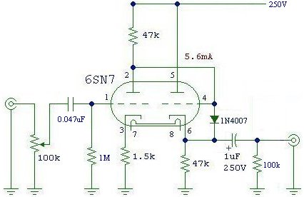

Other than rolling off the bass at 3.4Hz, what's the .047uF cap for?
Also, the 1M resistor that will alledgedly save you from catastrophe should the wiper go bad on the pot - if the wiper goes bad, you'll get no music... which would be a pretty good indication that something is wrong. Does anybody think they'd be running their amp for minutes or hours with an open pot?
In any event, a 6SN7, even with zero bias, is simply not going to destroy itself with 48.5k of series resistance. The extra resistor is silly, IMO.

Joel said:Other than rolling off the bass at 3.4Hz, what's the .047uF cap for?
Joel
I was trying out the variation on this circuit that BernardB posted here (bottom circuit):
http://www.diyaudio.com/forums/showthread.php?s=&threadid=67433
I thought the .047uF input cap was to prevent any DC from the input (not that you should have any)? Other than that, I don't think having it roll the bass off at 3.4Hz is a bad thing. Kind of like a sub-sonic filter? In that case, why don't designers use something that rolls off the bass at around 10-18Hz? Most speakers can't reproduce that anyway, just curious.
I have also not changed the output cap to the suggested 5uF from the 1uF that I already have in there. Just waiting for them from Angela.
Glenn

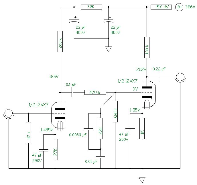

Back to tubes, I found this phono preamp schematic, and it looks simple.
Glenn

Simple, yes, but high output impedance and high distortion. I would guess that the noise isn't so great, either. Rule of thumb- if there aren't at least three tube sections in an RIAA amplifier, there's a severe compromise somewhere.

DC on output for phones?
Hi all-
I'm back to the 6SN7 preamp/headphone amp.
Please refer to post #82 for the schematic.
I installed a DPDT switch for the outputs to switch between the RCA jacks and the headphone jack. The RCA uses a 1uf electro cap, and the headphone jack uses a 220uf electro.
The wierd thing is, I'm getting ~130VDC on the output of the 220uf capacitors for the headphones! When I switch to the 1uf caps for the RCA line out jacks, I get 0VDC at the jack.
Any ideas as to what is going on?
Why would the 1uf block the DC, and the 220uf not?
I don't think I want to plug my headphones into 130V!
Glenn

Well, you do have a 22 second (probably more) time constant there. It might take a while to settle to zero.
SY said:Well, you do have a 22 second (probably more) time constant there. It might take a while to settle to zero.
Yeah, and if you plug in your headphones during that time, pop goes the weasel. There is enough stored charge in 220uF to zap a little voice coil. This kind of circuit is risky for sensitive headphones. You could put a shorting relay with a timer on the output to provide a time delay for the big output cap to charge. Or, put in maybe a 2K shunt ground reference resistor instead of the 100K to speed up the charging time. The 2K in parallel with your 32 to 300 ohm headphones won’t significantly reduce levels or increase distortion. Then, and this is a bit brutal, you can add a pair of series zeners (back-to-back) across the output line to clamp start-up transients. For Sennheisers maybe a pair of 8.2 volts zeners; for Grados, lower.
Joel said:Also, the 1M resistor that will alledgedly save you from catastrophe should the wiper go bad on the pot - if the wiper goes bad, you'll get no music... which would be a pretty good indication that something is wrong. Does anybody think they'd be running their amp for minutes or hours with an open pot?
That's not the point. It's not the presence or absence of music that we’re worried about; it's the sudden large step-function jump in the DC levels as the grid bias goes from a ground reference via the pot suddenly to an open condition. When open, a grid will find a voltage point of equilibrium where positive and negative grid currents cancel. This is typically between -1.0 and 0 volts of equivalent grid bias. If your grid bias is normally 3 or 4 volts (a wild guess - I didn’t do the load lines on the schematic in post #82), you just snapped a 3 volt transient into your input. The output, of course, will react to that with gain. With headphones on, it might sound like a lightning bolt in your ear. Even worse, if the pot is intermittent, as you turn it you’ll get a series of makes and breaks, and you’ll experience multiple lightning bolts per second. More than one tweeter has been lost through the decades due to intermittent volume pots.
I agree with SY. For a couple of cents, keep the safety resistor even if you drop the input coupling cap.
Thanks for the answers.
Yes, I did notice that the DMM I had on the circuit was headed down slowly. I guess I'll go back and give it time to zero-out.
I'm probably going to use a transformer as previously discussed in this thread, but I'm experimenting for now.
