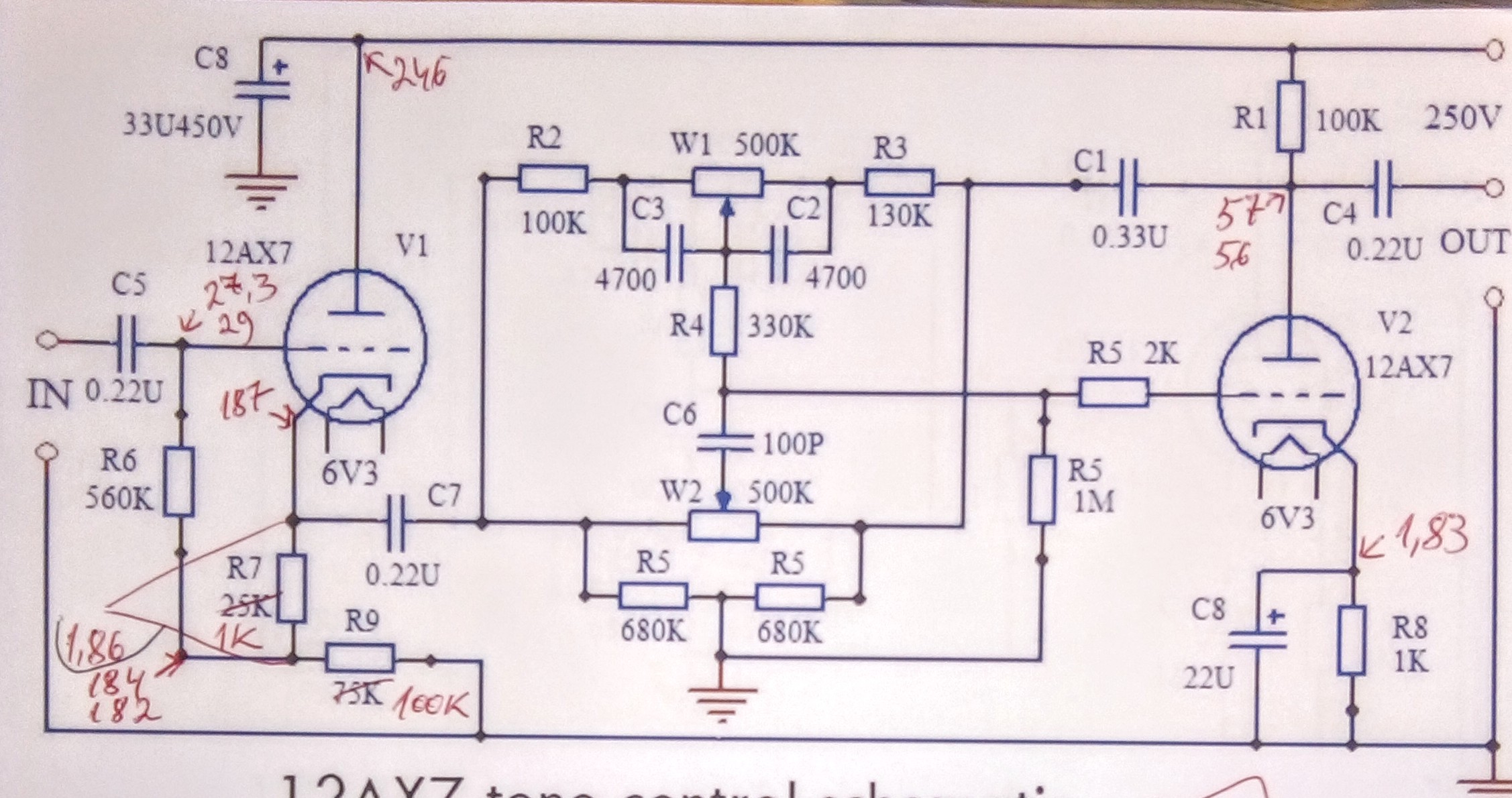

12AX7 tone corrector + EL84 SE
I got rid of the hum 🙂
I will use that type of cable, it will be a shirt length, 5cm or so.
What pot shall i put at the input of the preamp, before C5? Does it make a diffrence wether i use 50k log or 500k log? The input source is the laptop...
